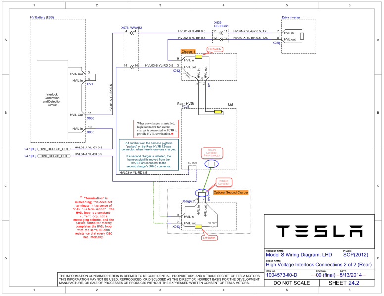

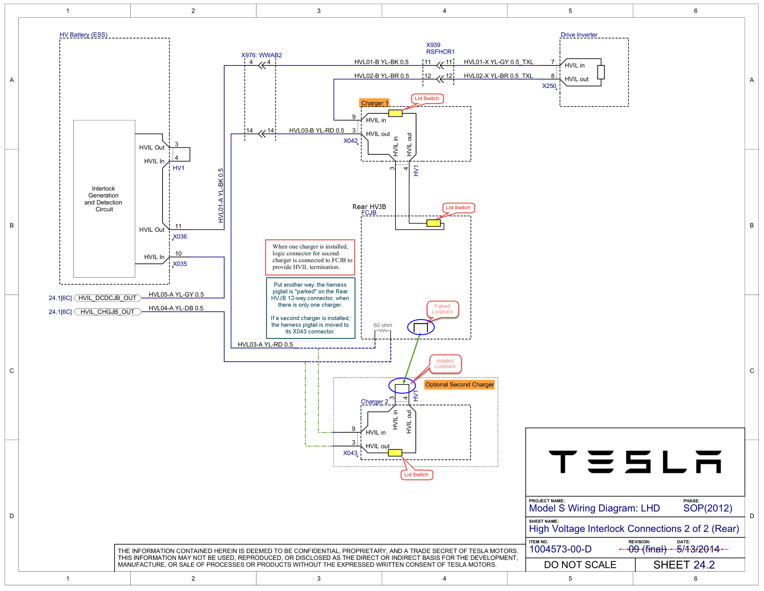

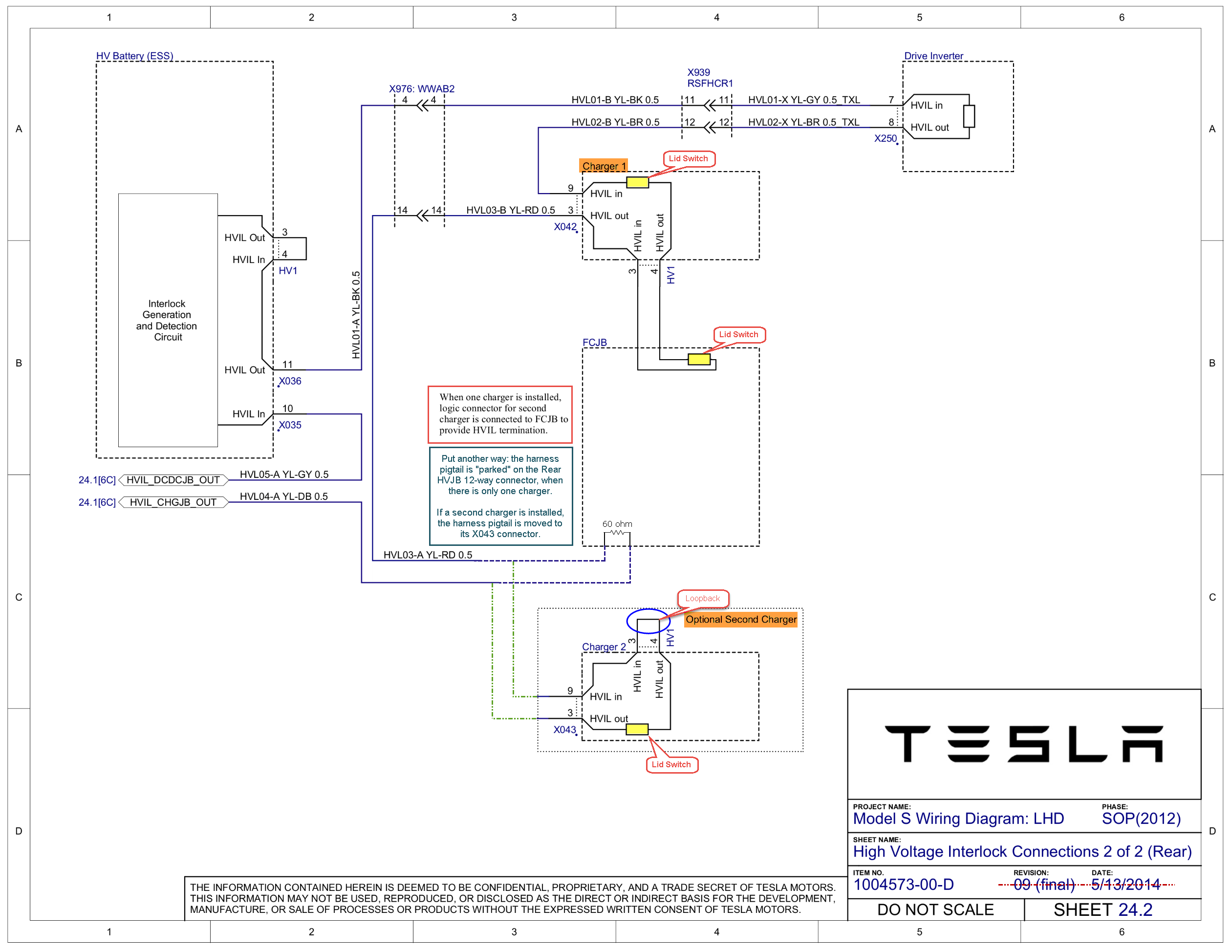

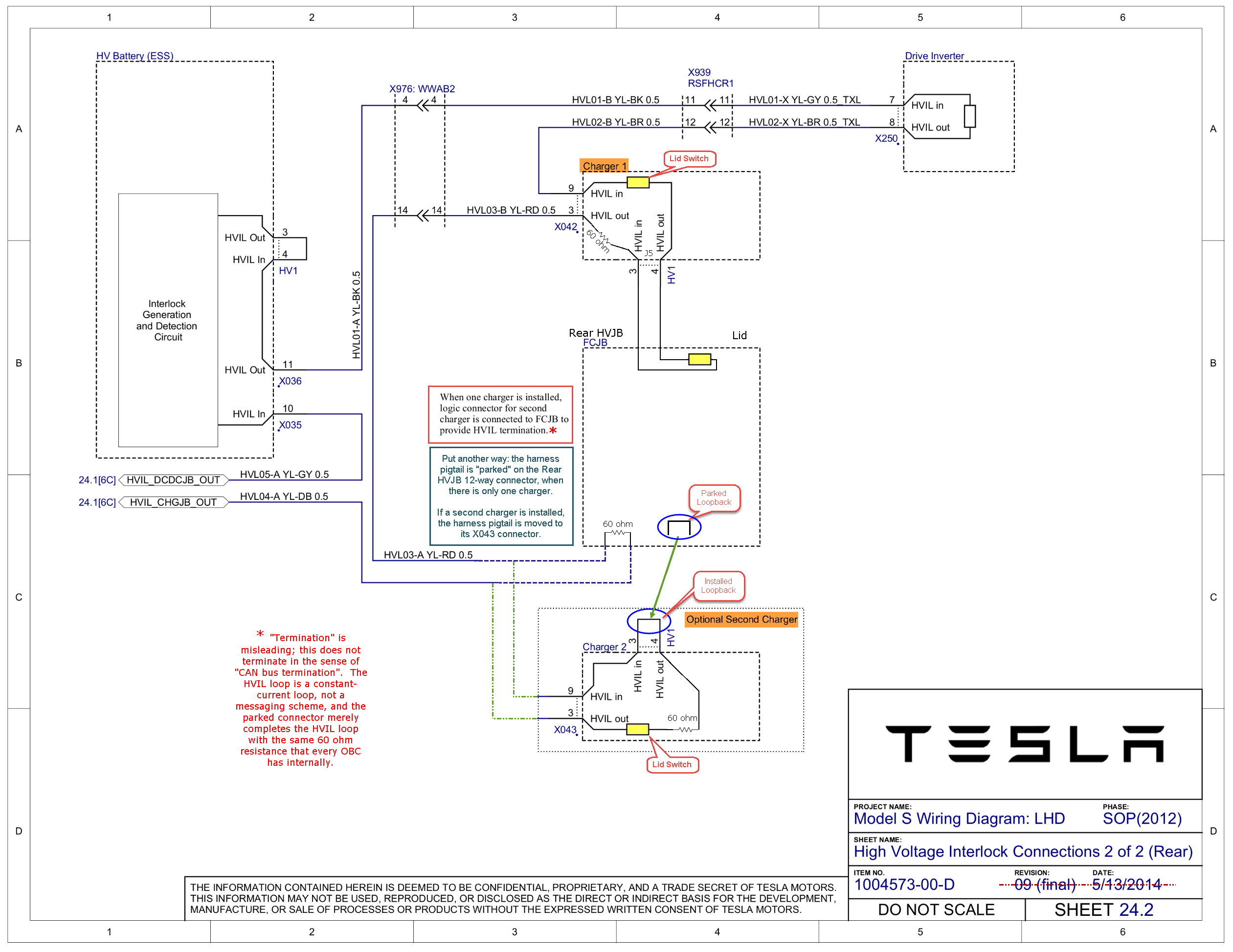

Telsa Model S GEN1 HVIL Schematic (amended), highlighting the 60 ohm "park" resistor.
current21:09, 23 July 2023Thumbnail for version as of 21:09, 23 July 20232,521 × 1,948 (451 KB)Asavage (talk | contribs)Clarified some language.
02:17, 23 March 2023Thumbnail for version as of 02:17, 23 March 20232,521 × 1,948 (450 KB)Asavage (talk | contribs)Updated "termination" being misleading, and added internal 60 ohm resistors to OBCs.
18:50, 22 March 2023Thumbnail for version as of 18:50, 22 March 20232,521 × 1,948 (441 KB)Asavage (talk | contribs)Added "J5" to Master OBC HVIL
18:35, 22 March 2023Thumbnail for version as of 18:35, 22 March 20232,521 × 1,948 (441 KB)Asavage (talk | contribs)Added "Rear HVJB" above FCJB
18:18, 22 March 2023Thumbnail for version as of 18:18, 22 March 20232,521 × 1,948 (441 KB)Asavage (talk | contribs)Added "parked loopback" infographic
17:28, 22 March 2023Thumbnail for version as of 17:28, 22 March 20232,521 × 1,948 (435 KB)Asavage (talk | contribs)
