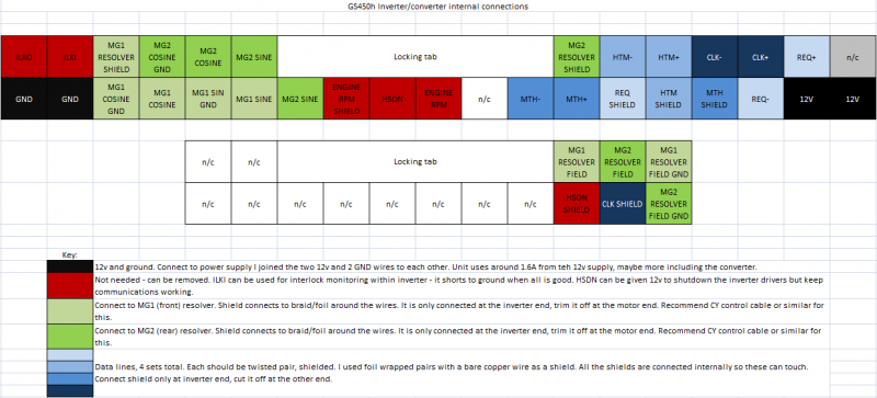

File:Inverter connections.png
Revision as of 15:31, 6 February 2020 by Xp677 (talk | contribs)
Original file (1,238 × 562 pixels, file size: 49 KB, MIME type: image/png)
GS450h internal inverter connections
