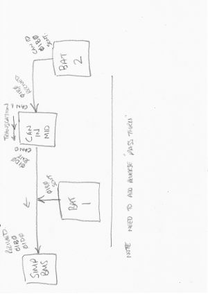

BMS
The BMS slaves on the modules can be re-used using SimpBMS running on a Teensy Microcontroller.
https://github.com/Tom-evnut/SimpBMS
https://github.com/Tom-evnut/VW-bms
Each half-module will need connecting to the can bus for SimpBMS, top right as you are looking at it is pin 1 - GND, move down and skip one pin to 3 - Enable (12V), move down again and skip one to pin 5 - 12v. Top left is pin 6 CAN HIGH, and the one under it is pin 7 CAN LOW.
The BMS has to send a CAN Frame with 0x0BA to request the module data.
| ID | Data |
| 0x0BA | 0x00 0x00 0x00 0x00 0x00 0x00 0x00 0x00 |
| 0x0BA | 0x45 0x01 0x28 0x00 0x00 0x00 0x00 0x30 |
With a little experimentation the 0x00 0x00 0x00 0x00 0x00 0x00 0x00 0x00 is not required to get the cell voltages, a message with just 0x00 0x00 0x00 0x00 0x00 0x00 0x00 0x10 seems to be sufficient. So it seems bit 4 of the 8th byte is a flag to send voltages.
The Modules will respond by sending out frames with the IDS 0x1CC to 0x1D4
There's a DBC file https://github.com/jamiejones85/DBC-files/blob/master/VW-GTE-HV-Battery.dbc for use with SavvyCan

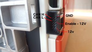

Battery Modules
Passat GTE
The Battery Module weighs 23.4 Kg, (Add module dimensions), There is a BMS connector (TE 1-1670990-1) on both sides of the the module.
Golf GTE
Each module consists of 2 rows of 12 cells, with a liquid cooling plate between then. Each block of 12 cells is 1086Wh, so each module is 2172Wh.
Roughly 240mm wide, 440mm in length and 150mm in height, each module weights []. One side has a mounting bracket close to the base, the other has one towards the top.

The e-Golf slave board has the same 10 pin connector, seen on the right, as the GTE but there is a further 10 pin connector (cell taps from the cell tap blocks) and an 8 pin connector (temperature sensors from the cell tap blocks) on the left.

Using Multiple Packs
Note: This section is very very rough draft!!and needs a lot more work!
Currently NO Turn Key solutions exist for using more than 1 pack, however .... The items below have NEVER been tested and could only be described as experimental !!
- The next release of SIMP BMS (assuming to be V3) shall use a teensy 4 which will have 3 canbuses however this is in the early stages of development.
- It could be possible to use 2 sets of SIMPBMS however they would exist on 2 separate can buses, this would not to be easy task to implement.
- It could be possible to translate the CAN id's from the second pack by using a can in the middle and still use a single SIMPBMS however this has never been tested.
The can id's outputted from the modules are fixed, the ranges used are from 01B0 to 01CE (432-462).
If these CAN id's were translated (from the second pack) using a can in the middle device to id's to a range like 01D0 to 01EE (464-494) a single SIMPBMS could be used as there is an undocumented code allowing for extended id's within the VW SIMPBMS code.
Sample can id modifying code can be found in colin kidders git hub for the arduino due
https://github.com/collin80/due_can/tree/master/examples/CAN_TrafficModifier
Damian McGuire has created a can in the middle device
https://github.com/damienmaguire/CAN-BUS-Man-In-The-Middle
BMS code showing extended id's
https://github.com/Tom-evnut/VW-bms/blob/master/VWBMSV2/BMSModuleManager.cpp
Rough Draft of CAN ID translation concept, important note the reverse path needs adding.
There is a can id that simp bms sends out (00BA) that wakes up the modules, this needs to be passed through as is.
