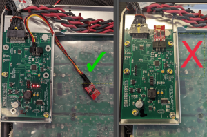

  • If you get any of: 1) incomplete responses via HTTP 2) patchy WiFi on a logic board 3) parameters from logic board not loading in web interface; you can try powering the ESP8266 from a different source, or connect it via DuPont leads to rule out connector & plug issues (see photographs).
    You can try different power sources or different leads when experiencing communication issues.
