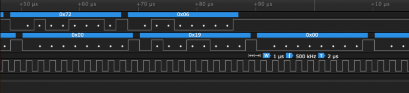

Original file (1,668 × 380 pixels, file size: 57 KB, MIME type: image/png)
Toyota Sync Serial Bit Pattern: Shows that the serial stream bytes are framed with Start and Stop bits. A standard serial port (with CAN transceiver) can be used to read the data in transit. No need to connect to CLK. Time between messages is ample for eliminating the REQ line also.
