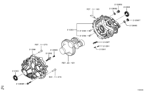

|Gearbox parts | |||
|shaft oil seal P/N 3515A056, gbx oil plug gasket P/N MF660036 | |||
|[[File:Mitsu RWD GBX.png|thumb|Mitsu RWD GBX exploaded view]] | |||
