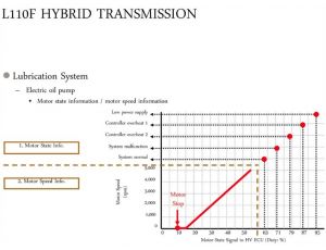

Oil Pump
Overview and location
As built, the GS450h supplies oil pressure to the gearbox using either the ICE engine or an electrically-driven external pump. With the input shaft locked in EV applications, the external pump is the only option available. As mentioned previously, this is a vital part of the setup and it's strongly recommended to buy a transmission that still has it fitted. To help with this, here is a reference photo of what to look for.
The Internal pump and pressure regulator provides a steady 7 Bar oil pressure.[6]
The recommended oil is Toyota ATF-WS, though people have had success with 3rd party equivalents.
Wiring and control
The external pump also requires a controller, which uses a PWM control scheme. Although this is rarely included with the transmission, it's quite affordably and widely available (Toyota part number: G1167-30020)
Pinouts, schematics and notes
- The metal case is the ground.
- Black (pin 6) is PWM in from your controller.
- Brown (pin 7) is PWM feedback from the oil pump. It is not required and can be left disconnected.
- The fat blue wire (pin 5) is 12V power. The oil pump uses around 50A Max. So plan for that. Add your own relay to stop it draining your battery while the car is off.
- The PWM for this is weird, it's not just 0-100. IIRC it is 0% at both ends, and rises to 100% near the middle, then back down again. This is just based on the sound of the pump with no load, so needs more testing to find the real values.
