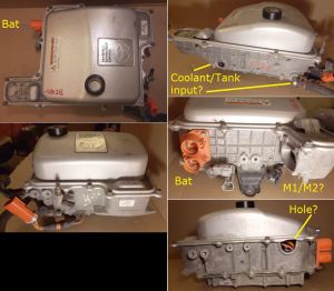

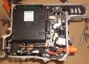

The Gen2 Prius (2004-2009 model years) has a variety of useful components inside the inverter package:
- 2 high power inverters, for the 2 motors MG1 (starter) capable of handling 250 amps, and MG2 (drive motor) capable of handling 350 amps.
- A DC-DC converter to provide 12v power supply to the automotive systems and accessories.
- A boost module to boost the 200v battery pack up to 500v, which looks to be able to function as a battery charger (wish list for future development)
- See this video for a thorough disassembly and explanation of the Gen2 Inverter (Timestamp 1:15:30): https://www.youtube.com/watch?v=Y7Vm-C4MsW8&t=4531

The control board utilizes the Blue Pill (link?) microcontroller, and takes advantage of the OpenInverter.org software (link?) for control. It is also connected from the outside via the main (32 pin white) OEM connecter - try to retrieve this connecter and part of wiring loom when sourcing your inverter. Picture of connecter further down in wiki.
The control board design incorporates the use of the existing inverter Current Sensors - if FOC option is to be used (Gen 2 Transaxle MG2), bandwidth should be a multiple of control loop frequency which is 8.8kHz. (link to how to modify original setup?)
Functionality of the existing resolver is intergrated as well.
Assembly notes? Blue Pill programming notes or just links to Blue Pill section?
Try to get all the wiring harness bits that plug into the inverter when you purchase it. Else, the 32-pin connector inside the inverter part number is: 1318747-1, and the pins to wire it are: 1123343-1

Additional Inverter / Converter details:
Inverter coolant enters at the front and exits the rear of the inverter housing from the o-ring port connected to the HSD cooling system reservoir.
The DC-DC charging connections on the Gen2 Prius Inverter are on the rear, they are "C5" (6 pin gray) & "C6" (1 large pin gray).
Here is what is needed for the Gen2 Inverter DC-DC to work...12v on pins #1 & #3, 5v on pin #4 of connector "C5" (gray one) and the case grounded. It is not required to have a load applied to the large gray 12v connector (C6) to obtain an output.
