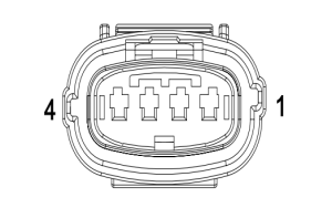

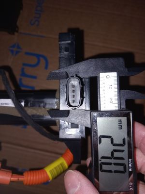

Low Voltage/Control | |||
Unidentified - see image | |||
Pinout | |||
[[File:MG PTC Connector.png|alt=MG PTC Connector Pinout|thumb|MG PTC Connector Pinout]] | |||
{| class="wikitable" | |||
!Pin | |||
!Cross Section | |||
!Colour | |||
!Function | |||
|2 | |||
|0.35 | |||
|Green/White | |||
|3 | |||
|0.35 | |||
|Pink/Black | |||
|LIN | |||
|4 | |||
|0.35 | |||
|Black | |||
|GND | |||
[[File:Mg ptc connector image.jpeg|alt=MG PTC Connector|thumb|MG PTC Connector]] |

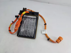

Overview
PTC Air heater assembly found in MG EVs (ZS, MG4, MG5).
Heater is controlled by LIN.
Part Numbers
MG Part Number | Vehicles Used it | Tested? |
10606761 | ZS | No |

Low Voltage/Control
Pinout
Pin | Cross Section | Colour | Function |
2 | 0.35 | Green/White | + |
3 | 0.35 | Pink/Black | LIN |
4 | 0.35 | Black | GND |
