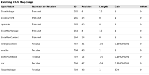

Integrating Foccci with your car/BMS
Depending on your use case Foccci has to communicate with one or more components in your car. All in-car communication happens via a single CAN bus.
Basic communication considerations
Foccci can be configured to run at various baud rates and defaults to 500k. The Wifi interface mentioned below is hard coded to 500k. So when configuring a different baud rate you will loose communication with the Wifi interface. This might be fixed in the future by allowing variable baud rates for the wifi interface. Bottom line: keep it at 500k.
Apart from that it is mostly sufficient if Foccci can communicate, or more precisely, listen to the BMS. Foccci uses the flexible CAN mapping known from other OI firmware. There are 5 key parameters that need to be received via CAN:
- ChargeCurrent: this is the single most important item. It is directly relayed to the charger and specifies the current the battery can accept at the given moment. This depends on battery voltage, temperature and other things to be determined by the BMS. Foccci itself does no battery monitoring of any kind, it is completely down to the BMS to specify a safe charge current. When this value is not updated for more than 2 seconds the charging session is terminated.
- BatteryVoltage: this item is important for precharging the CCS chargers output to the momentary battery voltage. Most BMSes output the total pack voltage in a CAN message
- TargetVoltage: In theory this is the maximum voltage you want the battery to be charged to. In practise the maximum battery voltage MUST be governed by specifying an appropriate ChargeCurrent. More importantly many chargers cut back charge power when approaching this voltage resulting in poor charging performance towards the top end. So in practise you want to set this to a voltage about 10V above charge end voltage of your battery.
- soc: This is purely informative as far as we know. It displays the batteries state of charge on the chargers display
- enable: this is optional as it defaults to always enabled. It can be used to completely terminate the charging session by setting it to 0.

Configuring Foccci via CAN
Foccci exposes only one single CAN interface for vehicle communication and initial configuration. So we need a CAN counterpart to talk to it.
There are two main approaches to this: a) use a command line tool [2] or b) use an ESP based CAN module [3]
Both ways require knowing Focccis so called Node Id (similar to an IP address on a local network). By default this is 22. You can enter this node id on the bottom left navigation bar.

Making Foccci talk CHAdeMO on the CAN side
A pretty straightforward way to integrate CCS charging into your vehicle is to use the existing CHAdeMO (let's call it CDM from here on) CAN messaging. CDM has pretty much all data items we need to initiate a CCS charging session, so rather than defining a new set of messages we might as well adopt it. For example, Orion BMS or Zombieverter VCU natively support CHAdeMO anyway.
Let's go over the items in the screenshot one by one. Note that the IDs are decimal! (256=0x100, 258=0x102, 264=0x108, 265=0x109)
- UdcDivider - Actually, here we just select some dummy item as the important bit is in the Offset field: the version. In this case I signal non-existent CDM version 10. This tells the CDM module in my car that it talks to Foccci. It then includes the battery voltage in some unused message bytes - see below.
- EvseVoltage - Transmits the charger's present output voltage back to the vehicle.
- EvseCurrent - Transmits the charger's present output current back to the vehicle.
- opmode - Observe the weird gain - this is forged to map Foccci state "CurrentDemand (13)" to CDM state "ConnectorLocked (4)". In my car's CDM module this is sufficient to initiate the charging progress. You may need to change it so that the ChargeEnable flag together with ConnectorLocked is forged (numerical value 5).
- EvseMaxVoltage - Transmits the EVSE's maximum output voltage back to the vehicle.
- EvseMaxCurrent - Transmits the EVSE's maximum output current back to the vehicle.
- BatteryVoltage - Transmits the present battery voltage to the EVSE. This is the special item that normally doesn't exist in CDM and that unfortunately will prevent you from using this solution with an OEM car in a safe manner. Of course, you could manually set this to some medium battery voltage like 360V, but if you arrive with a really low battery at, say, 300V this might weld your charge port contactors. You could also manually enter the battery voltage before each charging session.
- TargetVoltage - Transmits the charge end voltage to the EVSE.
- ChargeCurrent - By far the most important data item: the charge current request.
- soc - In CDM this isn't normally a percentage value but some encoded kWh value. In my car's CDM module I specify a full battery as "200" (no idea what this actually means in kWh) and thereby can just output the SoC in 0.5% steps.
- enable - The car's charge enable flag. When 0 will stop the CCS session.
As an additional safety measure you could connect CDM pin 4 (charge enable) to Foccci's button input (at least once we added an active low mode for it). It might also be worthwhile to connect pin 7 (connection check) to the PP input for drive away protection when CDM is plugged in but not charging (again, once we have actually implemented this).
