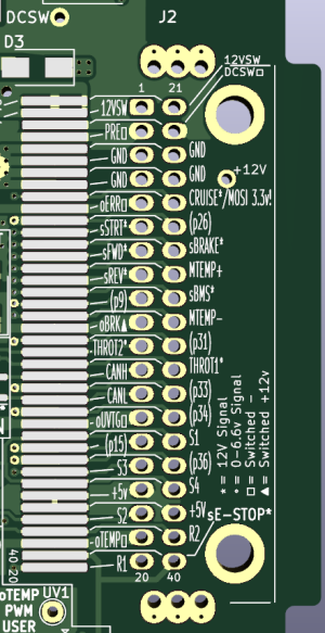

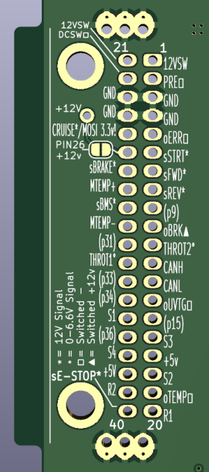

The adapter board is labeled at the 40 position connector to help with wiring up the inverter / harness. Images of these are to the right and a table is below with the positions in order.
The surface mount version of this connector starts with position 21, then 1, 22, 2, etc. The position labeling on the pc board is offset slightly on both sides to help with this.
The pc board renderings / pin labeling images to the right can be used to help populate the connector and wire the vehicle.
Pos. | Abbreviation | Description | AKA | Details | Pos. | Abbreviation | Description | AKA | Details | |
1 | +12VSW | Switched +12v | 21 | +12VSW | Switched +12v | |||||
2 | PRE□ | Precharge contactor switched ground | 4.5 ampterminal limit?
recommended to use an economizer |
22 | DCSW□ | EV battery contactor switched ground | 4.5 ampterminal limit?
recommended to use an economizer | |||
3 | GND | Ground | 23 | GND | Ground | |||||
4 | GND | Ground | 24 | GND | Ground | |||||
5 | oERR□ | Output - Error signal, switched ground | 1 amp | 25 | CRUISE*/MOSI3.3v! | Cruise control signal 12v / MOSI 3.3v | 12v set as cruise. 3.3v as MOSI | |||
6 | sSTRT* | Input, 12v start signal pulse | 26 | empty / optional +12v | empty - optional +12v for E-Stop switch | See p26 +12V solder jumper notes. | ||||
7 | sFWD* | Input, 12v forward | 27 | sBRAKE* | Brake light input 12v | |||||
8 | sREV* | Input, 12v reverse | 28 | MTEMP+ | Motor temp senor + | |||||
9 | +3.3V | +3.3V from U2 regulator. | Alternative voltage for analog throttles if 5v goes out of range. | 29 | sBMS* | Battery Management System error +12 signal | ||||
10 | oBRK▲ | Output, brake +12v (see SJ4) | 1.5 amps | 30 | MTEMP- | Motor temp sensor - | ||||
11 | THROT2° | Throttle 2, 0-5v signal | 5K pull down to gnd on mini mainboard to shift to 0-3.3v. | 31 | empty | empty | ||||
12 | CANH | CAN high signal (see SJH1) | 120 ohm termination resistor solder jumpers | 32 | THROT1° | Throttle 1, 0-5v signal | 5K pull down to gnd on mini mainboard to shift to 0-3.3v. | |||
13 | CANL | CAN low signal (see SJL1) | 120 ohm termination resistor solder jumpers | 33 | empty | empty | ||||
14 | oUVTG□ | optional output? 1amp max switched ground | 1 amp | 34 | empty | empty | ||||
15 | empty | empty | 35 | S1 | Encoder S1 wire | |||||
16 | S3 | Encoder S3 wire | 36 | empty | empty | |||||
17 | +5V | +5V for sensors (like throttle) | 37 | S4 | Encoder S4 wire | |||||
18 | S2 | Encoder S2 wire | 38 | +5V | +5V for sensors (like throttle) | |||||
19 | oTEMP□ | over temp signal, switched ground, 1 amp max | 1 amp, has EMI filter capacitor (C11) for PWM | 39 | R2 | Encoder R2 wire | ||||
20 | R1 | Encoder R1 wire | 40 | sE-STOP | Optional Emergency stop switch (see SJ5) | Can add an E-Stop switch to 12v. |
KEY |
* = 12v Signal |
° - 0-6.6v Signal |
□ = Switched ground |
▲ = Switched +12v |
