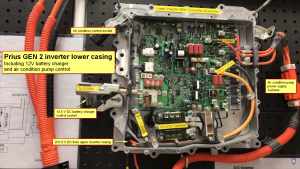

The Gen2 Prius (2004-2009 model years) has a variety of useful components inside the inverter package:
- 2 high power inverters, for the 2 motors MG1 (starter) capable of handling 250 amps, and MG2 (drive motor) capable of handling 350 amps.
- A DC-DC converter to provide 12v and up to 100amps power supply to the automotive systems and accessories.
- A tertiary power inverter to run the A/C, CAN controlled via the "BEAN" (????) network
- A boost module to boost the 200v battery pack up to 500v, which looks to be able to function as a battery charger (wish list for future development)
- See this video for a thorough disassembly and explanation of the Gen2 Inverter (Timestamp 1:15:30): https://www.youtube.com/watch?v=Y7Vm-C4MsW8&t=4531
- See this video for a more brief explanation of the above noted disassembled Gen2 HV System Operation: https://www.youtube.com/watch?v=UxuqHcUbSQ0
Note that there is also a Toyota_Prius_Gen3_Board for the 2010-2015 model years.

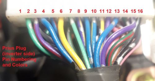

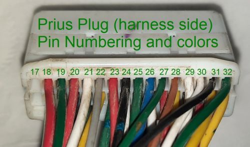

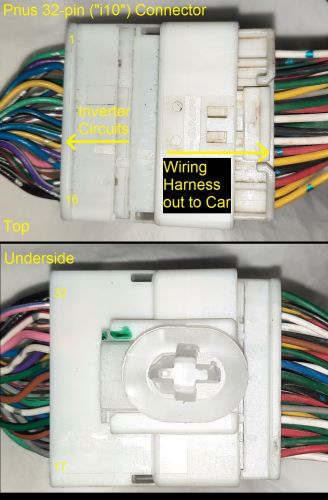

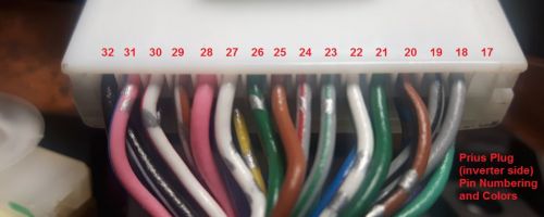

32-pin Prius Inverter Pin mapping

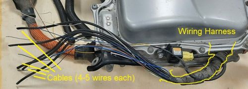

Note: Wire colors on the male/female side of the 32-pin "i10" connector do not match. The inverter-side plug uses an almost unique color scheme, but the wiring harness side reuses many colors - unique only to a given shielded cable (of which there are 5), plus some extra unbundled wires. To save time chasing wires, you can find anything in the same bundle, and know the rest by noting which other colors are in that cable. There are also a few loose wires not bundled into a cable or shielded.

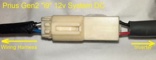

Note 2: The 12v supply rail for the "i9" connector also changes color at the wiring harness. The thicker blue loose wire is positive, the thick loose white-black wire is the ground.
Note 3: There is also an enclosure safety connector, this is the thin blue loose wire on the wiring harness.
Pin # | Designation | Description | Wire Color
(Inverter Side) (See pictures to the right) |
Wire Color
(Harness Side) |
1 | vacant | |||
2 | GIVA | MG1 Phase Current V | LightGreen | White - Cable 1 |
3 | GIVB | MG1 Phase Current V | Purple-Red | Black - Cable 1 |
4 | GUU | MG1 PWM U - Speed Signal Wave | Blue | Black - Cable 2 |
5 | GVU | MG1 PWM V - Speed Signal Wave | Blue-Red | Green - Cable 2 |
6 | GWU | MG1 PWM W - Speed Signal Wave | Yellow | Yellow - Cable 2 |
7 | MIVA | MG2 Phase Current V | LightGreen-Black | Green - Cable 3 |
8 | MIVB | MG2 Phase Current V | Purple-Yellow | White - Cable 3 |
9 | MUU | MG2 PWM U - Speed Signal Wave | Blue-Black | Black - Cable 4 |
10 | MVU | MG2 PWM V - Speed Signal Wave | Blue-Yellow | White - Cable 4 |
11 | MWU | MG2 PWM W - Speed Signal Wave | Yellow-Black | Red - Cable 4 |
12 | VH | Inverter Capacitor Voltage | Purple | Yellow - Cable 3 |
13 | CPWM | Boost converter PWM switch signal | Blue | Black - Cable 5 |
14 | CT | Boost converter temperature sensor | Green-Red | Red - Cable 5 |
15 | VL | Boost converter input voltage | Purple-White | Yellow - Cable 5 |
16 | GINV | Inverter Ground | Black-White | Yellow - Cable 4 |
17 | vacant | |||
18 | GIWA | MG1 Phase Current W | Grey | Red - Cable 1 |
19 | GIWB | MG1 Phase Current W | Grey-Black | Green - Cable 1 |
20 | GSDN | MG1 Shutdown | Brown-Black | Red - Cable 2 |
21 | GIVT | MG1 Inverter Temperature | Green-Black | White - Cable 2 |
22 | GFIV | MG1 Inverter Fail | White-Grey | Grey |
23 | MIWA | MG2 Phase Current W | Grey-Green | Red - Cable 3 |
24 | MIWB | MG2 Phase Current W | Grey-Red | Black - Cable 3 |
25 | MSDN | MG2 Shutdown | Brown | Green - Cable 3 |
26 | MIVT | MG2 Inverter Temperature | Green | Light Blue - Cable 4 |
27 | MFIV | MG2 Inverter Fail | White | Green |
28 | OVH | Overvoltage | Pink | Brown |
29 | CSDN | Boost converter shutdown signal | Brown-White | White - Cable 5 |
30 | FCV | Boost converter fail signal | White-Red | White |
31 | OVL | Boost converter over voltage signal | Pink-Blue | Black |
32 | GCNV | Boost converter ground | Black-Red | Green - Cable 5 |
