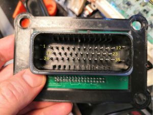

Solder the Ampseal socket to the the breakout board, the silk-screen indicates side and orientation fitment.
Next flip it over and solder the 34 way IDC locking header on, notch upwards as show.
Note: Some versions of the breakout board have and error in the silk-screen that indicate orientation incorrectly, with the notch towards the bottom.

Ampseal Socket & Plug
There are multiple part numbers for the large 35 way Ampseal through hole socket, with small mating differences, be sure to get a matching pair.
TE connectivity 776164-1 and 776163-1 are a matched pair[3].
The AMPSeal connector is wired as follows:
| Pin Number | AMPSeal Pinout Label | Description |
| 1 | 12V SUPPLY POSITIVE | Provide with +12V supply from battery or power supply for testing |
| 2 | GROUND | Common ground for 12V supply or 5V return |
| 3 | FORWARD DIRECTION SIGNAL | Active high signal at 12V (switches at >7V) to tell the inverter which way to spin the motor. Take positive feed from 12V battery or supply and wire through a three position switch, with the switched connections running to forward and reverse. |
| 4 | REVERSE DIRECTION SIGNAL | Active high signal at 12V (switches at >7V) to tell the inverter which way to spin the motor. Take positive feed from 12V battery or supply and wire through a three position switch, with the switched connections running to forward and reverse. |
| 5 | START SIGNAL | Active high signal at 12V (switches at >7V) to start the inverter and move it from pre-charge to run mode. Typically connected to the momentary 'START' position of your ignition switch. |
| 6 | BRAKE DIGITAL SIGNAL | Active high signal at 12V (switches at >7V) to inform the inverter that the car is under braking. Typically takes a feed from the brake switch that also turns on brake lights etc. |
| 7 | CRUISE CONTROL SIGNAL | Active high signal at 12V (switches at >7V) to turn on cruise control mode. This sets the current motor speed as the set point for cruise control. Cruise control is disabled by a signal from the brake switch. |
| 8 | 5V OUT | +5V supply for temperature and throttle sensors |
| 9 | ACCELERATOR CHAN 1 INPUT | 5V analogue input from first channel of throttle sensor. These typically take a 5V supply and ground and return to this pin a variable voltage that indicates throttle position. |
| 10 | ACCELERATOR CHAN 2 INPUT | 5V analogue input from second channel of throttle sensor. These typically take a 5V supply and ground and return to this pin a variable voltage that indicates throttle position. |
| 11 | GROUND | Common ground for 12V supply or 5V return. |
| 12 | INVERTER CAN HIGH | CANBus digital communication connection for remote interface with inverter |
| 13 | INVERTER CAN LOW | CANBus digital communication connection for remote interface with inverter |
| 14 | +5V OUT | +5V supply for temperature and throttle sensors |
| 15 | ENCODER CHAN A | Can be either digital input for encoder (in which case, connect the relevant encoder output here and provide the device with 5V and ground), or one of the two connections for the SIN winding if you are using a resolver for motor position. |
| 16 | ENCODER CHAN B | Can be either digital input for encoder (in which case, connect the relevant encoder output here and provide the device with 5V and ground), or one of the two connections for the COS winding if you are using a resolver for motor position. |
| 17 | GROUND | Common ground for 12V supply or 5V return |
| 18 | RESOLVER SIN | Connect SIN winding of motor resolver here and to Encoder Channel A |
| 19 | RESOLVER COS | Connect COS winding of motor resolver here and to Encoder Channel B |
| 20 | RESOLVER EXC | Connect exciter winding of motor resolver here and to ground |
| 21 | GROUND | Common ground for 12V supply or 5V return |
| 22 | MOTOR TEMP SENSOR T1 | 5V output for the motor temperature sensor. These are typically variable resistance devices. Connect one side of the sensor here. |
| 23 | MOTOR TEMP SENSOR T2 | Input from motor temperature sensor. Connect the other side of the sensor here. (Note the board correction above. Do not connect if it hasn't been addressed by a new revision or work around) |
| 24 | MAIN HV CONTACTOR | Open Collector (Will switch the ground side from disconnected to ground).
Connect one side of the contactor coil to +12v and the other to this pin. Your contactor will need either a built in economiser or additional circuit. MAX 5 amp. |
| 25 | HV PRECHARGE RELAY | Open Collector (Will switch the ground side from disconnected to ground).
| 26 | CHARGER AC INPUT RELAY | Open Collector (Will switch the ground side from disconnected to ground).
| 27 | CHARGER HV DC REQUEST | |
| 28 | CHARGER AC PRECHARGE RELAY | Open Collector (Will switch the ground side from disconnected to ground).
| 29 | GROUND | Common ground for 12V supply or 5V return |
| 30 | EVSE PROXIMITY SIGNAL | |
| 31 | EVSE CONTROL PILOT SIGNAL | |
| 32 | CHARGER CAN HIGH | CANBus digital communication connection for remote interface with charger |
| 33 | CHARGER CAN LOW | CANBus digital communication connection for remote interface with charger |
| 34 | NOT USED | |
| 35 | NOT USED |
Connecting Resolver
For resolver connect EXC to one side of the exciter winding and other to Ground.
Connect one side of SIN winding to SIN and other to Encoder A
Conenct one side of COS winding to COS and other to encoder B.
Inverter as charger
The buck/boost module in the inverter can be used to step up or down an input voltage to charge the high voltage battery in the car. Stepping down to a lower voltage is buck and up is boost converting.
Buck Mode Charging.
This is what you need if your battery voltage will be lower than the rectified input (< 340v for 240v single phase, 600v for 3 phase)
There's some firmware for the Atmega on the EVBMW board to control the buck/boost in buck mode for charging.
https://github.com/celeron55/prius3charger_buck
Once you've downloaded the code there's some things to change.
#define BATTERY_CHARGE_VOLTAGE 300 //Set this to your battery full voltage
#define AC_PRECHARGE_MINIMUM_VOLTAGE 550 // European 3-phase rectifies to 600V, Single Phase 240v rectifies to 340V
#define PRECHARGE_BOOST_ENABLED true. // The capacitor needs pre-charging, there's 2 options, a pre-charge resistor on the A.C input or use the battery to boost to the input voltage.
#define PRECHARGE_BOOST_VOLTAGE 550 // European 3-phase rectifies to 600V, Single Phase 240v rectifies to 340V
The battery connection needs to be a little different. The battery + will need connecting to the left most terminal and a contactor will be needed to bridge the left most and right most when running.
