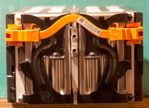

Battery Modules
Passat GTE
The Battery Module weighs 23.4 Kg, (Add module dimensions), There is a BMS connector (TE 1-1670990-1) on both sides of the the module.
Golf GTE
Each module consists of 2 rows of 12 cells, with a liquid cooling plate between then. Each block of 12 cells is 1086Wh, so each module is 2172Wh.
Roughly 240mm wide, 440mm in length and 150mm in height, each module weights []. One side has a mounting bracket close to the base, the other has one towards the top.
E-Golf
Part 1
Part 2
The e-Golf slave board has the same 10 pin connector, seen on the right, as the GTE but there is a further 10 pin connector (cell taps from the cell tap blocks) and an 8 pin connector (temperature sensors from the cell tap blocks) on the left.
Cooling
The Battery Cells are cooled by a liquid cold plate in the middle of the module, the outside diameter of the metal pipe connector is 8.0mm
