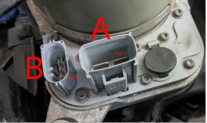

Electrical Connection
Input signals, start and stop conditions described in S40 service manual[2]
The harness for the motor supply can be bought completely (Volvo Part Number: 30775461 [3]) or just the connector. There is connector kits available online (avoid the pig-tail version as the cable is way undersized. Link)
Connector A (Power)[4]
| Pin Number | Cable Color | Function | Comment |
| 1 | Red | Permanent +12V for Motor | Fused with 80A fuse (F2) |
| 2 | Black | GND |
| Part | Part Number | Comment |
| Housing | 31266849[5] | Not verified, possibly different plug? |
| Housing | 30728420[6] | Not verified |
| Housing | 7283-2918-10[7] | Also in black, P/N 7283-2918-30 |
| Terminals | 7116-3250[8] | For 8mm2 wire |
| Wire Seals | 7158-3610-80[9] | For 8mm2 wire |
Note: Some later Volvo models use a similar variant of this pump which has a different shaped (smooth housing body) Connector A. Not known if the CAN protocol is different.
Connector B (Control)[4]
| 1 | Grey-Blue | Ignition +12V for Control | Fused with 10A fuse (F53). |
| 2 | CAN-L | ||
| 3 | CAN-H |
A visual guide of the pinout can be found on this MaxxECU online help page
| Connector | 31346135[10] | Not verified |
| Housing | 7283-8730-30[11] | |
| Terminals | 7116-1680-02[12] | |
| Wire Seals | 7157-3951-60[13] |
At least some pumps use a different control connector:
| Housing | 7283-8977-30 | |
| Terminals | 2.8x0.8 female | see ref[14] |
| Wire Seals | see ref[14] |
