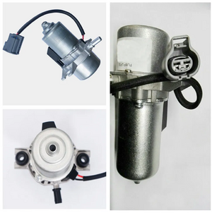

Last time with Mazda i used Hella UP28, SC-VP-Hella-UP28-Vacuum-Pump-Technical-Information auxilliary vacuum pump a lot of cars use to assisst with brake servo. It was not meant to be in permanent operation, it needs a vacuum switch and check valve. Also Peugeot 406 has larger brake cylinder bellows that pump must evacuate.

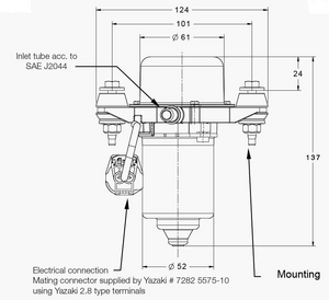

I decided to get a larger Hella UP30 vacuum pump. It is fully capable to assist Pug cylinder and provides powered braking 3 times before evacuating.

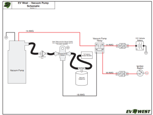

I used 30A relay to trigger pump operation according to this schematic.

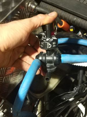

I installed Volvo XC90 switch P/N 30645383 or 31400608.

One line goes to GND and the other one connects to the relay which is powered by fused 12V on the other side.
It has 3 ports. Each port has its own non-return valve. Two ports (1, 2 from leftmost going CCW) were setup for underpressure flow and one (3) is setup for overpressure flow. This lets me connect the hose directly to 1 and 3 with one port (2) in the air.
You can see the 1 port is connected to the pump with 3 port going to the cylinder booster.
For the hose i used blue gas hose since it has double sleeves.
Volvo vacuum switch is definitely worth using. Not only it has a good reliable sensor it also has one way valves built in. Essentially it is a plug and play item. I highly recommend it.
