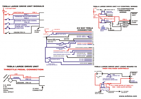

Connections
Overview
LDU connection diagram
HV wiring with precharge and main contactors

Contactors
Please note that the contactors you purchase *may* have polarity associated with them for the low voltage control signal. If you have problems related to the pre-charge circuit working, or contactors behaving as not expected, check this!

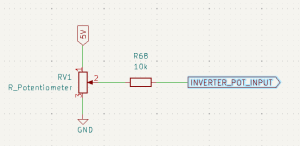

Throttle Wiring
The Tesla LDU drop in board uses a range of 0-3.3V for the throttle input, however many OEM throttle pedals use a range of 0-5V. This can work, however it presents an issue in the event of a broken throttle pedal. A fix has been implemented in the firmware as of June 2024, which requires a 10k resistor placed in line on the throttle signal. Read more in this thread.

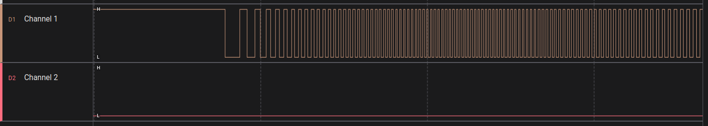

To check the encoder signals you should have either a logic analyzer or an oscilloscope. Both come in a wide range of prices. The encoder signal is not particularly fast, especially when the motor is not spinning that fast. As such, even cheap test equipment can be adequate. You may find that there is no particularly good place to connect to in order to read the encoder signals. But, there does exist a reasonable place - right at the 20 pin connector on the LDU board where the 23 pin external connector's wires are routed. If your logic analyzer or oscilloscope has little grabber adapters you can do something like in this picture:

So, in the picture, channel 0 is connected to encoder 5v (to monitor that voltage is properly there), channel 1 is connected to the A channel of the encoder, channel 2 is connected to the B encoder channel, and scope ground is connected to the encoder ground wire. This allows for monitoring all of the relevant signals. But, keep in mind not to short any pins while doing this. Very fine probes will be needed and extreme caution not to clip two pins together. The clips/grabbers in this picture are from a Saleae Logic Pro 8. This is *NOT* your cheapest option for monitoring encoder signals but does work very well. It also doubles as a 50Mhz oscilloscope which can be handy. Cheaper options (including knock offs of Saleae Logic) do exist.
Here is a picture of what it may look like when one encoder signal is missing:
Note how Channel 1 shows an encoder signal but Channel 2 looks completely flat. This should not occur. If one is showing a signal, so should the other.
