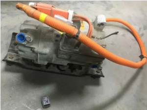

Gen 1 Unit (Denso ES34C)
Power Draw
As per: https://www.diyelectriccar.com/threads/tesla-a-c-compressor-questions.189978/post-1061852
Current draw at maximum load is in the neighbourhood of 12 amps @ 360V, so somewhere around 4.5kW draw.

As mentioned above, the Denso ES34C can be controlled using a PWM signal.
As per: https://www.evcreate.nl/using-tesla-thermal-management-system-parts/#tesla-ac-compressor
Connect 12V + in to pin 7 and provide chassis ground to pin 1. Pin 4 and 8 are not connected (don’t even have a male terminal in the compressor connector). You can leave the power feedback (pin 5) and diagnostics (pin 3) unconnected too.
The compressor is enabled by grouding pin 2 (active low) and speed control via a PWM signal on pin 6.
As per: https://www.diyelectriccar.com/threads/tesla-a-c-compressor-questions.189978/post-1029299
Success! I got the ES34C running. It is very easy to control and very tolerant of input conditions. It takes a PWM signal anywhere from 35 to 400 hz. Control range is from 5% (max speed) to 85% (min speed) duty cycle.
I supplied 12V to Pin 7 (VIgn), Grounded pins 1 (Gnd) and 2 (On/Off), and left pins 3 (Diag) and 5 (Power (FB)) unconnected. The 12V PWM signal was input to pin 6 (PWMin).
