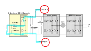

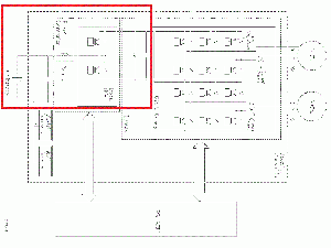

A schematic of the buck/boost converter and the inverter is below, with the converter boxed in red.
If the inverter stage were to be bypassed, as shown in blue, the boosted battery voltage could match that output from a CCS charger and in theory at least allow for a sub 200V pack to be charged.
Buck boost for CCS
A man-in-the-middle board will interface with the car's BMS and accept the low-voltage charging requirements and restrictions, and translate these into high voltage requirements and restrictions and pass this onto whatever CCS controller we end up using. The BMS will never 'know' it's taking in high voltage as it will only see the pack voltage levels that the buck/booster reduces the EVSE level to, and the EVSE will not 'know' its charging a sub 200V pack, since it sees c. 400V and is instructed to provide said volage by the CCS controller. I hope to use FOCCCI and CLARA for the CCS controller and at present the MITM board for controlling pre-charging and the buck/boost controller is a simple Teensy 4.1.

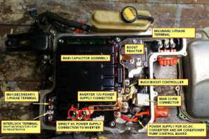

The buck/boost converter’s Intelligent Power Module is a Mitsubishi PM400DV1A400. It has an 16 pin input plug P/N: 1318386-1, crimps 1123343-1 from TE. These plugs are pretty small and necessitate a thin wire gauge (c. 20-23 AWG at a guess).
Pin numbering and colouring can be found in the Toyota wiring guide, p106 [find a link] and these connect into the 32 pin Prius Inverter plug as show in the wiki Prius Gen 2 Wiki with the exception of the modules power, ground and OVH wire (more on that below).
Block diagram from Toyota for the Mitsubishi IPM
Block diagram shown.
The pin numbering is shown below. Pin numbers start with pin 1 at the top, right side of the TE plug when looking at the wire entry side. So the red 12V power input is pin 8, and the orange voltage sense wire is pin 1.

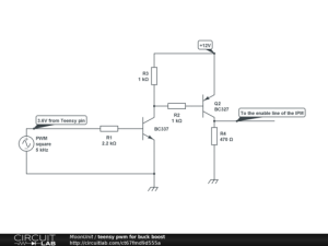

It's important that the CPMW is set to zero when starting and to ensure this, I used a very simple circuit with two transistors as shown, because during the boot/power on of the Teensy the output pin is floating until it's explicity set low, and this circuit makes sure that CPWM is set low from the beginning. To stop, remove 5V from OVH and open contactors to battery to remove input DC. There is a bleed resistor board in the inverter which will drain the voltage on the capacitor but take care none the less. It may be wise to reduce the boosting to zero before setting OVH low, I don't know.
Keeping PWM low during boot

Possible CCS take off points circled in red
The idea is to boost the battery voltage to the output voltage of the charger, then allow the charger to connect to either the DC bus rails circled below in red in picture labelled 'possible CCS take-off' (but confirmation needed on this), OR, to two of the MG1 terminals. The latter does mean that the current will flow through the diodes on the inverter circuit, and this may not be desirable because a) it might limit the current that can be drawn and b) it means keeping the inverter circuitry even though we don't use it for this application and could perhaps discard it to save space. Either way, once the voltages are matched, the charger can be allowed to connect to the DC bus rails (in theory without its own pre-charge circuitry but that might not be wise). Assuming the charger voltage and the boosted pack voltage are the same, no current will flow. By reducing the boosting by reducing the PWM duty cycle, current can be drawn towards the pack. The pack will see the bucked down voltage level and by controlling the amount of boosting the amount of current can also be controlled.
Note: the above is conceptual and I have been successful using very low voltages to test charging a 12V battery from an 18V battery. Scaling this up to charging a 120V battery from a 400V EVSE is a different kettle of fish altogether, and I could use some help from the community to confirm where best to connect the EVSE HV to (see blue lines on Buck/Boost for CCS schematic above) and general advice regarding safety and best practice.

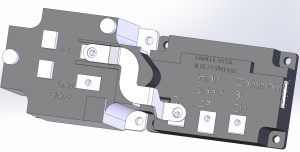

See image:
Prius Gen 2 IGBT and Inductor
  • The inductor is the low side +.
  • Inductor connection to the IGBT is CL.
  • CP is the high side +
  • CN is the common - for the high and low sides. Do not connect to chassis ground, for high voltage & low voltage -.
This converter shares the - between the high and low sides.
The Orange wire from the IGBT seems to be for voltage level sensing for the IGBT. I believe this needs to see 8v? or more to startup so may need to be moved to the low voltage / inductor side + if that's where the voltage is at startup. Seems to be no need to connect this wire to a low voltage controller.
The IPM and CSDN lines can be setup with a 12v pull up 470R then an N mosfet pulls it to ground. A gate pull up resistor of 47k to + voltage means the n mosfet is on and pulls the line low on startup until the gate is pulled low by the mcu. A gate pull down resistor of 47k Means the mosfet stays off, line stays high until voltage rises on the gate by the mcu. If both are set to tri-stated the converter should shut down on its own with this hardware without a turn off spike. Its possible FCV voltage could be used for these signals but needs testing. FCV still has good voltage a little while after the igbt shuts down.
