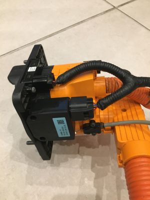

Hyundai Ioniq CCS Charge Inlet 91684-G7010

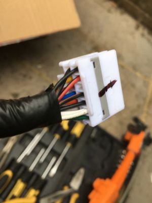

Backshell showing LED connector at top and actuator middle

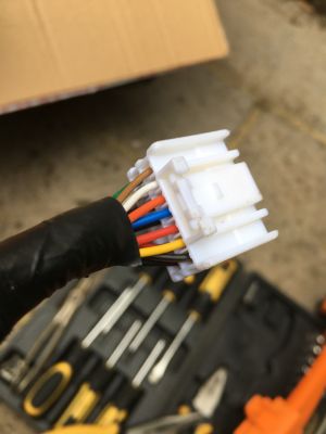

Shows 2.7K resistor block on right hand side of inlet, LED connector on top

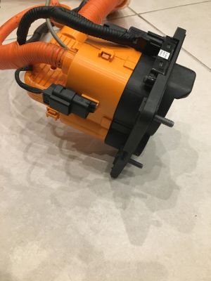

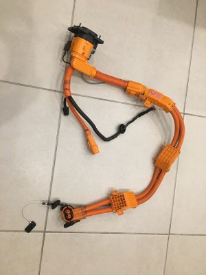

The Hyundai Ioniq AE CCS Charge Inlet part number 91864-G7010 combines a Type 2 charge port (single phase) with a CCS2 DC inlet. The full part is shown below with approx. 2M of shielded DC cable, a TE AMP+ connector for the Hyundai battery pack, connector to onboard charger and 14-way plug presumably connecting to the car's charge controller. There are orange plastic 'pass through' mouldings that mount and route the HV DC cables which can be removed, and a cable release for manually releasing the charge port lock pin if it gets stuck in the inlet.
Full cable assembly with charge inlet, battery connector, OBC connector

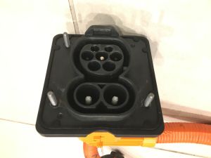

CCS inlet. Charge port LED shown at top
The charge port inlet has a two part backshell, with DC HV cables exiting via a right angle backshell. These are fairly easily removed but the plastic tabs are weak. The charge port lock actuator screws to the left side of the charge port and a manual wire pull release attaches to it to pull the locking pin back out if required.
The actuator requires 12V across orange and blue wires, reversed to change the actuator direction. The other two wires (red and yellow) from the actuator are a feedback mechanism. If the lock is powered closed (ie pin fully extended), 1K is then measured across red and yellow.
An LED is mounted in the top of the port, above the AC input.
On the right hand side is a resistor block containing a 2.7K resistor between PE and PP.
Wire side of 14 way connector, top side. Pin 1 top right: brown-black, pin 8 below it: black.
Bottom view of 14 way connector. Bottom row starts at pin 8, black, at the top

The 14 way connector pinout is described below. Pin numbering starts at the top right pin when looking from the wire side of the plug, and is black/brown. Pin 8 starts on right hand side of bottom row, black.
Pinout:
Pin Colour Description
1 black/brown Shielding of CP/PP pair, also connected to pin 11 and PE earth (pin 12), and shielding of AC cable
2 yellow Actuator lock feedback, 1K resistance appears across pins 2 and 3 when lock is powered closed.
3 red Actuator lock feedback, 1K resistance appears across pins 2 and 3 when lock is powered closed.
4 blue Actuator lock motor
5 orange Actuator lock motor
6 white Thermistor, presumed NTC 10K, DC cable pair
7 brown Thermistor, presumed NTC 10K, DC cable pair
8 black Charge port LED -ve
9 red/black Charge port LED +ve
10 not used not used
11 black/brown Shielding of CP/PP pair, also connected to pin 1 and PE earth (pin 12), and shielding of AC cable
12 black PE, also connected to pins 1 and 11
13 2 white wires PP. One white wire direct to PP pin at inlet, one white wire to one side of detachable 2.7K resistor. Other side
of resistor (thin blue) goes to commoning block and eventually pin 12, PE.
14 green CP
Note that there are no resistors in the inlet CP to 14 way plug, nor from the inlet PP to the 14 way plug, but there is a 2.7K detachable resistor between PP and PE.
