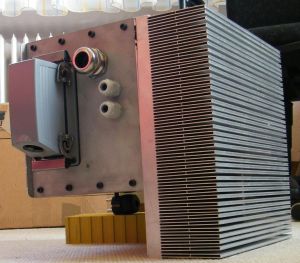

Assembled Inverter

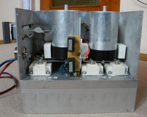

Inside View

Next up is capacitor selection. It's hard to give general advise. I always advise against elcaps because of their low ripple current rating. Better use film caps as shown above. If you can get your hands on any cheap and large (meaning above 300µF for filmcaps or 3000µF for elcaps) caps then give it a shot. Watch the DC bus voltage with a scope while running the inverter at load. You don't want to see excessive ringing or spikes. Here are some examples of what you do and don't want to see.
In the power stage depicted above I used 1.5µF snubber caps on each IGBT terminal plus two 420µF film caps. All components have screw terminals with the same width. That makes handling very easy. Everything is bolted onto a pair of alloy strips forming a simple low inductance DC bus.
To suppress high frequency common mode signals you can place a ferrite core around the DC bus or the DC cables. This will give you a better chance to pass EMC compliance tests.
Last but not least place the gate drivers directly onto the corresponding pins of the module. The PCB has been designed to line up. Make use of that. 1cm of wire should be enough!
