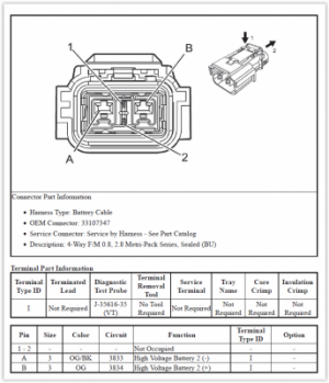

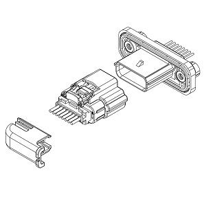

Connectors:
HV connector from Mouser Aptiv P/N 33107347
I also got pins P/N 15446674
Only connector is not enough. You need to get the end cap P/N 13824779 with rubber seal P/N 15513451.
Also i got LV connector JST P/N ATSSPB-C0805H-1AK
I also got pins P/N SAIT-A03T-M064
