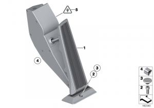

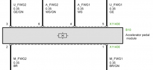

Accelerator Pedal Version 1
Pin Number | Cable Color | Function |
1 | Brown-Green | Ground |
2 | Brown | Ground |
3 | Yellow-Green | +5V Supply |
4 | White | Signal Sensor 1 |
5 | Yellow | +5V Supply |
6 | White-Green | Signal Sensor 2 |
No | Description | Part Number | Vehicles Used | Status |
01 | Accelerator Pedal Module, Automatic Gearbox | 35 40 1165703 | Until 10/1999 | |
01 | Accelerator Pedal Module, Automatic Gearbox | 35 40 6753053 | Until 08/2000 | |
01 | Accelerator Pedal Module, Automatic Gearbox | 35 40 6753518 | Until 11/2001 | |
01 | Accelerator Pedal Module, Automatic Gearbox | 35 40 6756492 | Until 05/2002 | |
01 | Accelerator Pedal Module, Automatic Gearbox | 35 40 6762480 | Until 02/2006 | |
01 | Accelerator Pedal Module, Automatic Gearbox | 35 42 6772705 | Until 05/2008 | |
01 | Accelerator Pedal Module, Automatic Gearbox | 35 42 6786281 | E38, E39, E46, E53 | |
01 | Accelerator Pedal Module, Manual Gearbox | 35 40 1165704 | Until 10/1999 | |
01 | Accelerator Pedal Module, Manual Gearbox | 35 40 6753094 | Until 07/2001 | |
01 | Accelerator Pedal Module, Manual Gearbox | 35 40 6753519 | Until 03/2002 | |
01 | Accelerator Pedal Module, Manual Gearbox | 35 40 6756493 | Until 06/2002 | |
01 | Accelerator Pedal Module, Manual Gearbox | 35 40 6762481 | Until 02/2006 | |
01 | Accelerator Pedal Module, Manual Gearbox | 35 42 6772706 | Until 07/2008 | |
01 | Accelerator Pedal Module, Manual Gearbox | 35 42 6786282 | E38, E39, E46, E52, E53 | |
02 | Adapter Plate, Accelerator Pedal Module | 35 42 6772703 | ||
02 | Adapter Plate, Accelerator Pedal Module | 35 42 6772704 | ||
03 | Torx-bolt with washer, M8x20 | 07 12 9905423 | ||
04 | Accelerator Pedal Bracket | 35 41 1163875 | Until 09/2003 | |
04 | Frame | 32 30 3411677 | From 2003/09 | |
05 | Self-locking hex nut, M6 | 07 14 7153450 | From 07/2007 | |
06 | Blind plug, D=25mm | 35 41 1163890 | ||
07 | Socket Housing 6 Pin | 61 13 8383300 | ||
-- | Bushing contact 0.2-0.5mm² | 61 13 0005197 |

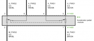

Accelerator Pedal Version 2
2 | Brown-Blue | Ground |
3 | Yellow-Blue | +5V Supply |
4 | White-Green | Signal Sensor 1 |
5 | Yellow-Green | +5V Supply |
6 | White-Blue | Signal Sensor 2 |

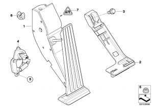

Accelerator Pedal Version 3
01 | Accelerator Pedal Module, Manual Gearbox | 35 42 6770935 | Until 02/2008 | |
01 | Accelerator Pedal Module, Manual Gearbox | 35 42 6786589 | Until 07/2009 | |
01 | Accelerator Pedal Module, Manual Gearbox | 35 42 6789529 | Until 06/2013 | |
01 | Accelerator Pedal Module, Manual Gearbox | 35 42 6793742 | Until 06/2013 | |
01 | Accelerator Pedal Module, Manual Gearbox | 35 42 6853176 | Until 03/2020 | |
01 | Accelerator Pedal Module, Manual Gearbox | 35 40 6889819 | ||
01 | Accelerator Pedal Module, Manual Gearbox (Stainless Steel Pad) | 35 42 6791474 | ||
01 | Accelerator Pedal Module, Automatic Gearbox | 35 42 6786588 | Until 11/2009 | |
01 | Accelerator Pedal Module, Automatic Gearbox | 35 42 6770936 | Until 10/2011 | |
01 | Accelerator Pedal Module, Automatic Gearbox | 35 42 6789528 | Until 06/2013 | |
01 | Accelerator Pedal Module, Automatic Gearbox | 35 42 6793743 | Until 06/2013 | |
01 | Accelerator Pedal Module, Automatic Gearbox | 35 42 6853175 | Until 03/2020 | |
01 | Accelerator Pedal Module, Automatic Gearbox | 35 40 6889818 | ||
02 | Fillister head screw, M6x16 | 07 12 9905536 | ||
02 | ISA screw, M6x16 | 07 12 9904588 | ||
03 | Cover bolt D=10mm | 35 42 6796540 | ||
04 | Cable Clamp A=3.5-6.0mm | 07 14 7547239 | ||
05 | Socket Housing 6 Pin | 61 13 8383300 | ||
-- | Pins for Socket Housing MQS ELA 0.75mm² | 61 13 8366260 |
