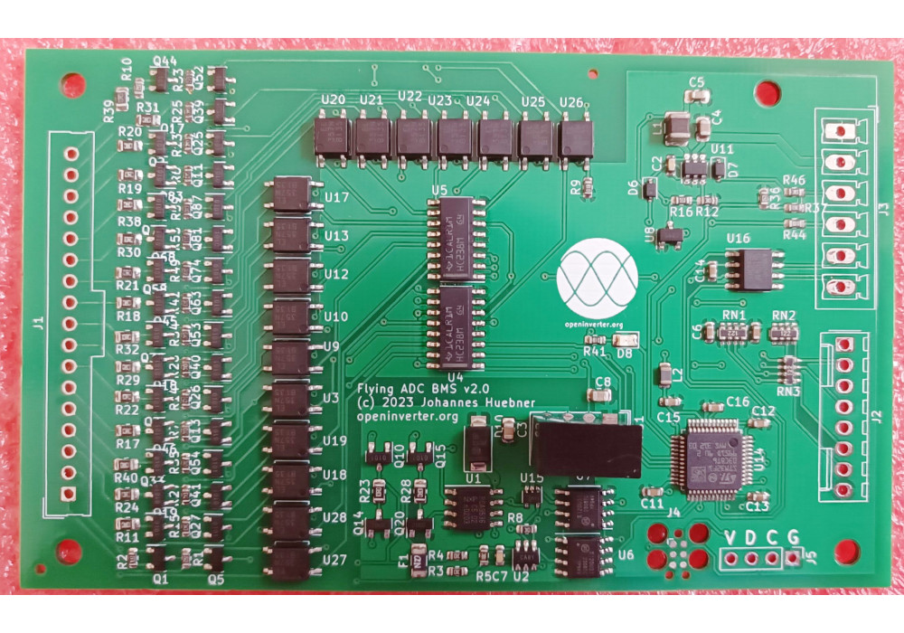

The design still has a bug when cascaded for more than 16 cells. Please use for maximum 16S packs for now!
This BMS has up to 16 cell voltage inputs, one current sensor input and two temperature sensor inputs.
It can be cascaded for larger battery packs.
  • Continuous transmission of aggregated cell data (min/max/avg voltage and temperature)
  • Continuous transmission of pack data (charge/discharge limit, SoC, current, pack voltage)
  • Single cell voltage obtainable via CANopen SDO
  • Automatic module addressing scheme, no jumpers needed
  • Configuration via ESP Web interface or command line tool
  • SoC estimation by configurable SoC lookup table
  • Continuous SoC calculation via current sensor integration
  • Bidirectional balancing, low cells can be charged individually, high cells discharged
For more details read the wiki page.
The community edition comes without personal support by me but you can get help at the forum. If you want personal support you can buy Engineering Hours.
You can print yourself an enclosure with this design: https://github.com/jsphuebner/FlyingAdcBms/tree/master/enclosure
Software is upgradable via CAN or SWD/JTAG.
No connectors are included, pick a 17-pin 2.54mm header for cell voltage inputs, 8-pin header for temperature sensor and current sensor, and 6-pin 3.81 mm header/cage clamp for 12V supply and CAN.
