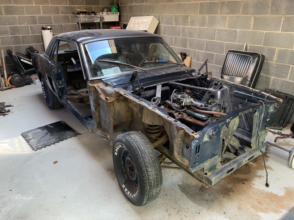

Kicking off a thread on my project. A few years back I bought myself a 1965 Ford Mustang. Here it is the day after I bought it. You can still see the rope attached from where a friend very generously helped me tow it home. There was just a minor issue with the distributor.
I've had it running on and off. But there are issues that need attention - water leaking in and rusting things up. It needs a fair amount of restoration work. The cowls need to be replaced, there are a few small holes in the floorpan, and there is some bubbling paint on one of the doors.
The original plan was to rebuild the 200ci inline 6 cylinder engine it came with, but I've decided to turn it into an EV instead.
I've more or less stripped it back to the bare frame. I'm grinding off all of the paint right now. After that will come bodywork repairs.
Since it's a rear wheel drive car, the Lexus gs450h CVT seems like the obvious way to go. Lots of power in a very tidy package that will fit neatly in the transmission tunnel. The only concern I have here is the strength of the original rear end. These cars came with three different differential/axle setups depending on which engine they were fitted with. Either 7in, 8in or 9in. My car came with the smallest engine so has the smallest/weakest rear end - the 7in. I've not been able to find any hard data on what kind of abuse this will stand up to. The original i6 produces up to 258Nm of torque. The plan is to use the original rear end and if I melt it (not that I'll be driving it very hard) then I can swap it out with something heavier.
The engine bay is very spacious - lots of room for batteries. The frame rails are 800mm apart. It's narrower between the shock towers of course.
Lots of room in the boot as well. In particular, there's a space that's approx 400x300x1100mm behind the back seats. It's sort of dead space that doesn't really take away from the boot space. I have one of the BMW 'saddlebag' 9.5kWh packs on the way. The plan is to start out with this small pack and get everything working. All going well, I'll invest in a bigger pack.

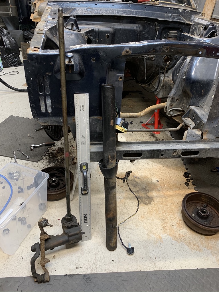

I'll also need to do something about the steering and brakes. Both are manual. But, most worrying of all is the way the steering works. It has one long 19mm diameter steel bar running from the steering box all the way up to steering wheel. Bit of a nightmare in a crash.
Hot Rod Magazine did a good piece on electric power steering in a Mustang using a Prius column
https://www.hotrod.com/articles/150-ele ... -delivers/
There are also some good collapsible (in a crash) columns out there. I'm going to use a race specific one from Speedway Motors for my 40 Chevy, but there are a bunch of street ones out there too.

Like the Prius power steering idea

Yeah, thanks, I really like the Prius column suggestion. Looking at some of these on eBay, it doesn't look like it would be too hard to adapt. I was doing some research at one point, trying to see if I could swap in a rack-and-pinion setup from another car and I have some vague memory of the steering being set up in a weird way on the mustang. I think you can end up with the steering working backwards if you're not careful. If I keep the steering box that's there and mate that with the Prius power steering column, then I should be OK.

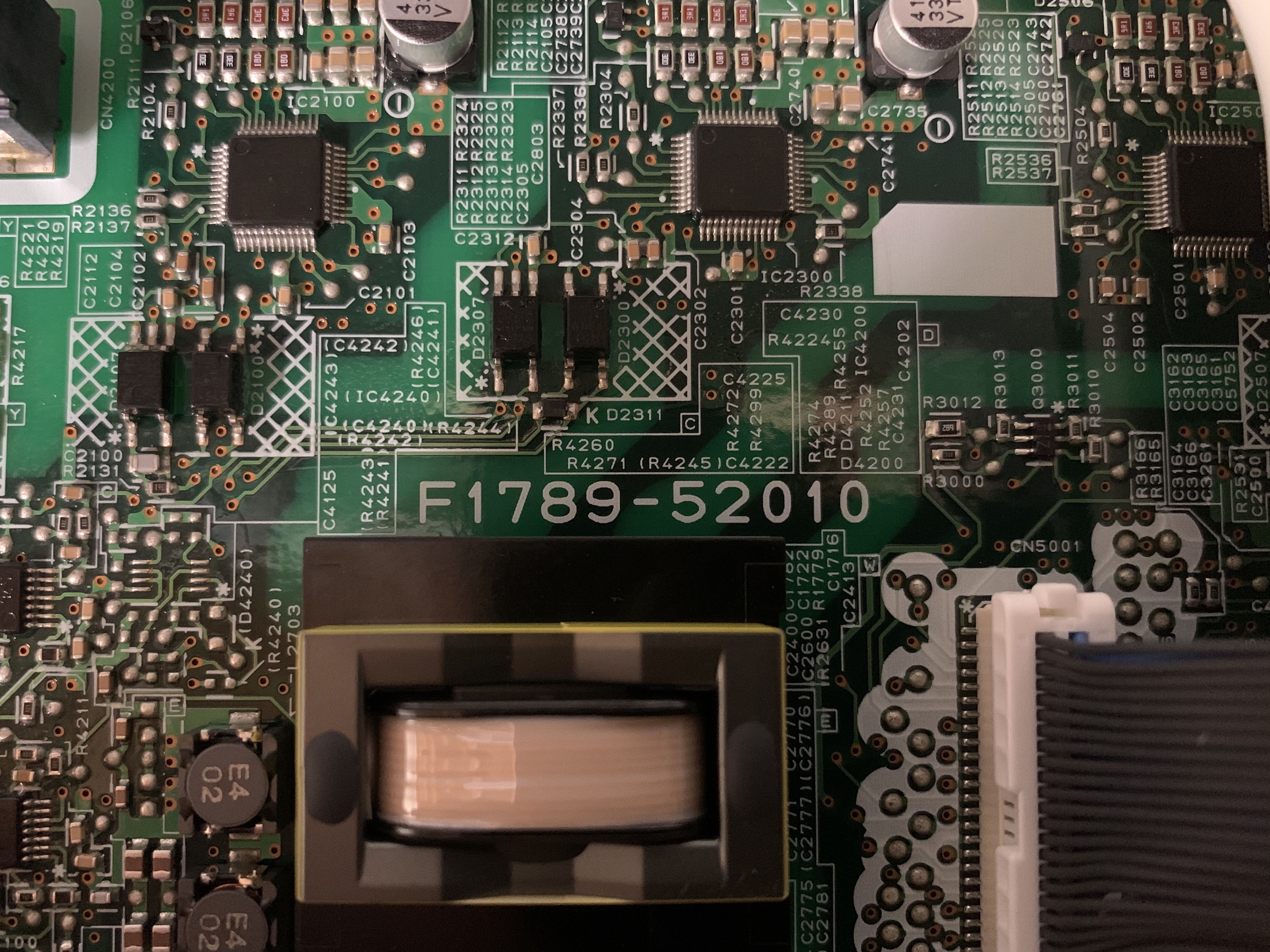

I got my hands on an inverter last week and finally got it open this evening. I wasn't paying very close attention and only realised that it was from a Prius Aqua (or Prius C). But, now, having cracked it open, and consulted the wiki it looks to have the same board numbers as the Yaris.
Top badge : G9200-52030
Side badge : G9201-52011
Small/top board : F1759-52010 04 (154mm long)
Big/bottom board : F1789-52010
Re: 1965 Ford Mustang

by Jack Bauer
Yep thats a yaris/auris variant.

by chrskly
Brilliant, thanks Damien.

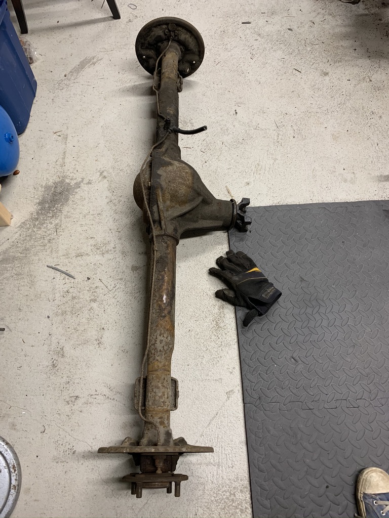

Yeah, I was just moving things around the other day in the garage and I was thinking to myself that the 3-speed auto that I took out was much skinnier than I remember.
Do you have any idea how you're going to join the gs450h transmission to rear axle. My car had a slip joint joining the transmission to the prop shaft. I presume this is standard on Mustangs. So, you can't just make up an adapter to fit to the U joint at the transmission end - the prop shaft won't be able to 'breathe' as the suspension moves. You could make a new adapter that fits the gs450h on one end and has a slip joint on the other. This might push the gs450h transmission forward into the engine bay a bit more than you'd like though.
The other option is to use the prop shaft from a gs450h and make an adapter to join it to the diff.
Also, what rear end do you have in your Mustang? 8in, 9in?

I bought an adapter to convert the 3 bolt flange to a standard u-joint. You can then get your stock driveshaft modified (or buy a new one) with the slip yoke on the driveshaft.

The 3 bolt flange to a standard u-joint was what I had planned to use as well. My mustang is/was a 289 auto. I am fairly certain I have the 8in rear end. My plan was to get a 8.8 rear end out of a ford explorer and cut it down to fit. There are tutorials online. This would give me rear disk breaks as well as Traction-Lok.
