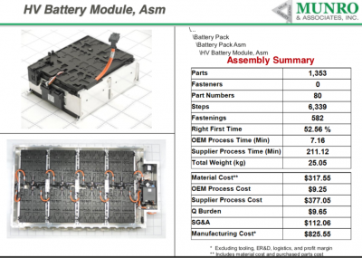

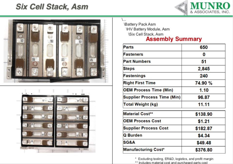

The teardown is pretty cool. Basically a scaled photo and description of every single component (down to the last nut & bolt), with a little bit of commentary on the interesting bits.
Here's an extract from the battery section:
