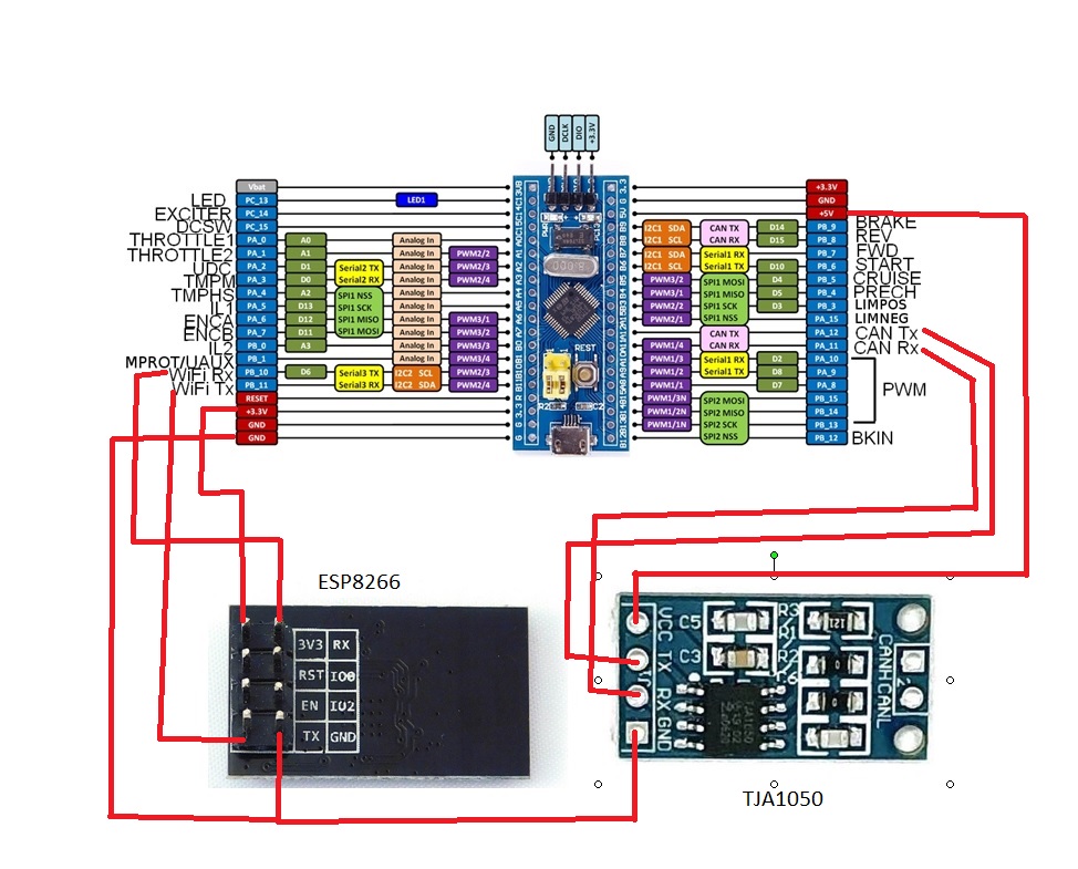

I want to ask for hardware doubt. For wifi - no problem, it should be working well. I have question to CAN bus module. For Blue Pill I can't to use MCP2515, but I think direct serial TJA1050 module?
This should be working like on picture?
I need this module only for CAN messaging in fact only, so not other parts are needed.
I know, that maybe faster will be to use only v3 board from Johannes, but for now I even don't know if I will be able to go further with programming in code::blocks - or even modify Johannes sketch
Blue Pill + ESP8266 + TJA1050

Yes I believe that will work. However the TJA1050 requires 5v supply. I suggest a SN65HVD230, which is designed for 3.3v.

Yes, thank You for info. I will also look at this board and then decide which take for final version. For now is only important, that this will work. I have to order one of those and try. First I have to compile somehow Johannes project and try to look at can bus. I will report then what is happen.

The MCP2515 does work with the bluepill, I have used it in a design and I second what Isaac96 says about using the 65HVD230
