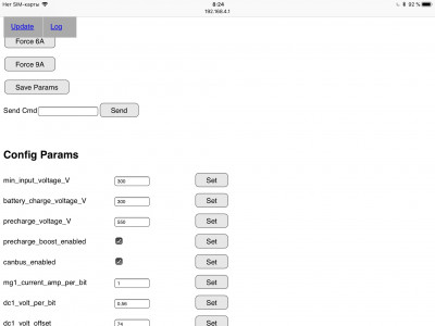

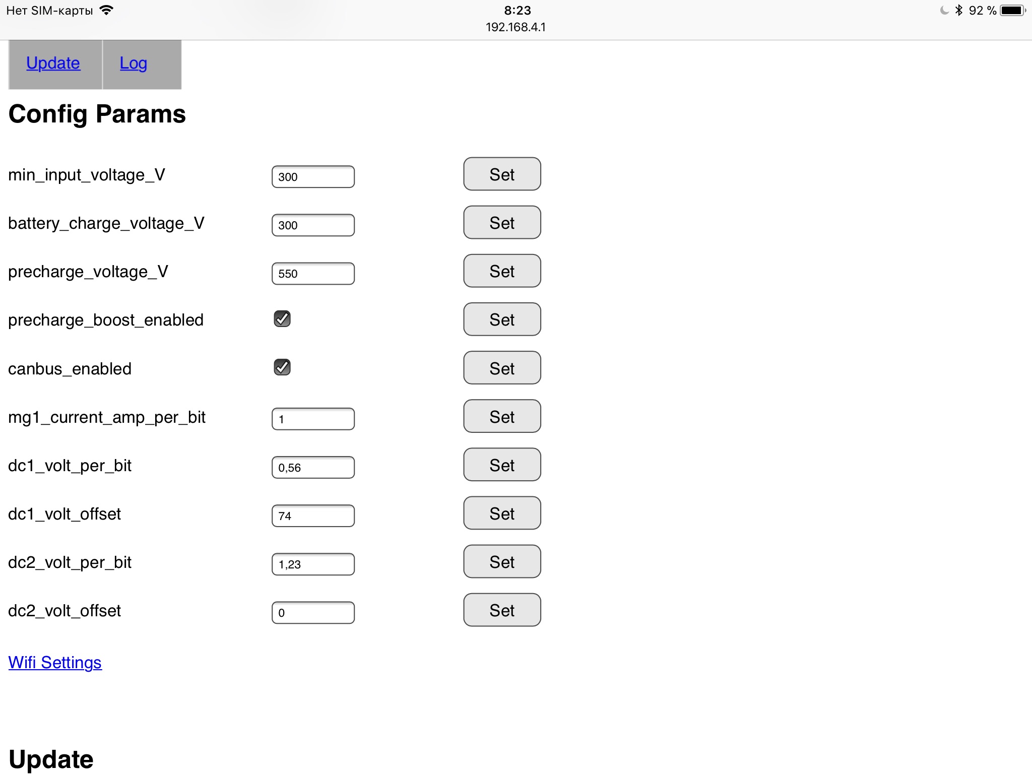

And no matter what I do the parameters don't appear(((((((((! There may be an error in the files that I downloaded(source files) . Please, friend, reload the files in the storage))) I really want to connect electricity to the inverter already )))
Posts: 1594
Has thanked: 75 times
Been thanked: 303 times
Re: Gen 3 inverter converter control software
The parameters appear to be there in the screenshot.

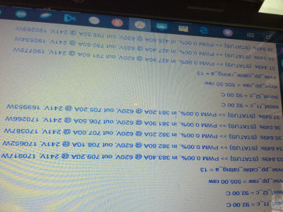

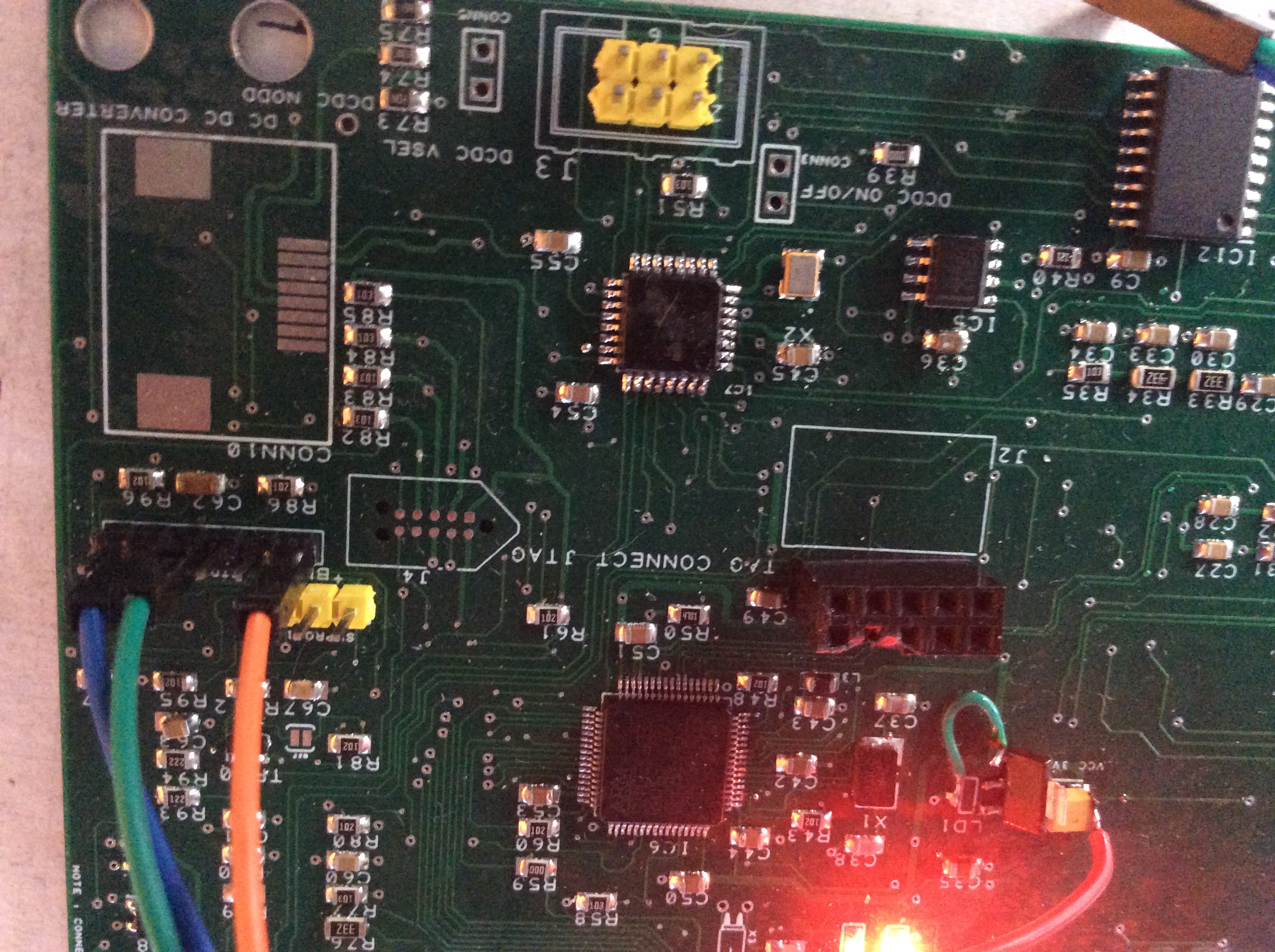

First want to say a big thanks to Bigpie and the others working on this. Has came a long way in a short time:) So I'm spending a few days watching batteries charge and I'm planning to use this system for charging in the Blue Yacht so thought I'd have a go.
1)Uploaded the firmware on the 328p. Seeing data coming out over serial terminal. all good here.
2)Got my head around platformio and uploaded webinterface to a d1mini. again all good here.
3)When all connected together no parameters as Leo has observed so did some digging.
Using an ftdi cable I could see no data arriving from the 328p at the pins of the D1. Removing resistors R86 and R96 and shorting them out showed data at the D1 and indeed blue text started apearing on the web interface log area but still no paramaters. verified the word "params" getting to the rx pin on the 328p but no response.
Board I'm using is an old rev auris and the d1 load was pulling the 5v rail down to 4.4v so powered the d1 from an external source. Bit better but the 328p still hangs up after a minute or so. Decided to decouple the whole thing from the logic board and loaded the code on an arduino due and connected the d1. Now the 328p does not hang but obviously throws errors in the serial data as no current sensors or can etc. Anyway, can now see the 328p respond to the "params" request but the parameters are not populating on the web interface.
Here is a serial capture :
{DEBUG} Calibrating current sensor zero offsets...
{ERROR} Not accepting current calibration values: 258, 252 (out of range)
{ERROR} Not accepting current calibration values: 259, 255 (out of range)
{ERROR} Not accepting current calibration values: 257, 259 (out of range)
{DEBUG} Waiting for EVSE CP PWM (set force_ac_input_amps if you don't have EVSE)
{STARTCOMMAND}
"min_input_voltage_V": { "type": "number", "value":300},
"battery_charge_voltage_V": { "type": "number", "value":300},
"precharge_voltage_V": { "type": "number", "value":550},
"precharge_boost_enabled": { "type": "bool", "value":1},
"canbus_enabled": { "type": "bool", "value":1},
"mg1_current_amp_per_bit": { "type": "number", "value":1.00},
"dc1_volt_per_bit": { "type": "number", "value":0.56},
"dc1_volt_offset": { "type": "number", "value":74},
"dc2_volt_per_bit": { "type": "number", "value":1.23},
"dc2_volt_offset": { "type": "number", "value":0}}
{ENDCOMMAND}
{ERROR} Not accepting current calibration values: 265, 259 (out of range)
{ERROR} Not accepting current calibration values: 260, 254 (out of range)
{ERROR} Not accepting current calibration values: 273, 266 (out of range)
{ERROR} Not accepting current calibration values: 285, 278 (out of range)
{ERROR} Not accepting current calibration values: 287, 282 (out of range)
So some hardware debugging needed from me but still not sure why the parameters are not populating assuming the response above is correct.

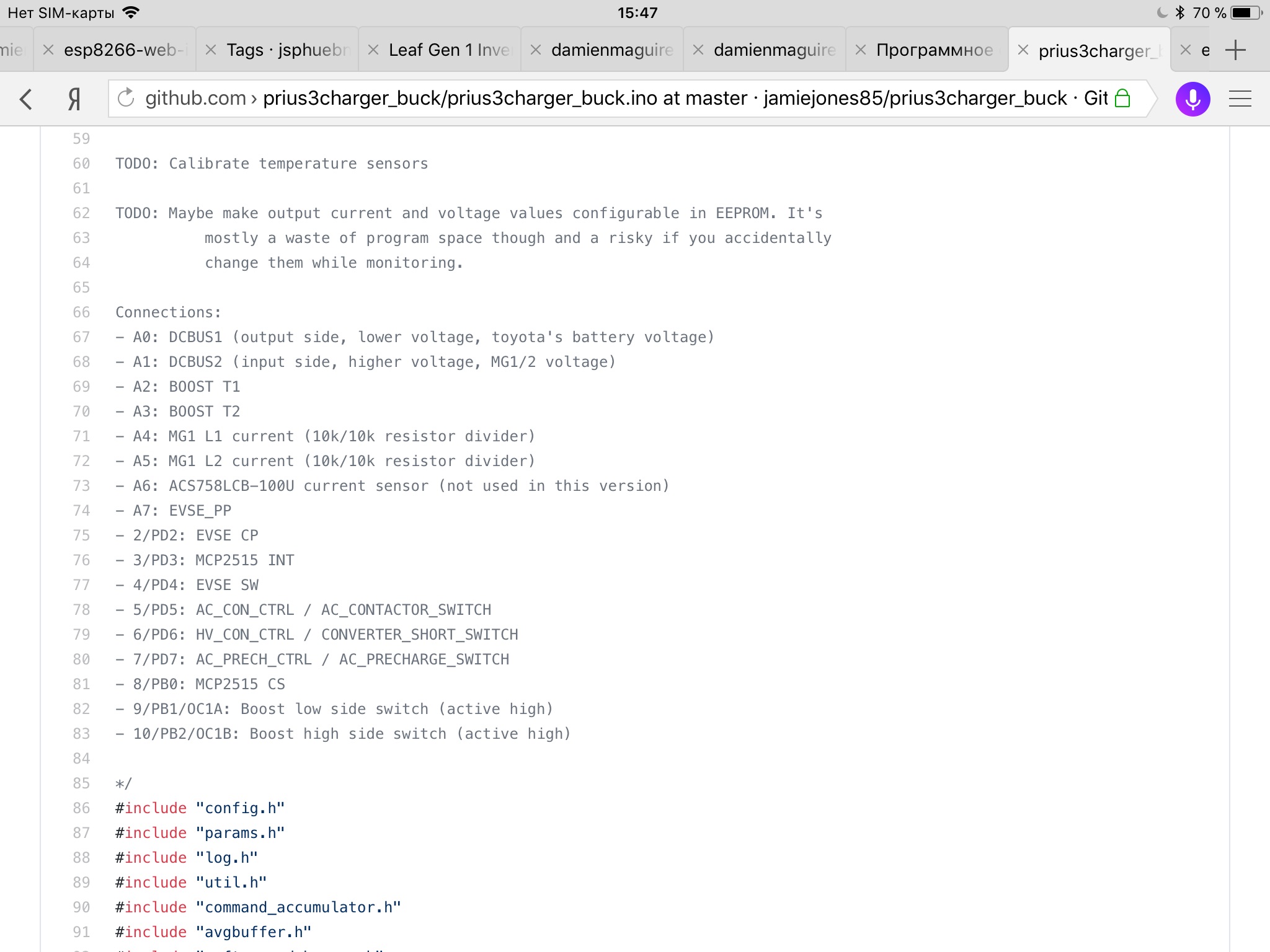

I've pushed an update to my clone of prius3charger_buck, give that a whirl.

Great! Let's try it now))) the main thing is that the problem is hidden there ))) It's good that Demian also joined this topic... maybe together we will overcome this topic as a team ...)))
Leo M
Posts: 88
Joined: Fri Oct 30, 2020 9:48 am
Post by Leo M »
Yes!!!!!!!! There are parameters! Thank You, Bigpie!!👍

Resistors r86 r96 do not need to be removed ... they are needed for the decoupling.

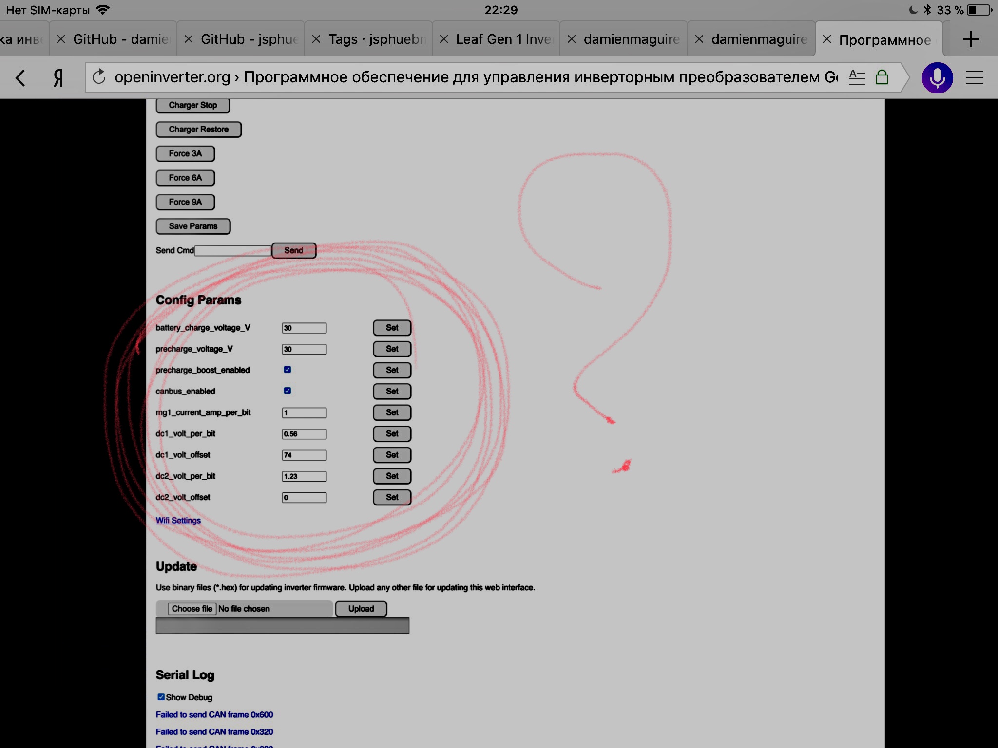

Parameters are not always loaded ((you need to refresh the browser page several times((( saving parameters also raises questions... I think Bigpie did a great job , we still need to refine the script....

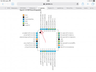

Reset atmega where do we connect to the esp ?
Posts: 1594
D2
VW Beetle 2003
Outlander front generator
Outlander charger
3x Golf GTE batteries
Chademo Charging
Outlander water heater
Leo M
Posts: 88
Post by Leo M »
D2 atmega esp ?
Posts: 1594
D2 on the esp to rst on the atmega

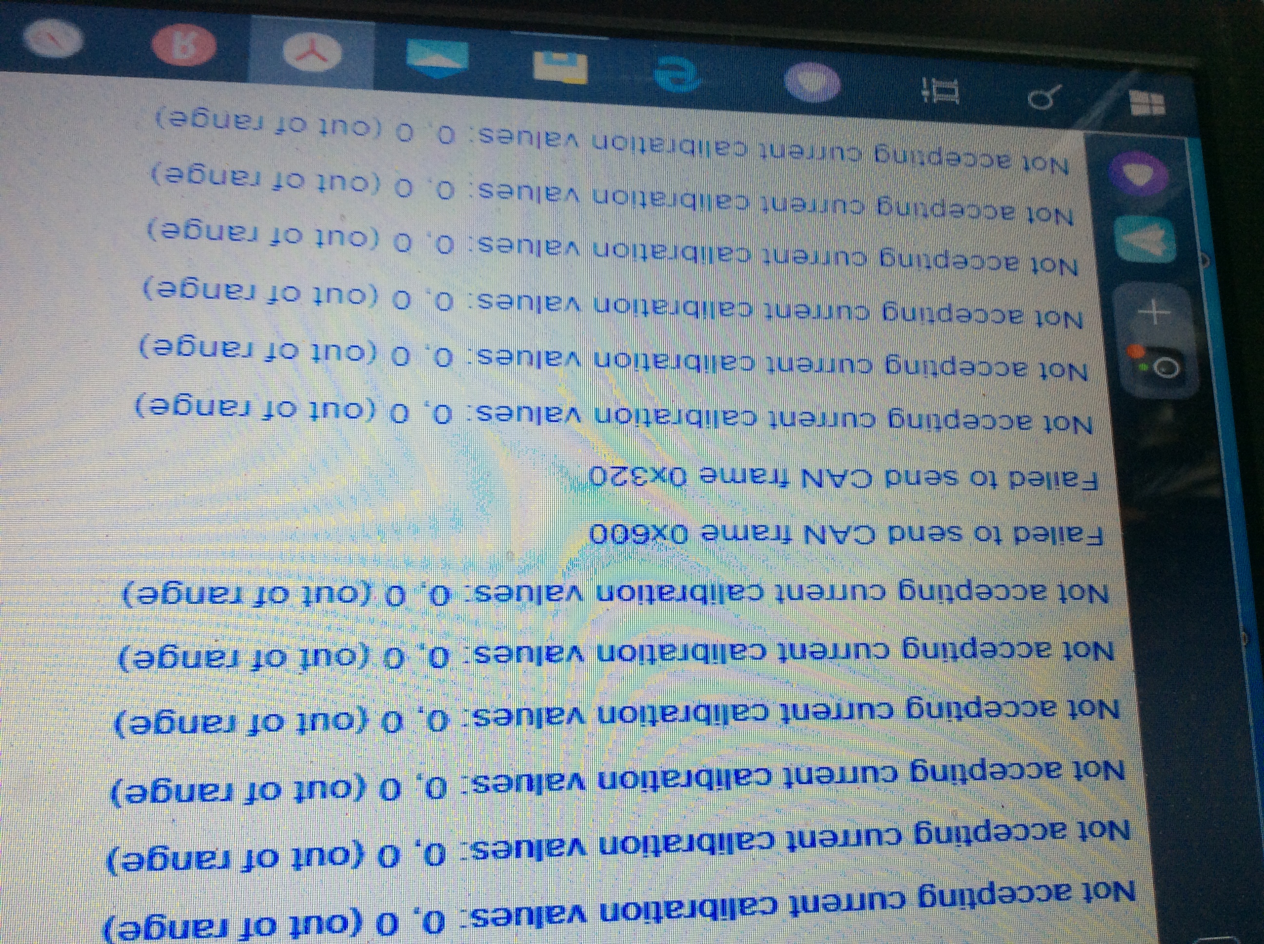

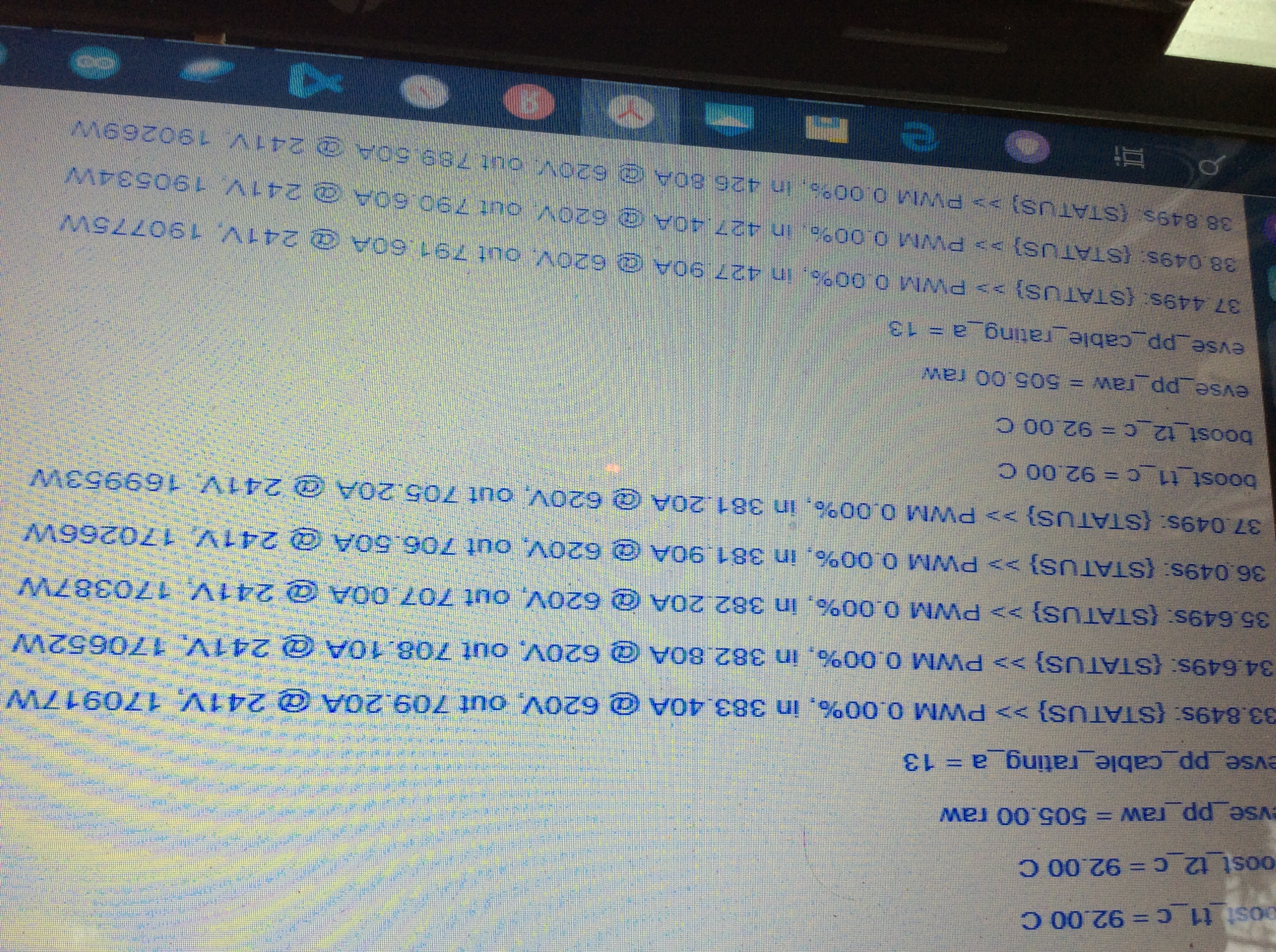

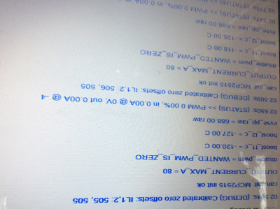

Hello everyone I have nothing worked yet (((the parameters are there - there is no work! There is no calibration of current sensors! Did it work at all or not?
Posts: 1594
Mine calibrate now, I did have an issue with one of the resistors needing replacing. Paste your output here.

without current sensors....
Leo M
Posts: 88
Post by Leo M »
With sensors connected... after connecting the sensors, the parameters in the interface disappear and appear only after the atmega reset (((
Leo M
Posts: 88
Post by Leo M »
Resistor 4.7 Kom ?
Leo M
Posts: 88
Post by Leo M »
4.7k/4.7k———10k/10k ?
