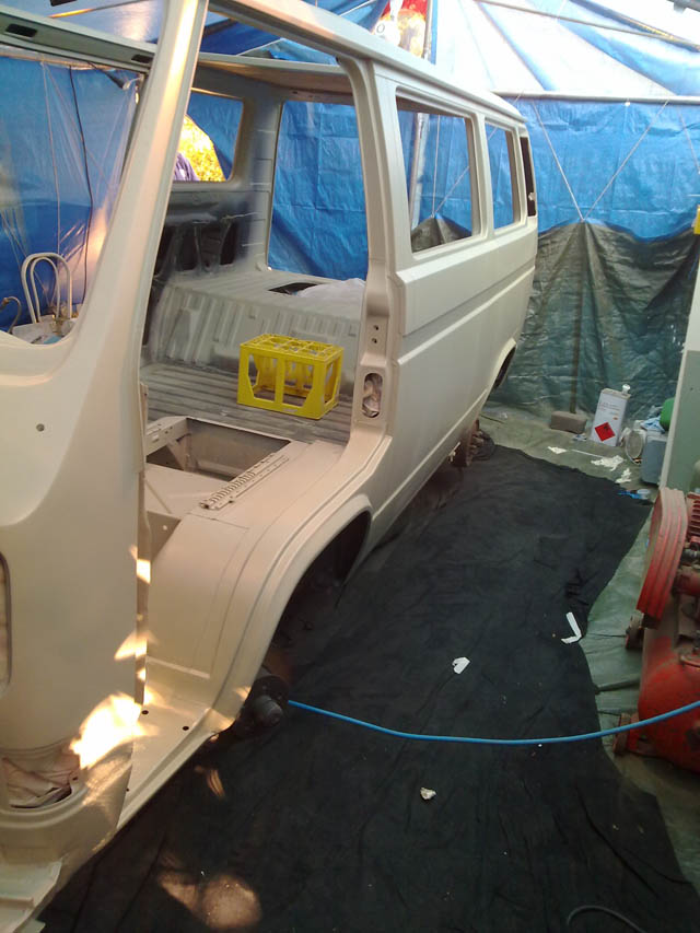

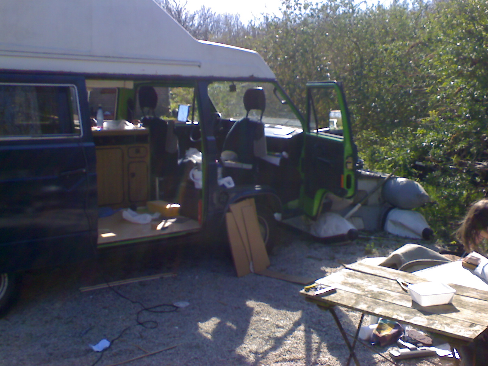

This project has a bit of a history. Back in 2007 I met my wife and she bought a VW T3 Westfalia 1980 aircooled hightop campervan for 1000€. I didnt have a drivers licence back then and was totally not interested in cars. After a year she found out that this van was a total rustbucket, unsafe and beyond repair. We decided to strip all parts of value and buy another T3 van and combine both. So again for almost no money we bought another aircooled T3, this time an ex army van. For 2 years we worked on the van in the weekends at her parents place, we were students: so plenty of time, no money. We learned how to weld, spraypaint, work on cars in general and for me how to drive. After second coat of primer, we decided to break up...... We wrapped the van in sealing plastic and left it for better times.
We came back together after a few months, graduated, married, got jobs, got kids..... So became boring ;-) now 12 years later we decided to finish the bus. In the meantime I got addicted to the car hobby and have a fully equipped workshop where I work on multiple cars (only BMW's) when time allows. For a few years I worked at a EV manufacturer as a mechanical engineer and I got inspired by the engineering challenges that come with EVs. Recently we unwrapped the van and moved it to my workshop (rust is really limited luckily). So works can start!

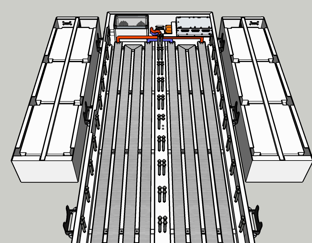

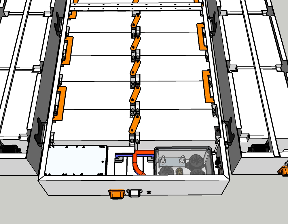

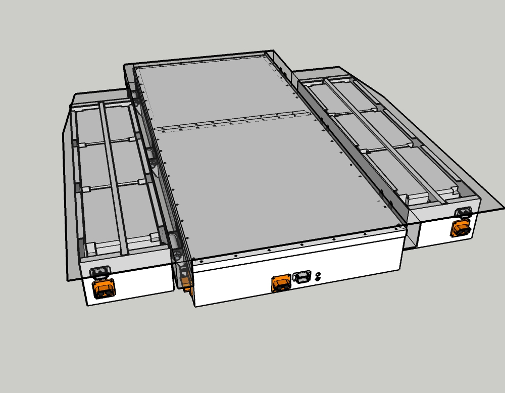

I'll update this topic often and in case I could use your opinion on certain design choices. Main focus is now the battery pack of which I attached some screenshots. I want this pack to be lasercut and welded end of this year. Structurally it will work, but I have my doubts of the cooling via the aluminium profiles that I now imagined. The idea comes from the I3 batterypack which uses a bit similar solution (but with hvac fluid). I plan to use 16mm hoses (200mm2) which connect to profiles with a 400mm2 inner area. I'll use heat transfer compound or sheets to make sure it is transferred from the modules. The radiator will be mounted in the old enginebay (like Kevins T2 van).

Status of the 2nd van 12 years back and today
The old van
The old van
cooling by means of aluminium pipes like i3
place for bms and contactors
modules divided over 3 packs: 6+20+6

tmotion wrote: Sat May 09, 2020 12:26 pm cooling by means of aluminium pipes like i3
I like your cooling system, is it aluminium rectangular tubes welded together?
Very goof idea!

joromy wrote: Sat May 09, 2020 9:23 pm
Very goof idea!
Yes! Im sure that a machined aluminium cooling plate is more efficient but this comes at a high cost vs some standard welded profiles.
