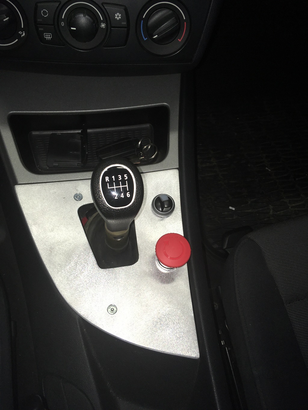

When I had a little more time to be an metal artist :) I did new cover for gear selector. Now is clear alu plate, but later I will anodize this. Small upper selector is for REV/FWD select. For now I did trial on second and third gear. On second probably I will go all the time in city and I feel that 3 will be used on highway, nothing else will be not necessary. What I tried, that on second gear and 3/4 throttle pressed I had current on DC side about 230A peak visible on Torque App with Orion BMS current sensor + OBD2 bluetooth dongle.
Can I go more?
Zapatero - this is question to You, because I want to have not worst acceleration time than You ;)
For now when I will press Emergency button 12V and DC power relay to inverter will open. I hope this solution can't damage IGBT, what do You think?

damian.lo wrote: Sun May 03, 2020 7:25 pm For now when I will press Emergency button 12V and DC power relay to inverter will open. I hope this solution can't damage IGBT, what do You think?
I've read on these forums (don't remember where) that interrupting power to the contactors can damage the IGBTs if the motor is spinning. This is because a permanent magnet motor does not require excitation current to produce power.
Could you wire the emergency stop to the EMCYSTOP input on the inverter controller? That would shut down PWM without risk of breaking IGBTs.

This wrote Arber, even was speaking with me :)
I was thinking about this - what You wrote. My emergency input is connected via interface board to Leaf inverter directly so I hadn't this pin available. I don't know what Johannes thinks about this - original inverter is somehow secured itself? What do You think?

damian.lo wrote: Sun May 03, 2020 8:03 pm This wrote Arber, even was speaking with me :)
I don't have a Leaf inverter myself, I was just repeating what I've read about others :twisted:
As I understand it:
There doesn't seem to be a way to protect the inverter. The problem is that the back EMF from the motor keeps rising. This energy ends up on the HVDC rail. And if the battery is connected then it absorbs the energy as regen. But without a battery, there is nowhere for the energy to go and then the voltage rises too high and boom go the IGBTs.
I can't remember if the Leaf has 1200v or 600v IGBTs? Maybe this wouldn't be a problem with higher voltage ratings?

No you should definitely leave your DC contactor ON.
Can you use your Emgcy button to just suspend pwm inside VCU? Is there an option?
Your DMW inspector will probably demand that a push of red button requires two separate actions to put vehicle in use again, not just one move of button.

I remember, that on Rev2 board emergency signal was available to use. In v3 board + leaf interface board there isn't this pin free for use. I have to look at schematic where Johannes connected this.
Maybe in fact better will be to leave contactor on and only shut down +12V to inverter or take off emergency signal inside of inverter. This is the worst if I'm thinking about one more time take out all of the stuff :)
In next week I will meet with inspector. In Poland first I have to collect all of necessary data (schematics, datasheet of components, etc.), then he will look at car, modified circuits and if all of this is ok he will give me his opinion (I hope will be good). Then with this "passport" You can go to normal car inspection, like with standard yearly inspection.

If you switch your inverter on with 12V this is your normal circuit. You can switch it off with a car key. Emgcy button then is your fallback circuit. In forklift DC world it took away GND connection to DC contactor to be sure of disconnect. In AC world we have a different problems. Here Emgcy switch needs to shutoff pwm but not 12V completely...
Isn't there a Fault line inside VCU circuit to pull pwm down? You could use this as input with GND connection.
What about CAN msg? Can you take away those? Then inverter would be silent...

Yes, right I will back with supply inverter from Ign, without interrupting by emergency input, this is more safety to IGBTs.
All of the inputs available in Leaf interface board from Johannes are:
- 10 = IN_BMS
- 14 = CANH *
- 15 = CANL *
- 16 = IN_FORWARD
- 22 = IN_START
- 23 = IN_BRAKE
- 25 = IN_REVERSE
- 28 = THROTTLE2
- 29 = THROTTLE1
- 38 = IN_CRUISE
- 44 = MTEMP1 *
- 45 = MTEMP2 *
And now: or I will need to open inverter and take out Emerg. signal, or make CAN bus interlock or use input 10 = IN_BMS to disable inverter, the same like undervoltage of battery.
What do You think, will be best solution?

I would go for BMS IN.
EDIT: Didnt Johannes say if you pull both FWD and REV signals to GND you disable pwm of inverter? You can remove both signals with following latching relay circuit and you still retain BMS input in case of undervoltage event to put your car in turtle mode...
You can make your signal with two DPDT relays in latching configuration that are locked by ignition key and if you push EMGCY button you take away GND connection to this circuit, a failsafe.
Then to start your motor again you would need to unlatch your emgcy button AND recycle your key to start position. This would satisfy every inspector and keep aux circuits in your car running while inverter PWM is off.

Arber, You have right. Better is to save IN_BMS for BMS :)
Your solution is right with failsafe and resetting by ignition, but "pull both FWD and REV signals to GND you disable pwm of inverter" was not diverse?
If You want to go forward, you apply 12V to this input or to reverse input. If both are disconnected (open), inverter doesn't generate pwm. What I remember from rev2 board, for charging Johannes wrote, that applying 12V to both inputs disable PWM, to don't drive while charging. Wasn't like this?
Of course Your logic solution for my trouble is good, thanks for that.

damian.lo wrote: Wed May 06, 2020 10:36 am Arber, You have right. Better is to save IN_BMS for BMS :)
Yes you are correct. If you apply solo FWD or REV you get a direction change. If you leave both lines open then internal pulldown resistors pull both pins to GND. So all you need to do is to cut both directional lines. You can do this easily with a DPDT contact relay. Try failsafe logic. When you switch 12V from key, relay is ON and it is conductinig both signals. But when you apply your EMGCY button you remove GND signal to relay and it will cut both direction signals.
All you need is one double relay.

Exactly. I will do like this. Now I have a little more time, because I'm making cover for under-car-battery pack, so car is blocked for some days. Then I want to put all of under covers of car floor and go with air cooling of Ampera DCDC. In Your opinion should be enough air, which usually go to air intake/filter?
