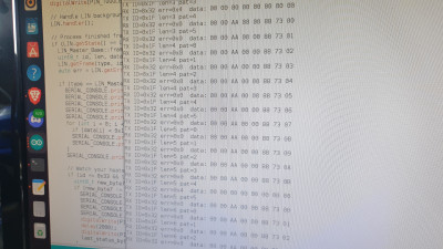

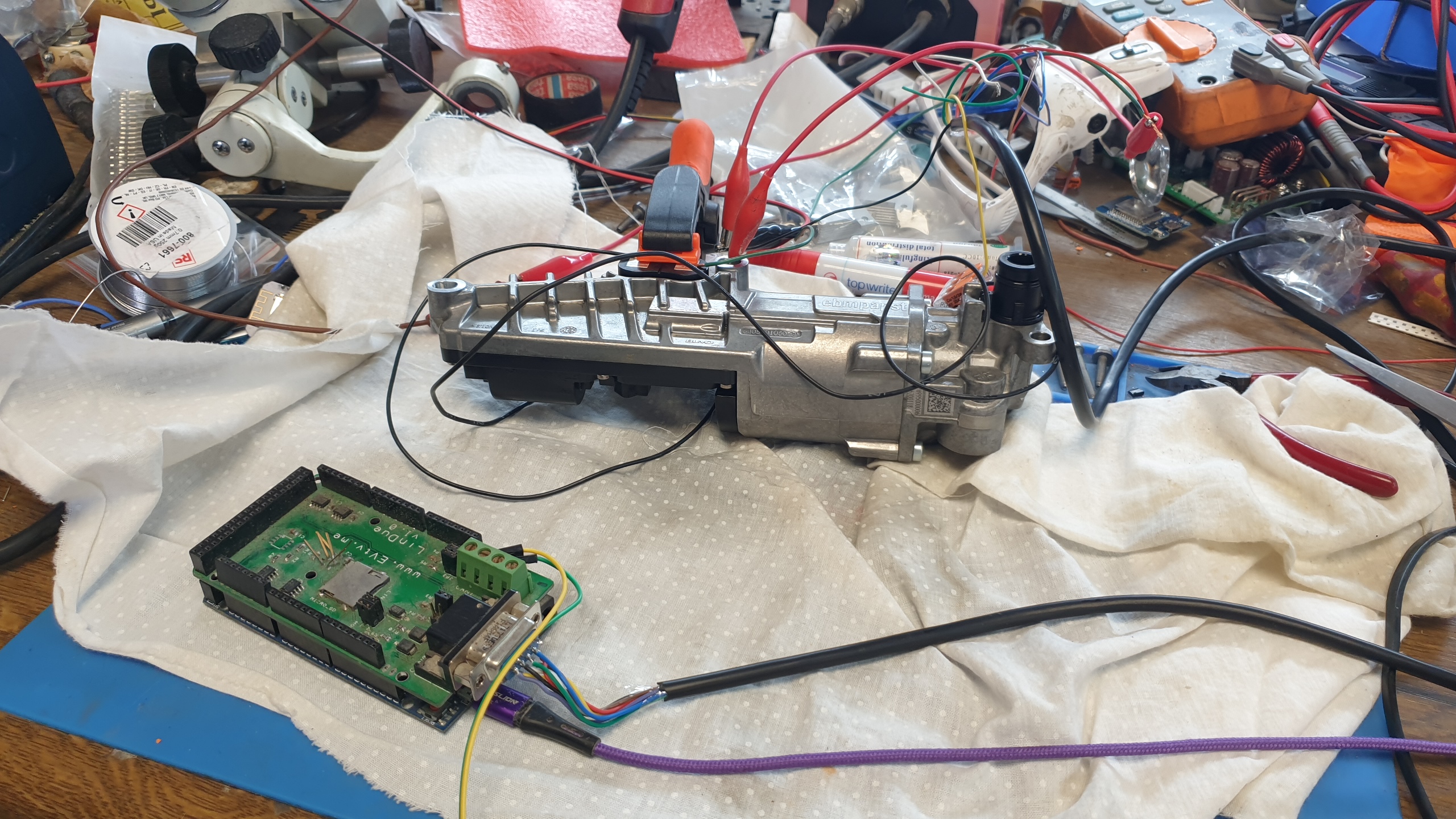

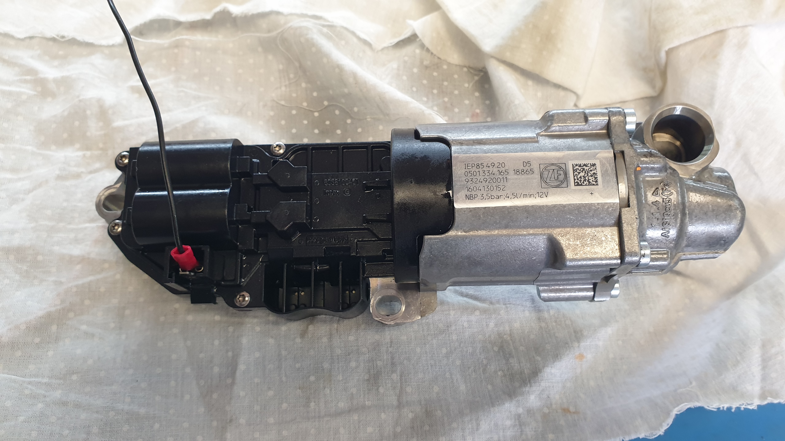

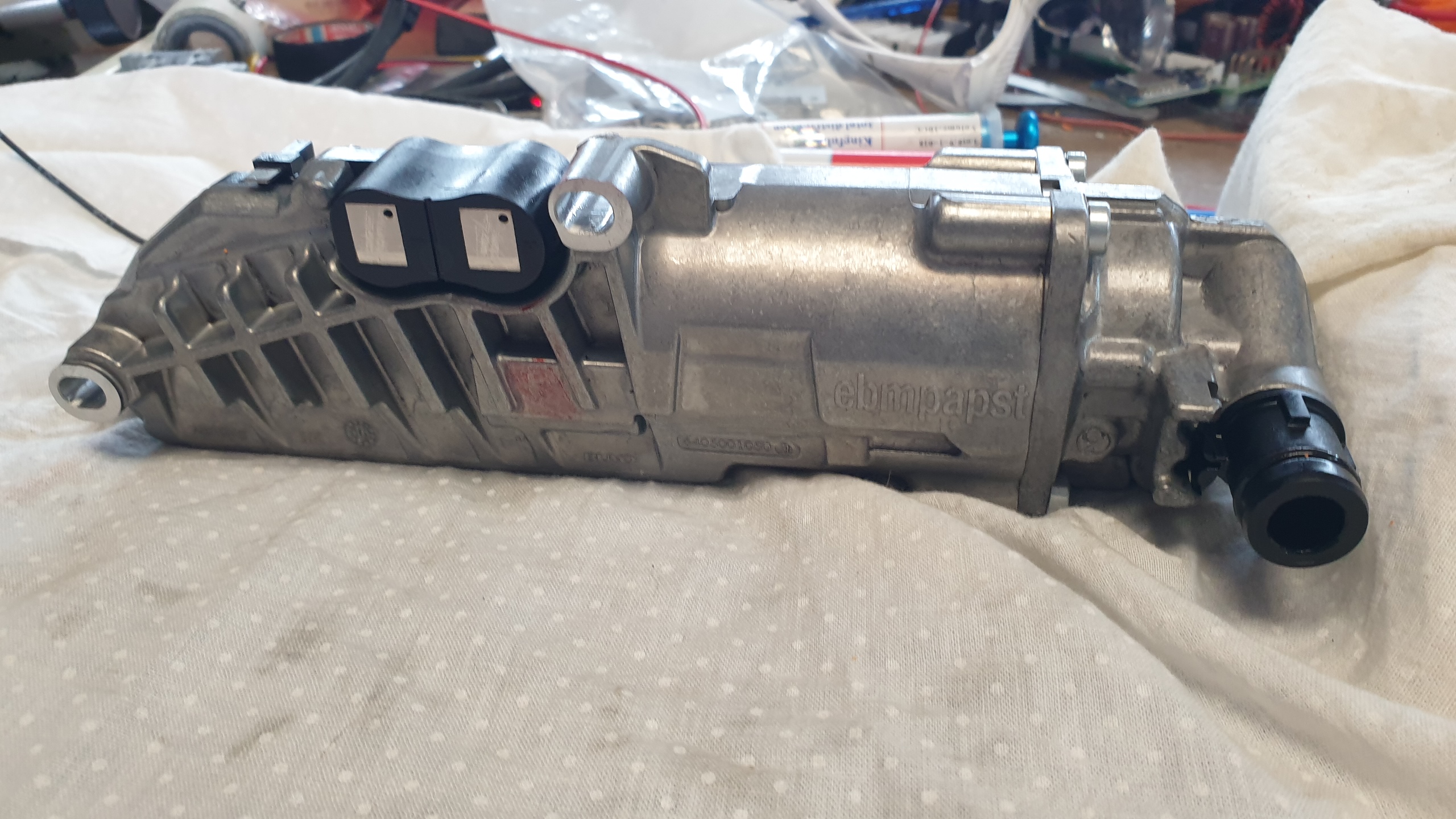

Welcome folks to my nemesis, the pump of Doom!! also know as the auxiliary 12v oil pump in the phev version of the ZF 8hp gearbox. I'm 4 days in so far and have managed the amazing feat of making it run reliably for 300ms! I know I'm amazing. In an attempt to help others who may be foolishly following along here is a breakdown of learnings to date :

Run procedure used
• TCM sends 0xAA, 0x00, 0x0A, 0x00, 0x00, 0x00, 0x73, at first.
• Then switches to 0xAA, 0x00, 0x42, 0x00, 0x00, 0x00, 0x73, after approx 900ms.
• Setting 0x55, 0x00, 0x42, 0x00, 0x00, 0x00, 0x73, will cause a spin for approx 300ms then pump faults until next power cycle or LIN pause for approx 5 seconds causes the pump to sleep and reset.

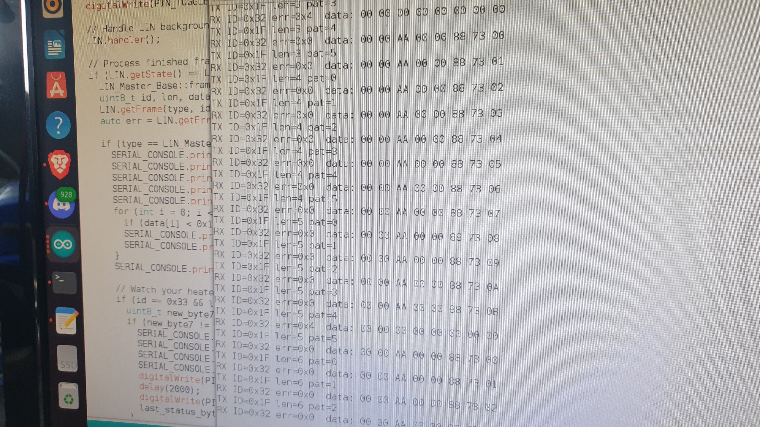

Core behavioural pattern we see every time
1. Coldstart finishes (AA 00 42 …)
2. First good 0x55 command arrives → 0x32 instantly becomes something like: 00 00 55 2A 14 xx xx xx ← motor spins briefly
3. Second (or any subsequent) 0x55 frame arrives → 0x32 immediately changes to: 40 00 AA 00 00 xx xx xx ← fault + reset
4. Pump makes the rapid ticking sound and goes silent (“Slave not responding” on PeakLIN)
→ The pump accepts exactly one valid 0x55 frame before its internal safety watchdog kills the command.

I see everyone is as super excited about this as I am and can't wait for an update. I was sent this link which has some useful photos and other info :
https://static.oemdtc.com/NHTSA-PDFs/MC ... 4-0001.pdf

The update nobody was waiting for. Now trying all possible 4 byte combos with this nifty program. Gonna take about 5 days it seems. Don't worry , I'll make irregular updates.
