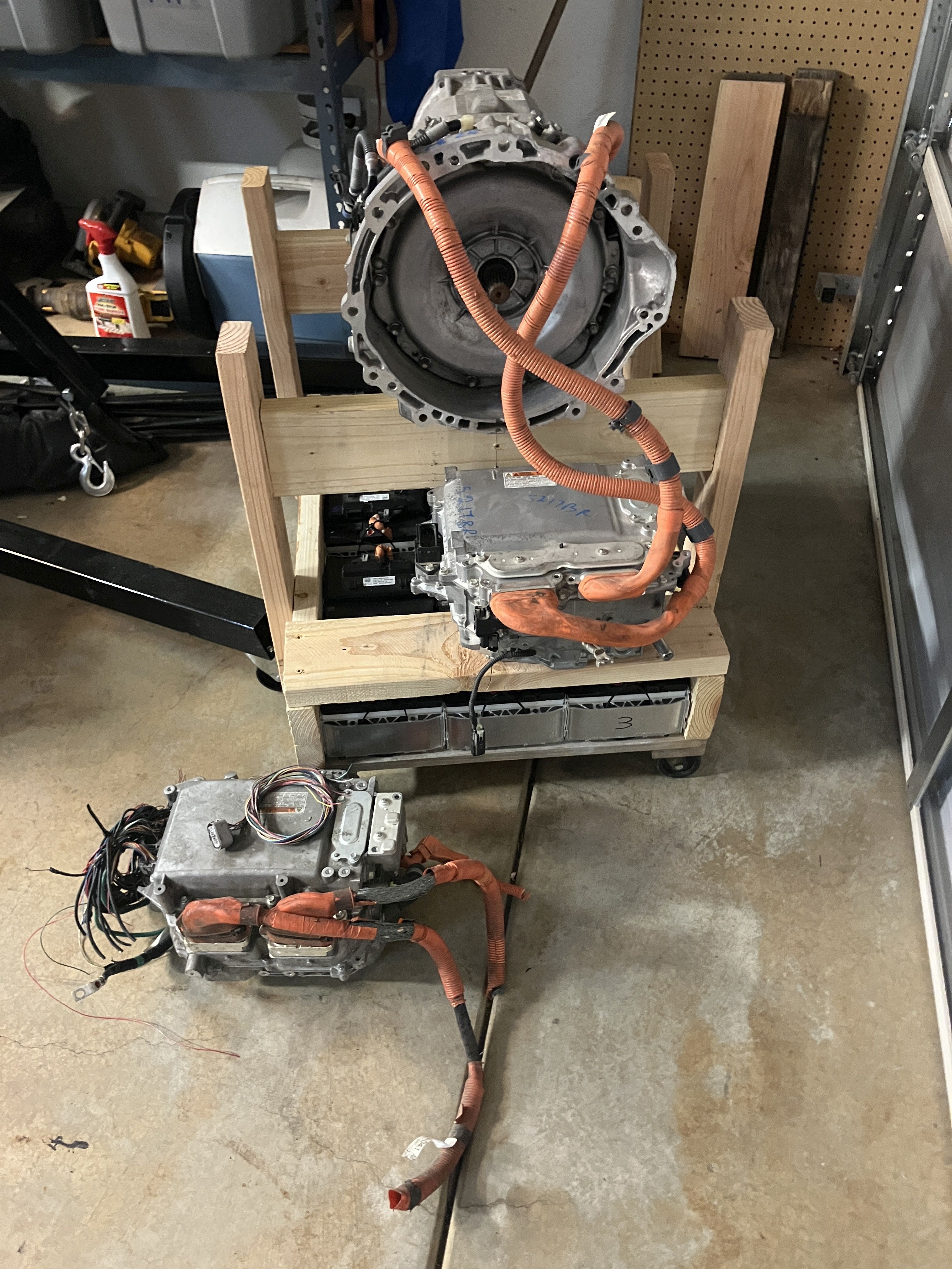

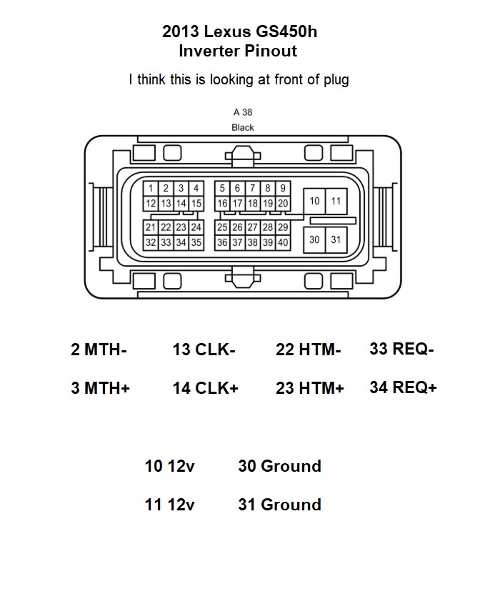

"Converting a 2010 BMW 535i GT into an electric vehicle using a fourth-generation Lexus GS450 motor with a ZombieVerter. However, I am facing an issue connecting the inverter to the ZombieVerter. All the projects on the forum are based on the third-generation Lexus GS450—does it use the same wiring? I would appreciate support. For reference, I have already started removing the engine."

Have you tried it yet or not? I vaguely remember someone saying it worked fine on here but you'd be probanoy best just trying it out and seeing if it works. Are the connectors identical?

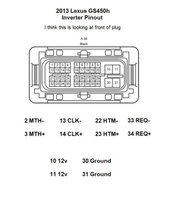

the Toyota Avalon has the same inverter plug
