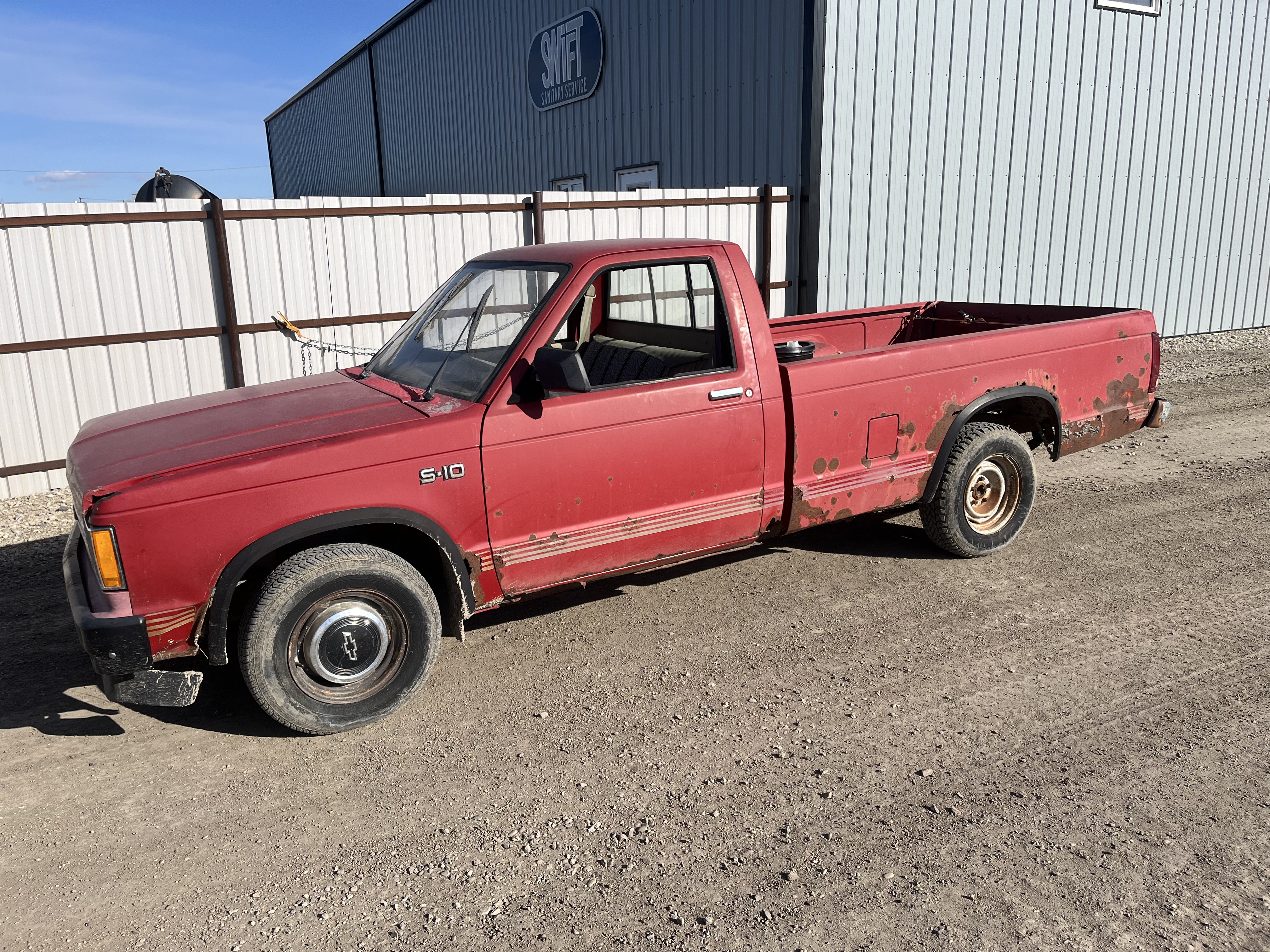

Hey everyone I have been dreaming of this for a long time and was finally able to start my project. I have officially ordered my fist EV conversion part, a Leaf motor
My donor car is a 1987 S10. It is rusty but I love it. It will mostly be used for a 6km commute each day and any other running around town I need. I don’t think I need more than 50km range. I am on a fairly tight budget but still want to make it reliable and safe. If I can get it safely mobile now I may upgrade things later as I have money and as parts come around.

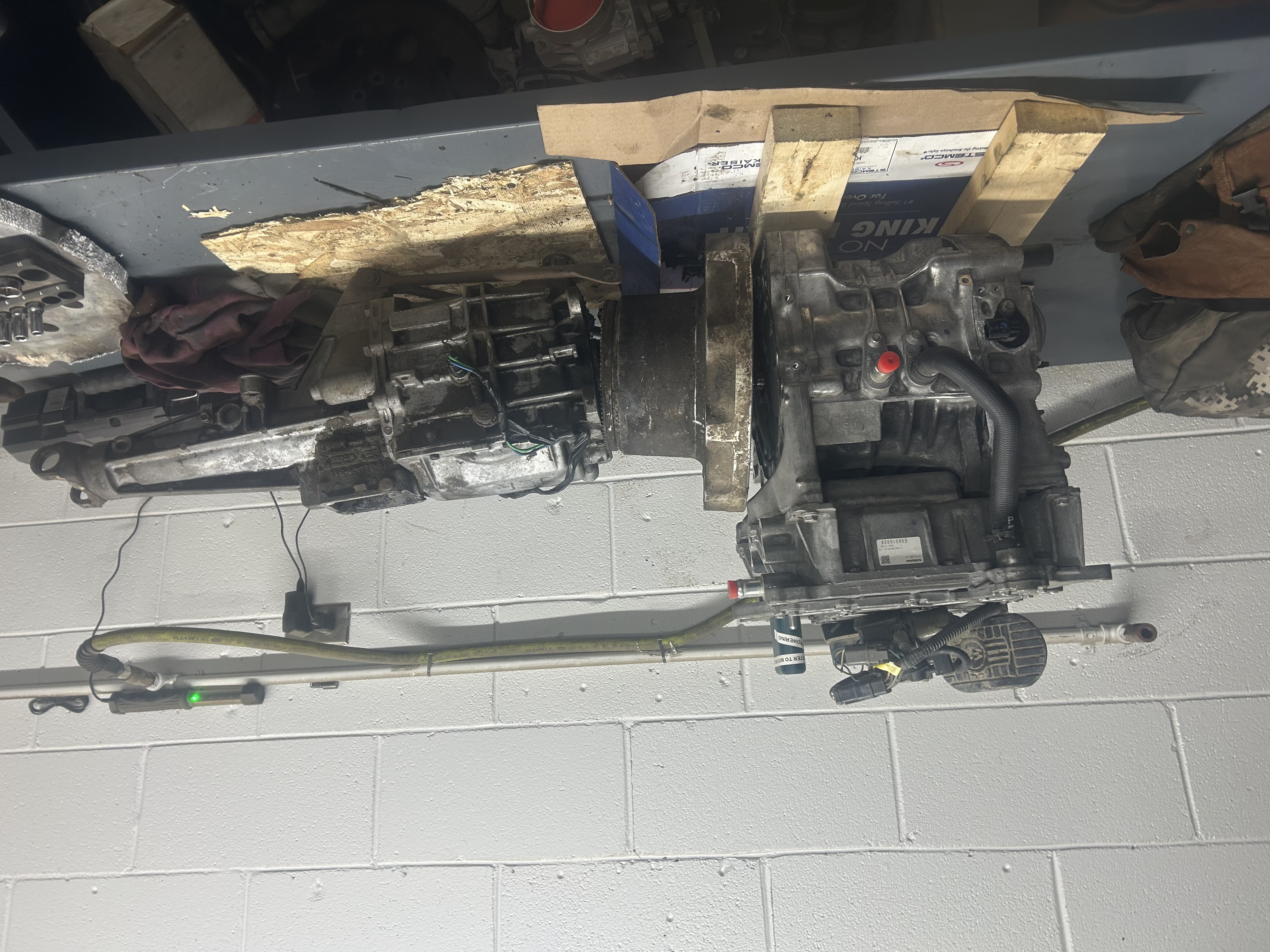

I just ordered a Nissan leaf’s motor from one of the other members on this form. It is a gen 2 Nissan Leaf. The previous owner all ready has the openinverter drop in board installed and operational. I am planning to mate it to the 5 speed transmission that is already in the truck. Also I have a friend that can set me up with an electric vacuum pump that hopefully can run the brake booster. Other than that nothing else is decided.

I think it would fit but I am not sure. A full stack was my original idea however the motor I am getting does not come with the PDM. Also it already has a drop in board openinverter board. It may end up costing just as much but right now I am planning on running a different brand of charger. Do you have any recommendations for chargers and BMS systems?I have followed some of your builds and admire your work. I might be looking for some mounting plates at some point.

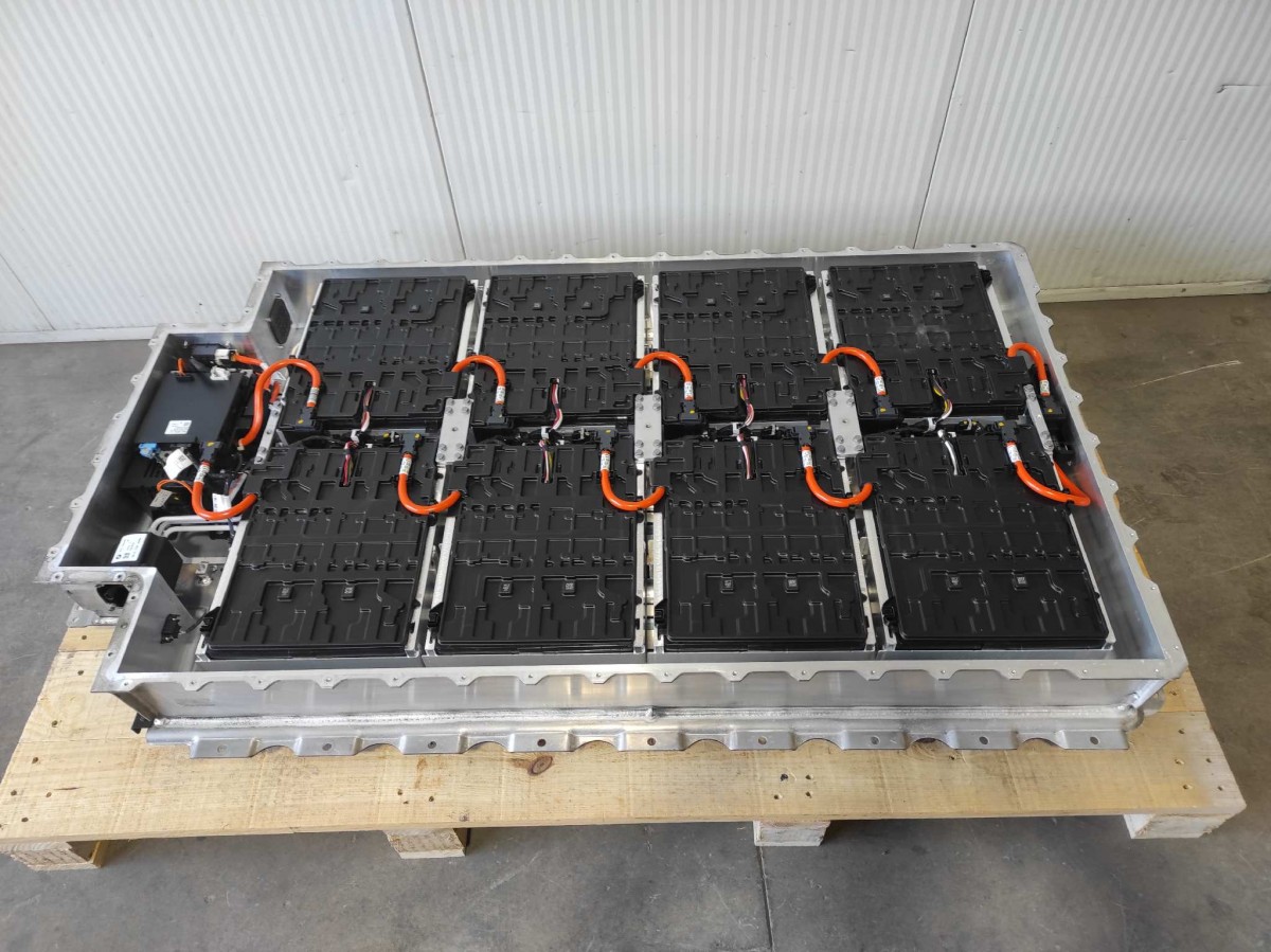

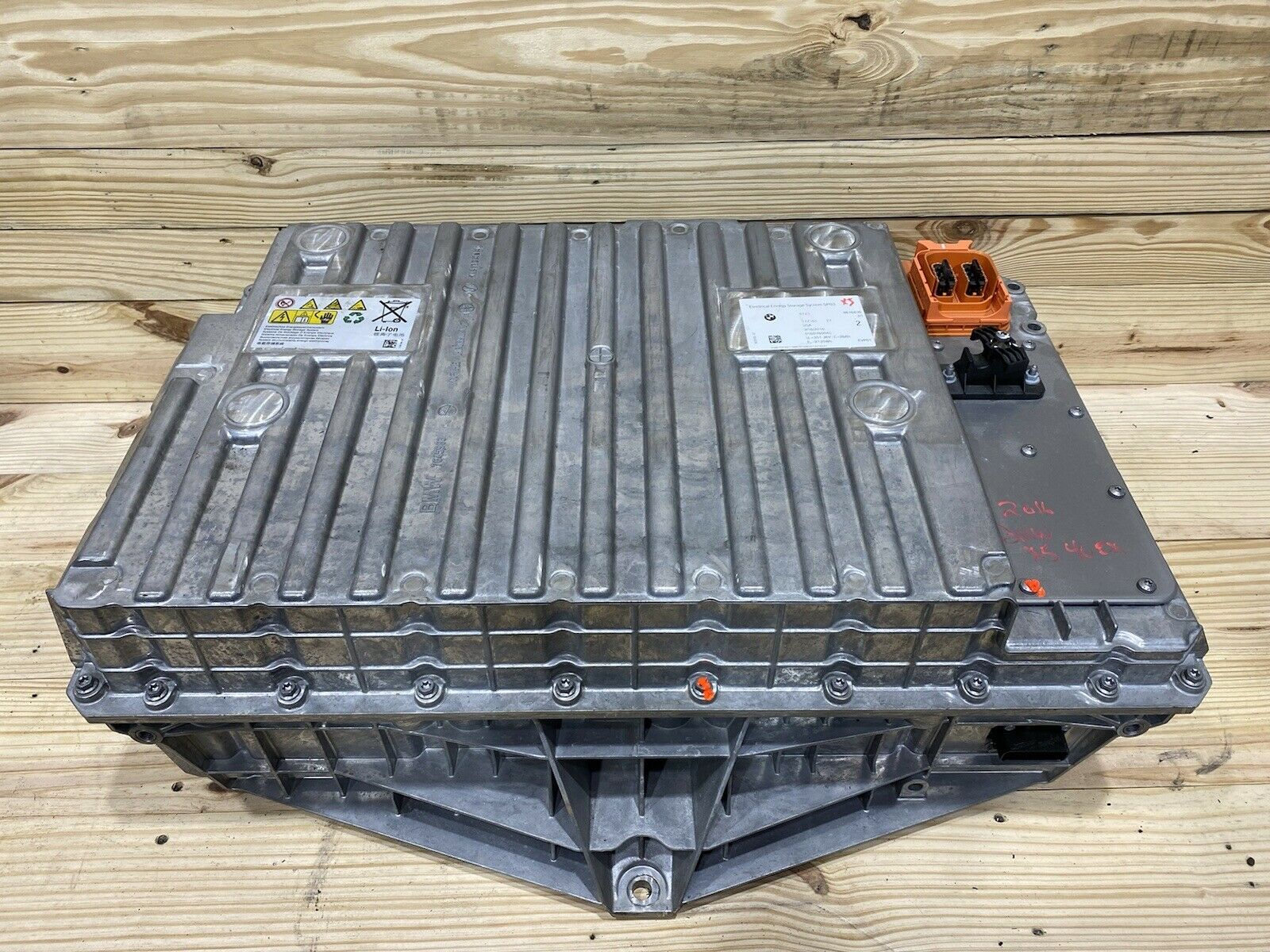

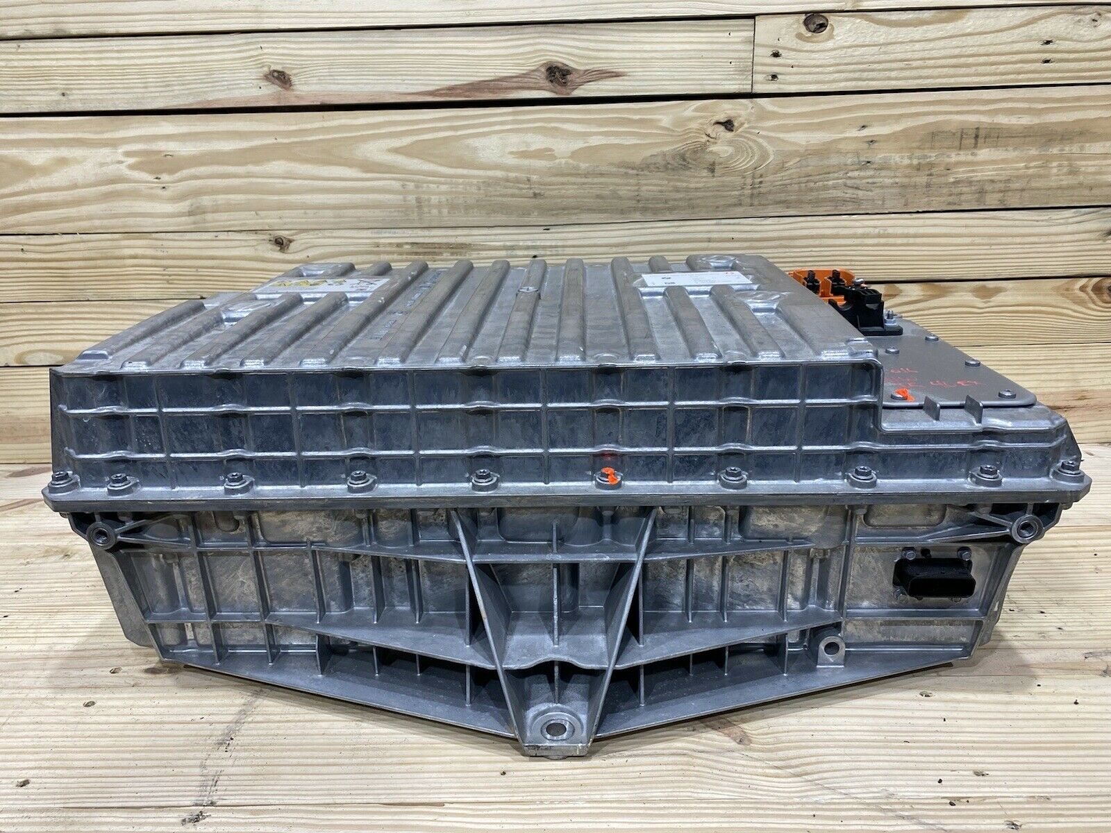

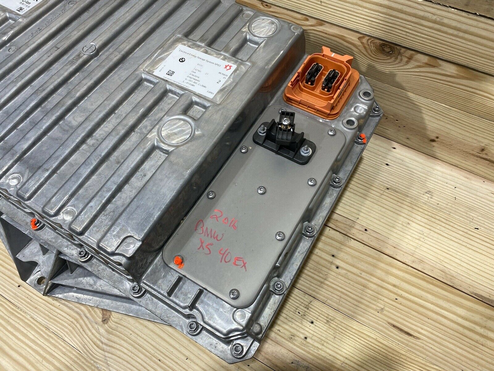

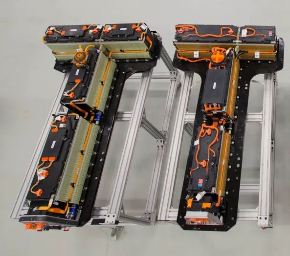

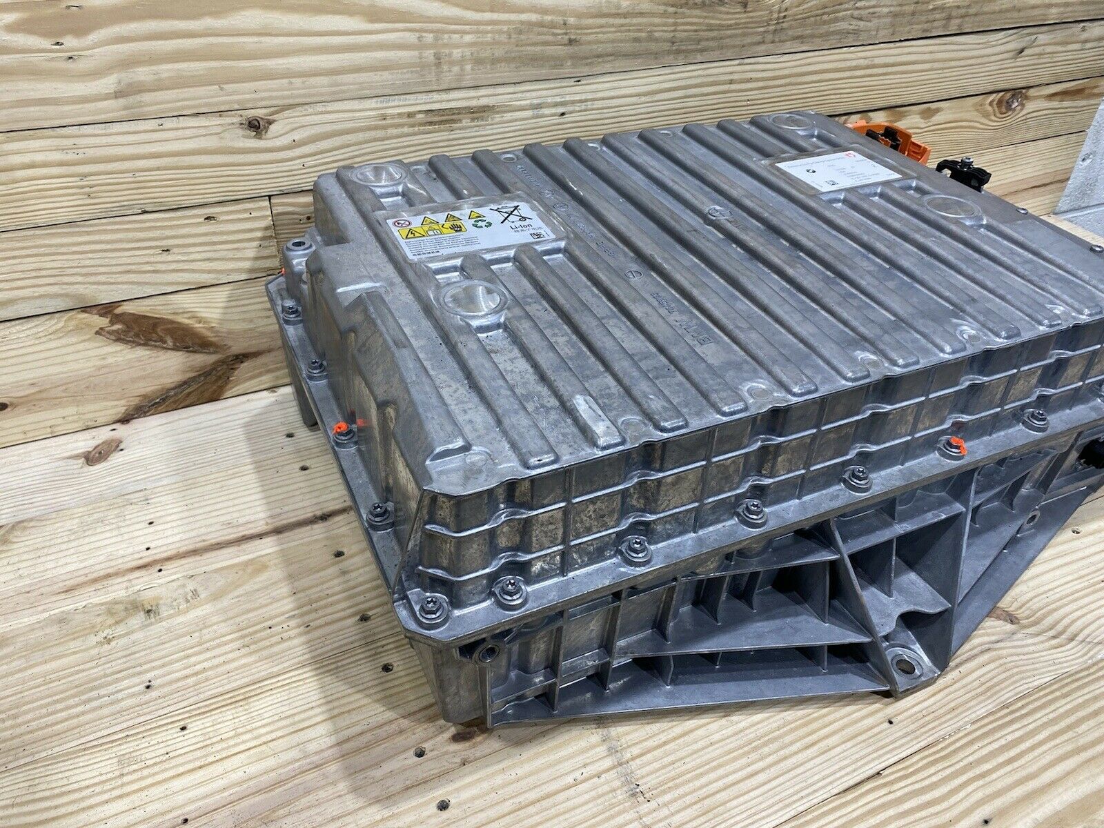

Are you sure you want to use a Chevy Volt battery pack, they are so small by today's standards at only 16/18 kWh and have that odd T shape design, also once you break the modules apart they are of like 3 different sizes, consider throwing a 42 kWh BMW i3 battery pack in the bed of that truck and calling it good

I have definitely considered the i3 pack. I think it would be awesome to do like Jonny 5 did with his Hilux and just put it between the frame rails under the bed. Such a clean build! Honestly the biggest reason i don’t go that way is price and availability. I think I found a volt battery for $700 + taxes and shipping. I think the i3 were at least double that and a lot further to ship. Also because I am keeping my drive shaft I don’t think I could fit a square pack between the frame rails. I would need to make boxes beside the drive shaft. The other thing is that 99% of the time I think 16kwh will be enough. The truck will very rarely do more than 20km a day. Honestly my dream is one build a quality sodium ion battery for it. I live in Canada so we have some cold days. If they can handle the cold better that would be the dream.

there are also some BMW battery packs that are saddle-shaped as if to bridge a driveshaft through the middle, and i had considered using them for that same between-the-frame rails while dodging the driveshaft application. have you seen those? the one i was looking at is called the SP41 from a 530e. Here's a video showing it: https://www.diyelectriccar.com/threads/ ... 43/page-15

As someone who has used several Volt packs (originally built the '40 with two 1st gen and then swapped for two 2nd gen), I'd caution against it. They are good for what they are good at (very tolerant of high power demands, for relatively cheap) but they are a bear to fit into a car, have been finiky when it comes to isolation, and I've seen more degradation than I would like with them. If this was my build, I'd look for something else.
I would also add this: In my opinion, you should build in more range than you think you'll use. Its real easy to start out thinking "I'll only need this much" but then want to take it to this place, and realize that's a stretch. Or want to take it to this event, but then its a pain, or decide what the hell, lets roadtrip the thing, and realize how much time+stress charging can add. Whether road tripping, or just driving regionally, you will probably find that there are times where your range makes you more anxious than you need to be. I'm not saying it need to have 200 miles of range, but I am saying that my car with 65 miles of range, which I've taken on many long road trips, still makes me anxious just driving around regionally. I would say a conversion should target at least 100 miles, just to provide a nice buffer for a day out and about.
I'd say all of the above suggestions are decent, but so is the Bolt, or a Model 3 pack, both of which are really falling in price.

Thanks so much for sharing your experience. It is good to know the Volt is not a great option. I definitely get that longer range would be nice. I have already been thinking about making a 500km drive with it once’s it is mobile but not sure if I can make it work with the charging that is available.

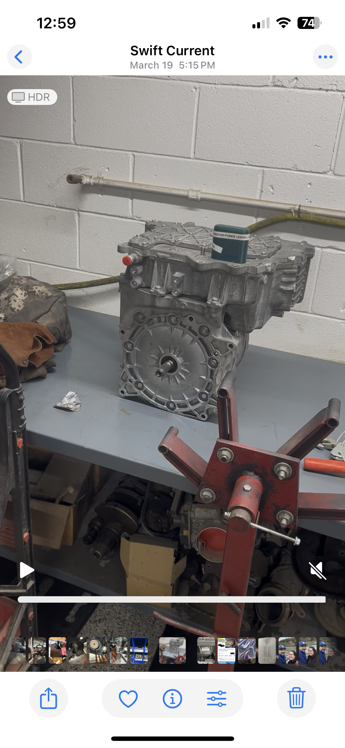

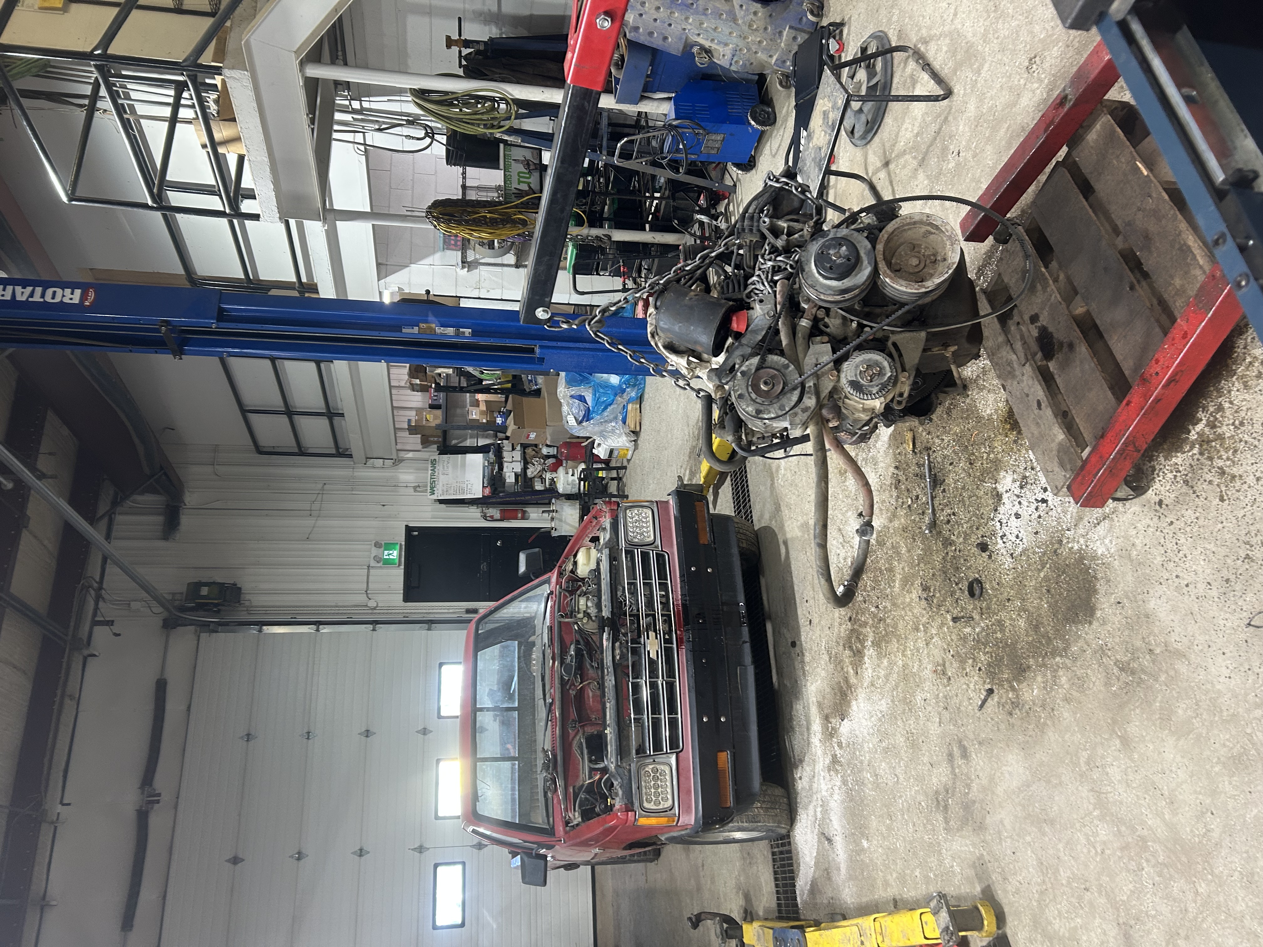

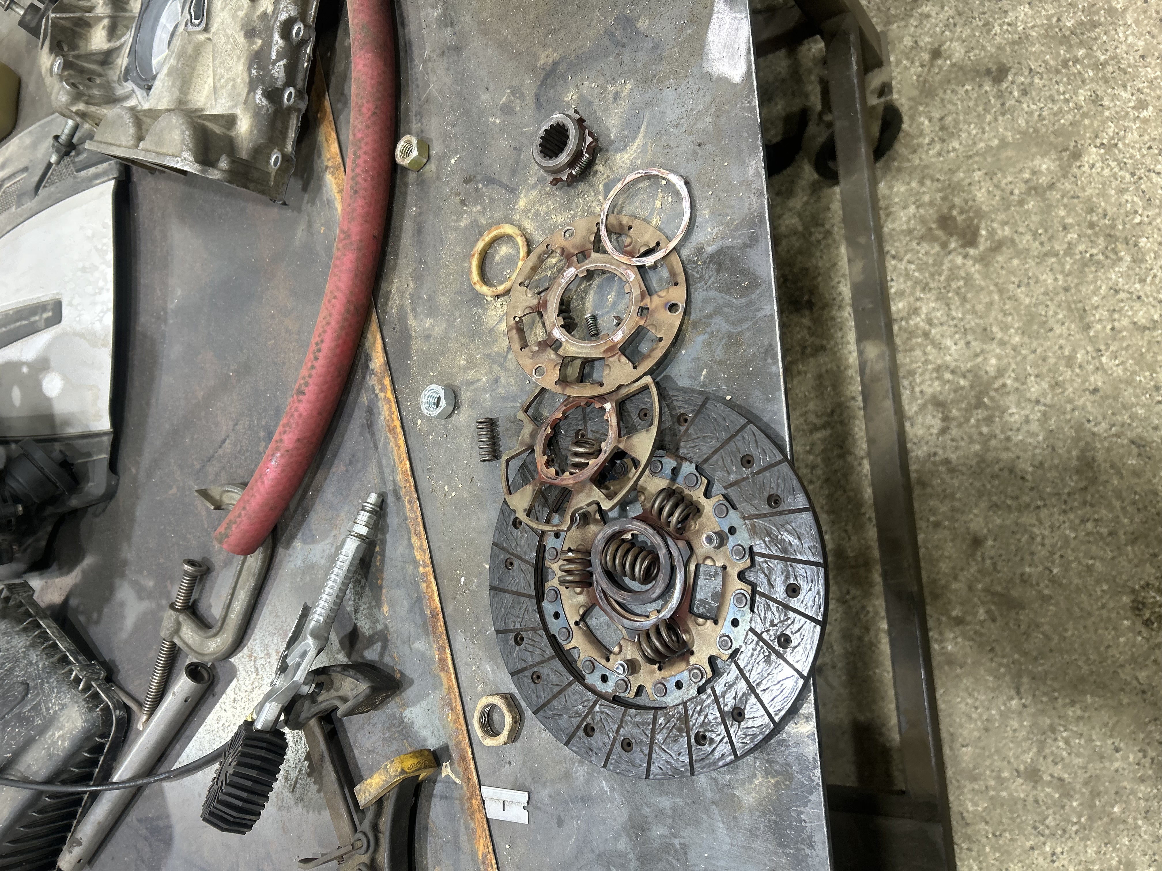

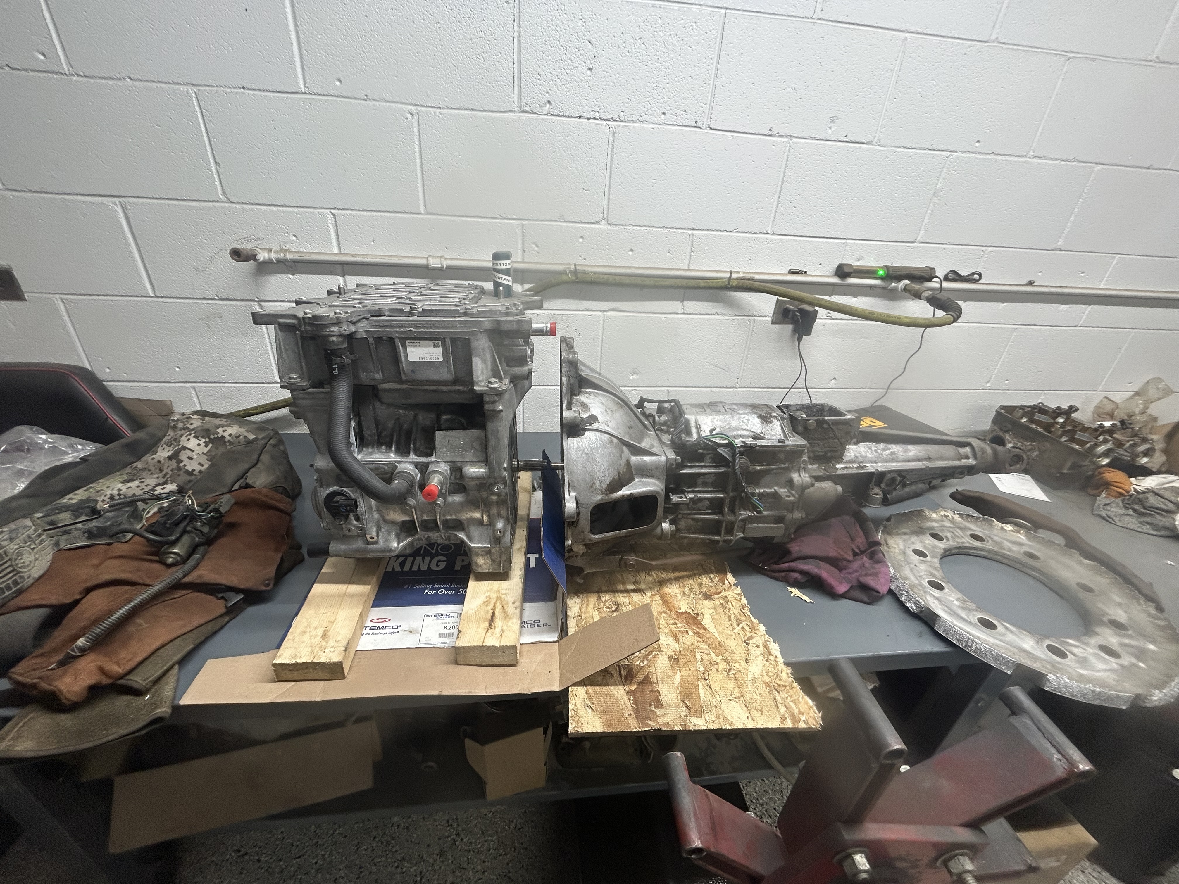

Here is my latest update.
I got the ICE motor pulled. The clutch torn apart and I am starting to work on the mounting plate. Oh, and my electric motor showed up. Thanks Zieg

Working on getting an adapter mocked up. I was thinking of buying the set up from Brat Ind however the money I have to spend on the project is a bit tight. I was able to find some scrap aluminum around my work place and I am going to see what I can make.
Re: The Rusty S10
Here is what I am thinking for mounting plate. I work at a truck shop and I found a damaged aluminum wheel hub in the recycling bin. I am thinking to get rid of my belhousing all together and replace it with that. What do you people think?

Re: The Rusty S10
As long as everything ends up concentric and straight why not!
Do you have a way to true both matting faces?
Re: The Rusty S10
Hey. Honestly from factory it should be pretty good but I will have to see. So far my biggest concern is that the flang on the hub won’t catch all the bolts. Just curious with your adapters is there any adjustments that needs to be made to make sure everything is lined up or can you pretty much bolt it up and everything should be aligned. Obviously you need to get the coupler made but other than that, I guess.
