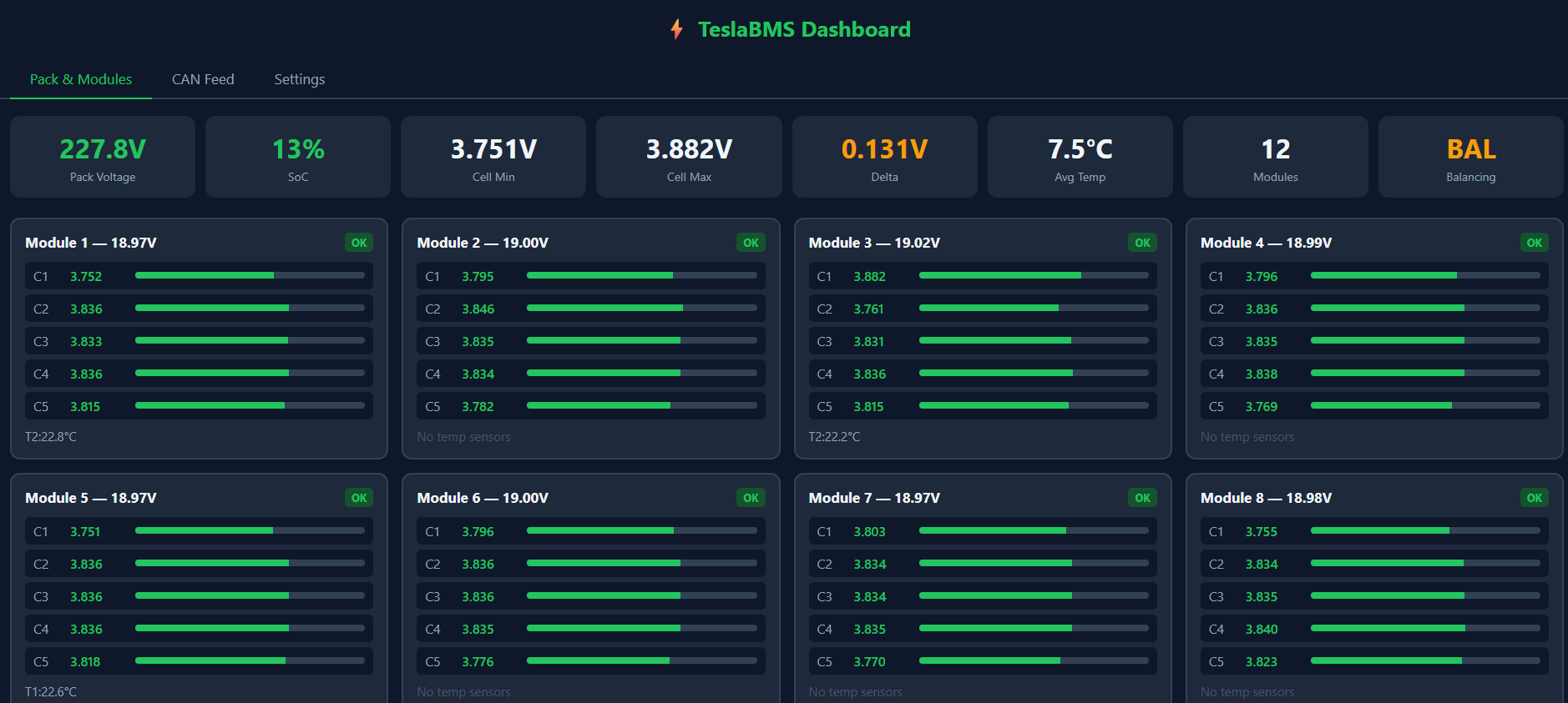

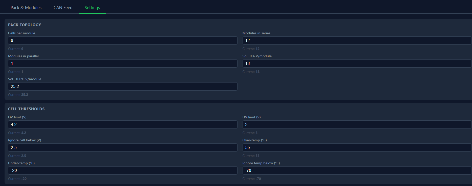

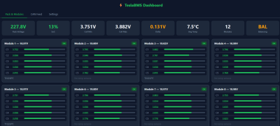

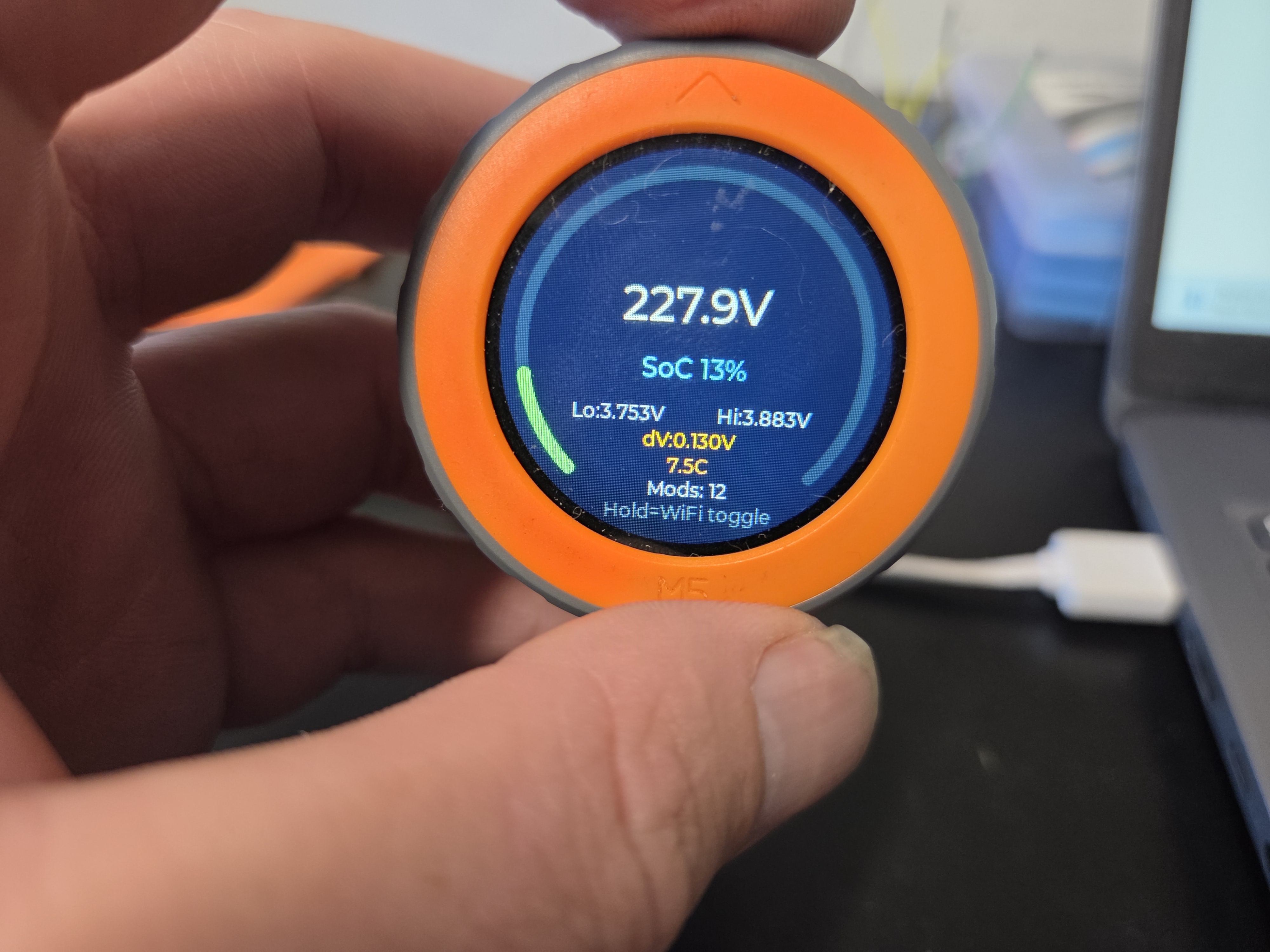

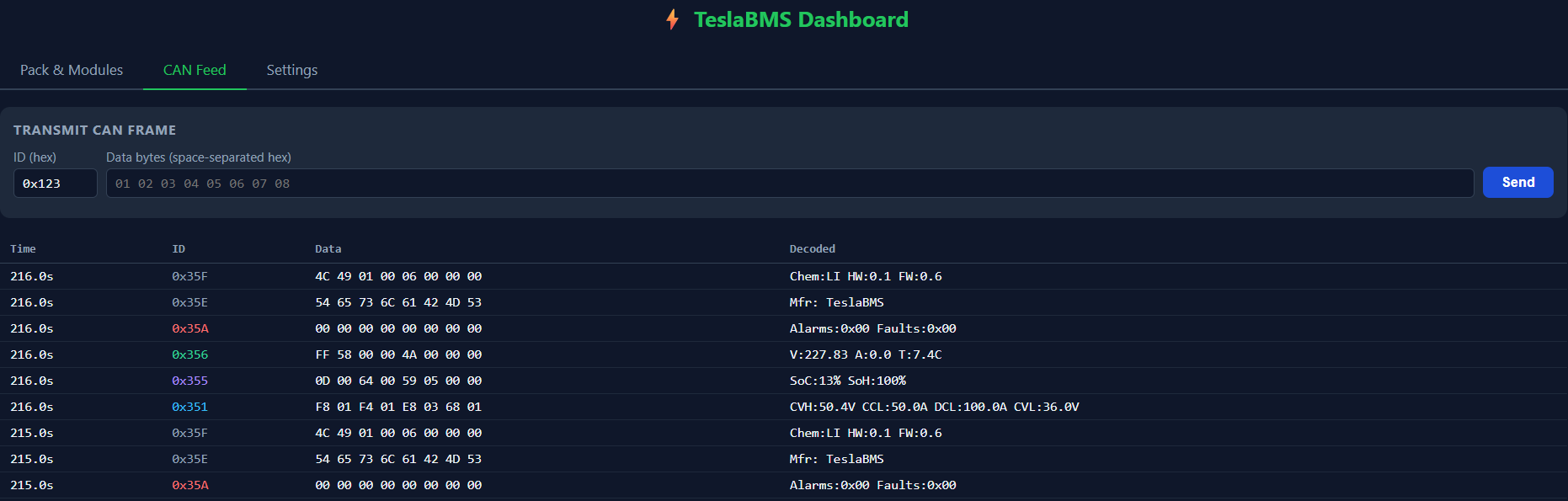

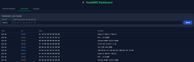

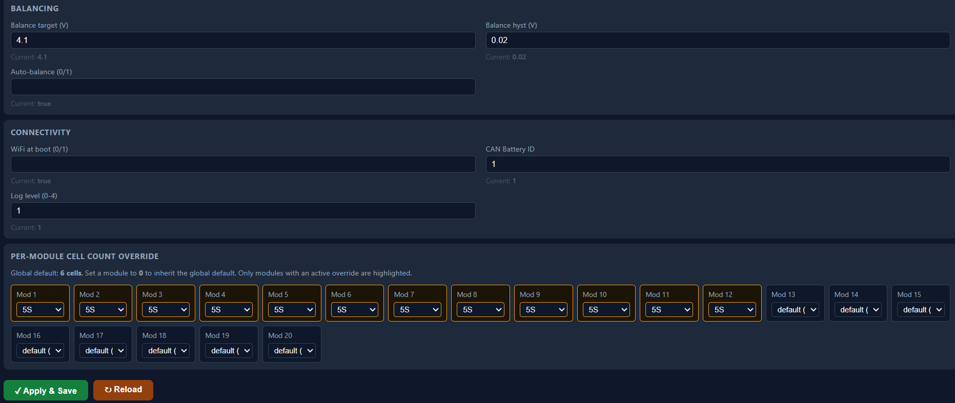

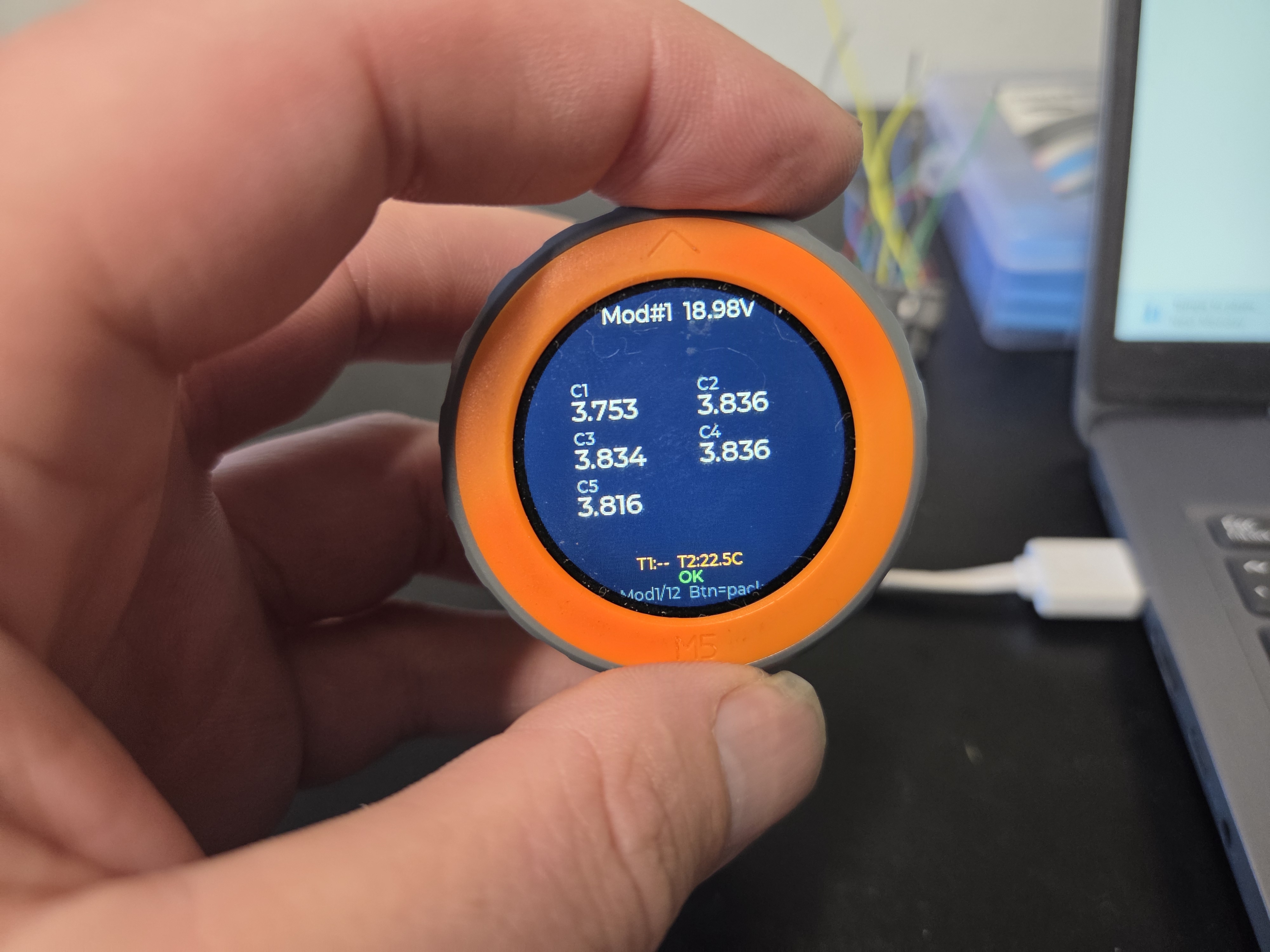

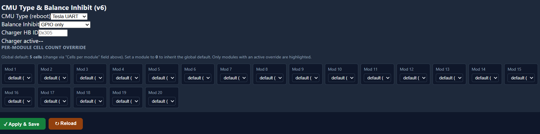

This is a port of the simpbms code over to the M5Stack Dial (ESP32-S3) with the help of Claude. Many thanks to the original creators. It supports cell monitoring and balancing with CAN output to work with zombieverter. Testing validated with Tesla Model S BMB/CMU's connected to Chevy Bolt 10S modules (2 Tesla CMU's configured as 5S ea). Balancing appears to work but need to validate over time. Code is ported for BMW i3 but not tested.
Cell monitoring on dial as well as via web interface.
Hardware needed is M5Stack Dial + CAN XCVR. It works as-is with Tesla modules, but the 5V Tx output from the CMU may damage the 3.3V ESP32-S3, so a simple voltage divider with 2 resistors or a level shifter board may be best for longevity.
All files, operating manual, porting summary on github:
https://github.com/robertwa1974/M5Dial-BMS

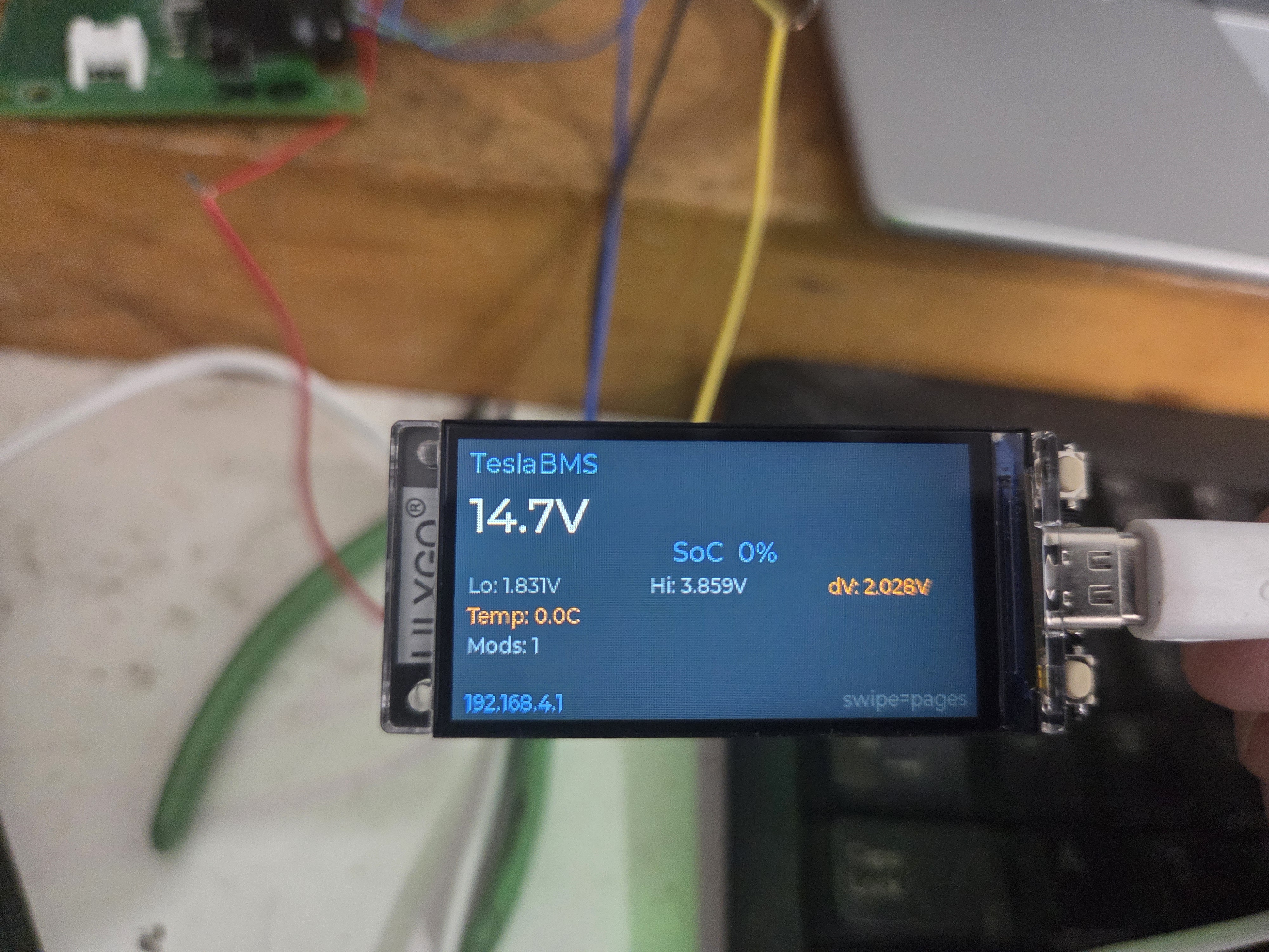

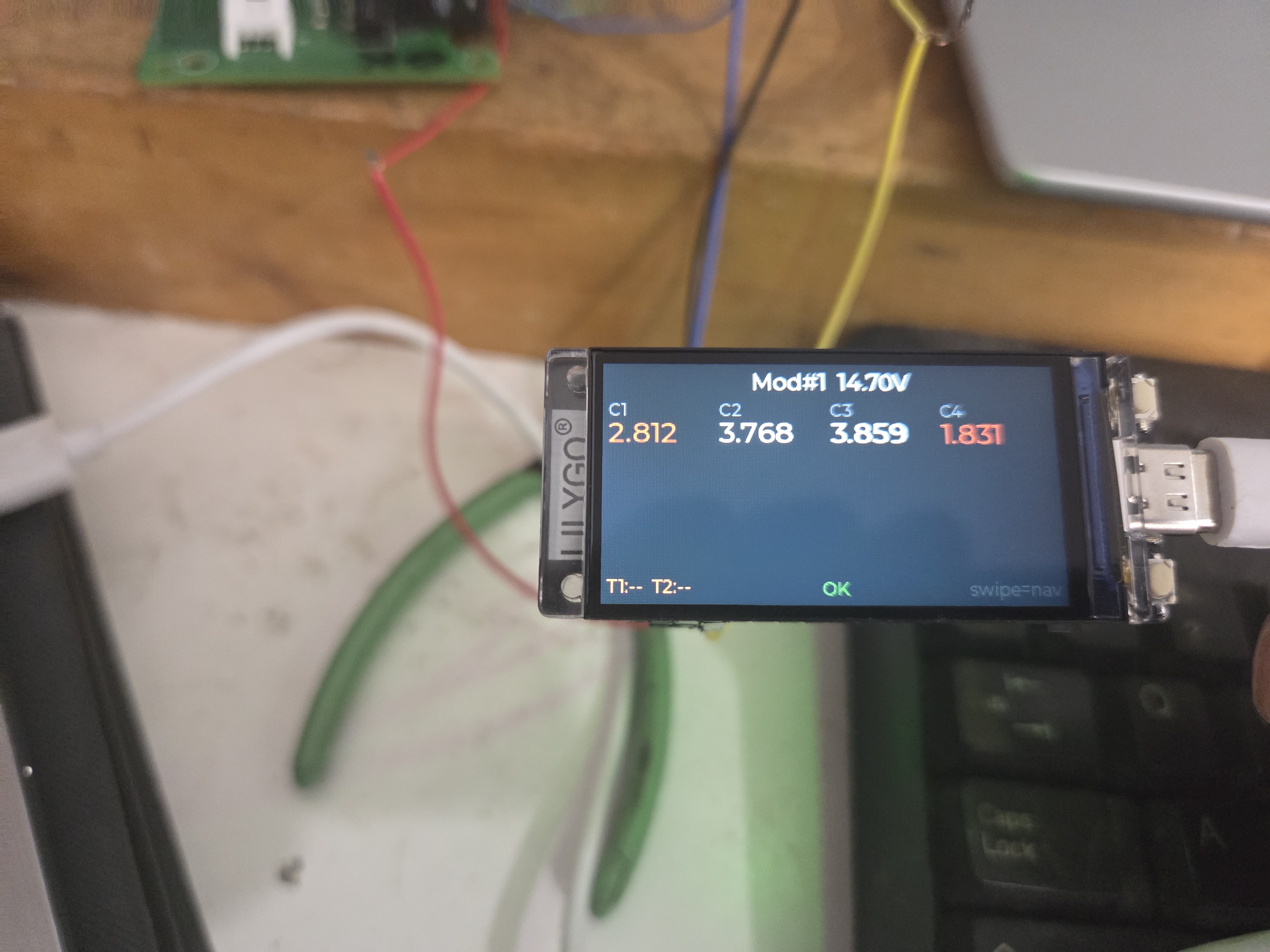

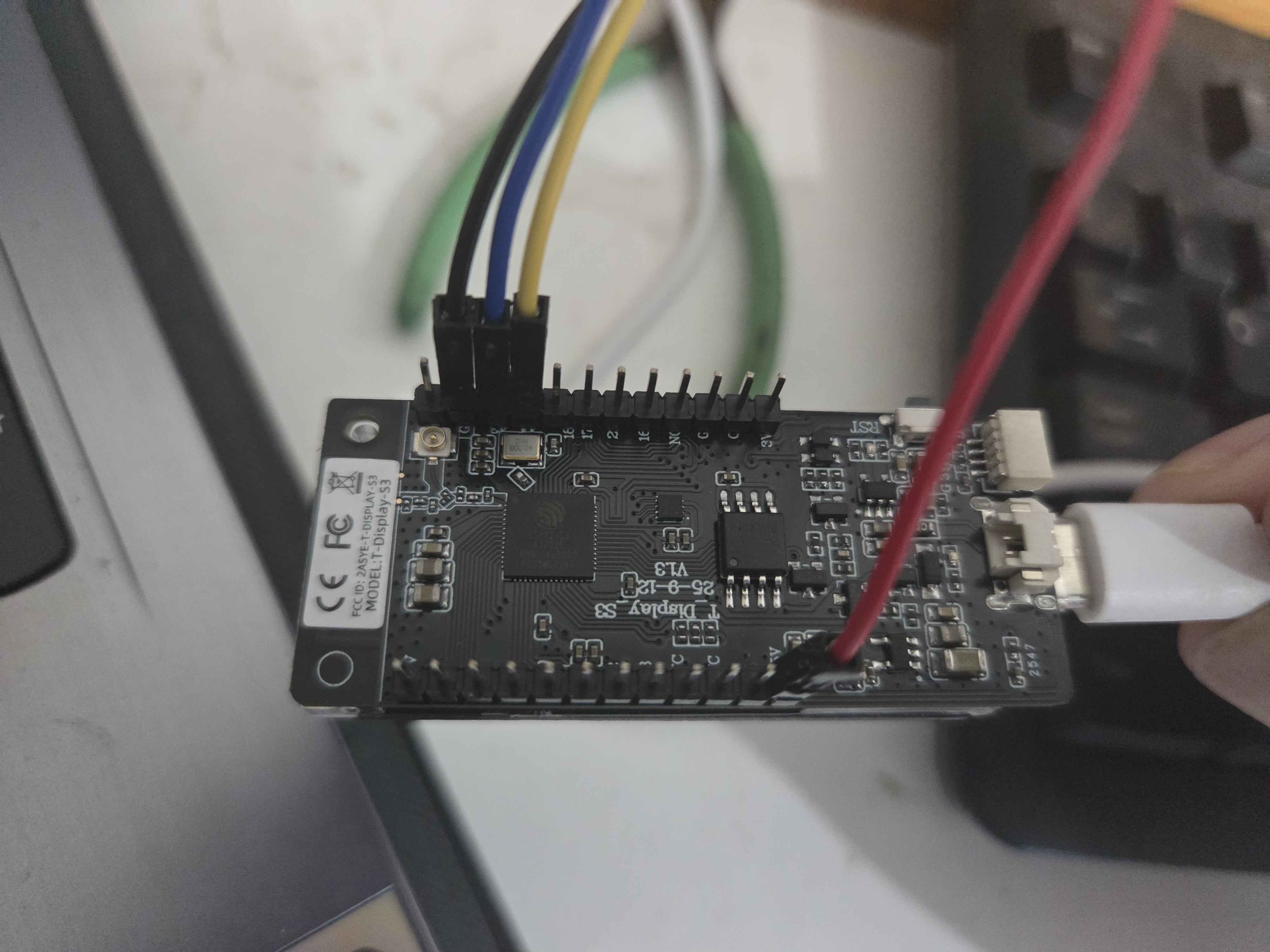

Built a slightly different version running on the Lilygo T Display S3. Same functionality and wifi interface
