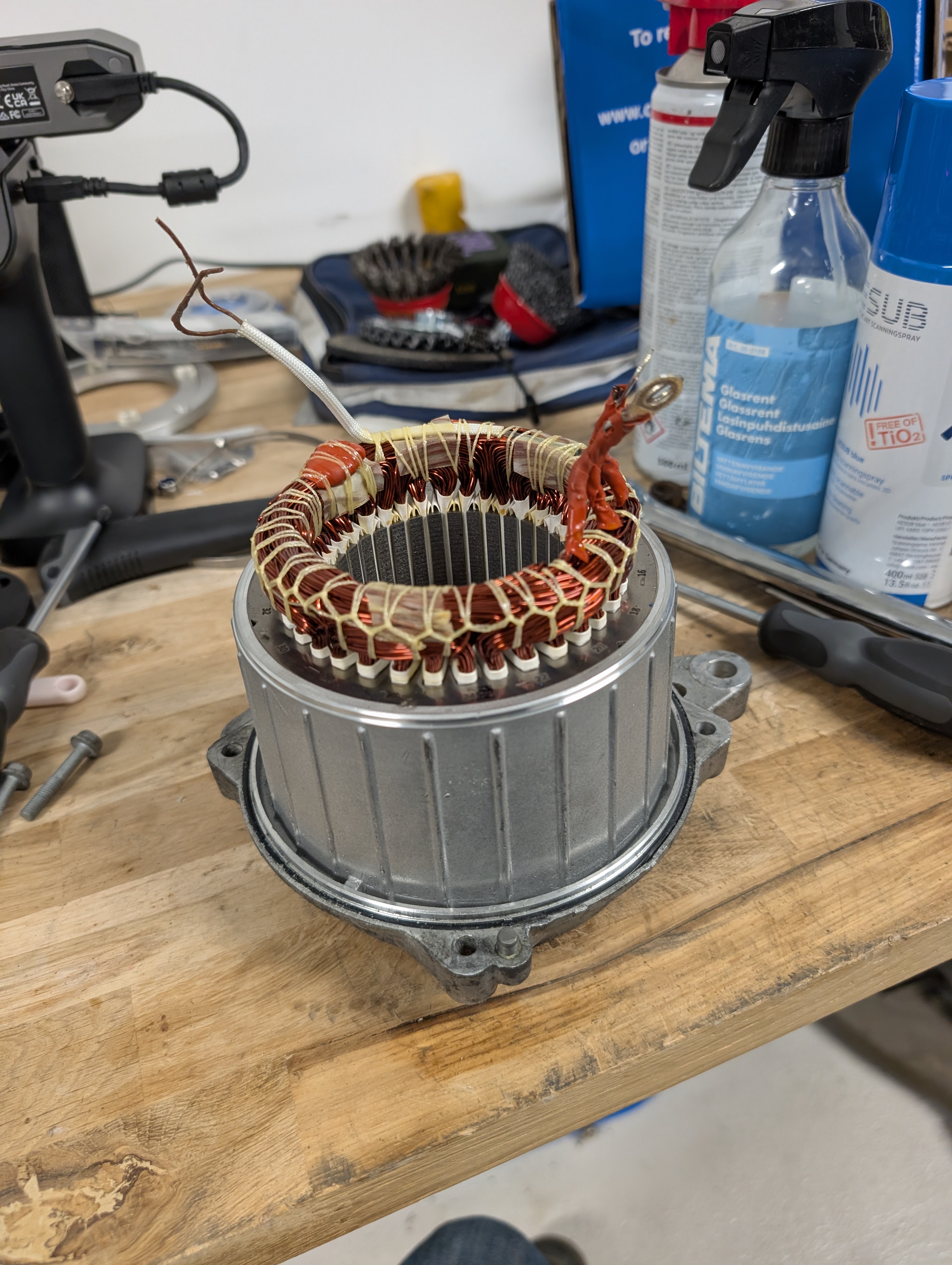

Took a Kia HSG apart, figured someone else might be curious to see how it looks inside. And I wonder if anyone has any idea how to get the stator out of the waterjacket and casing?
Stator with the waterjacket still attached to the front of the casing.

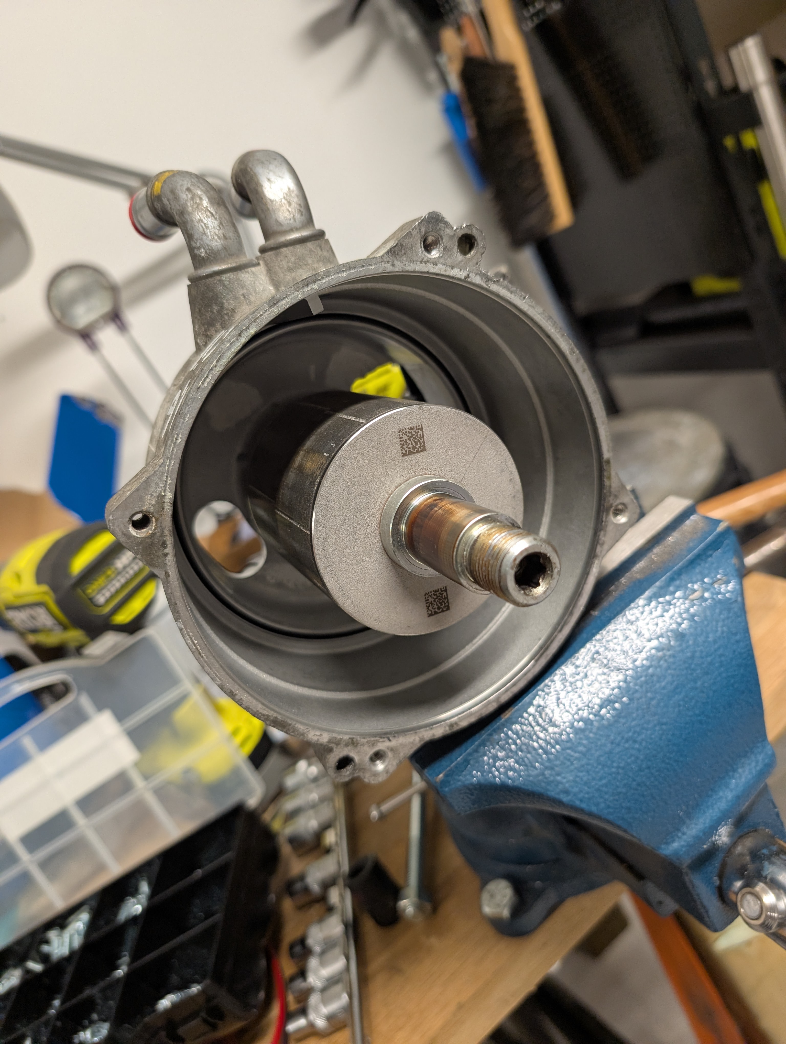

Rotor in the rear casing.

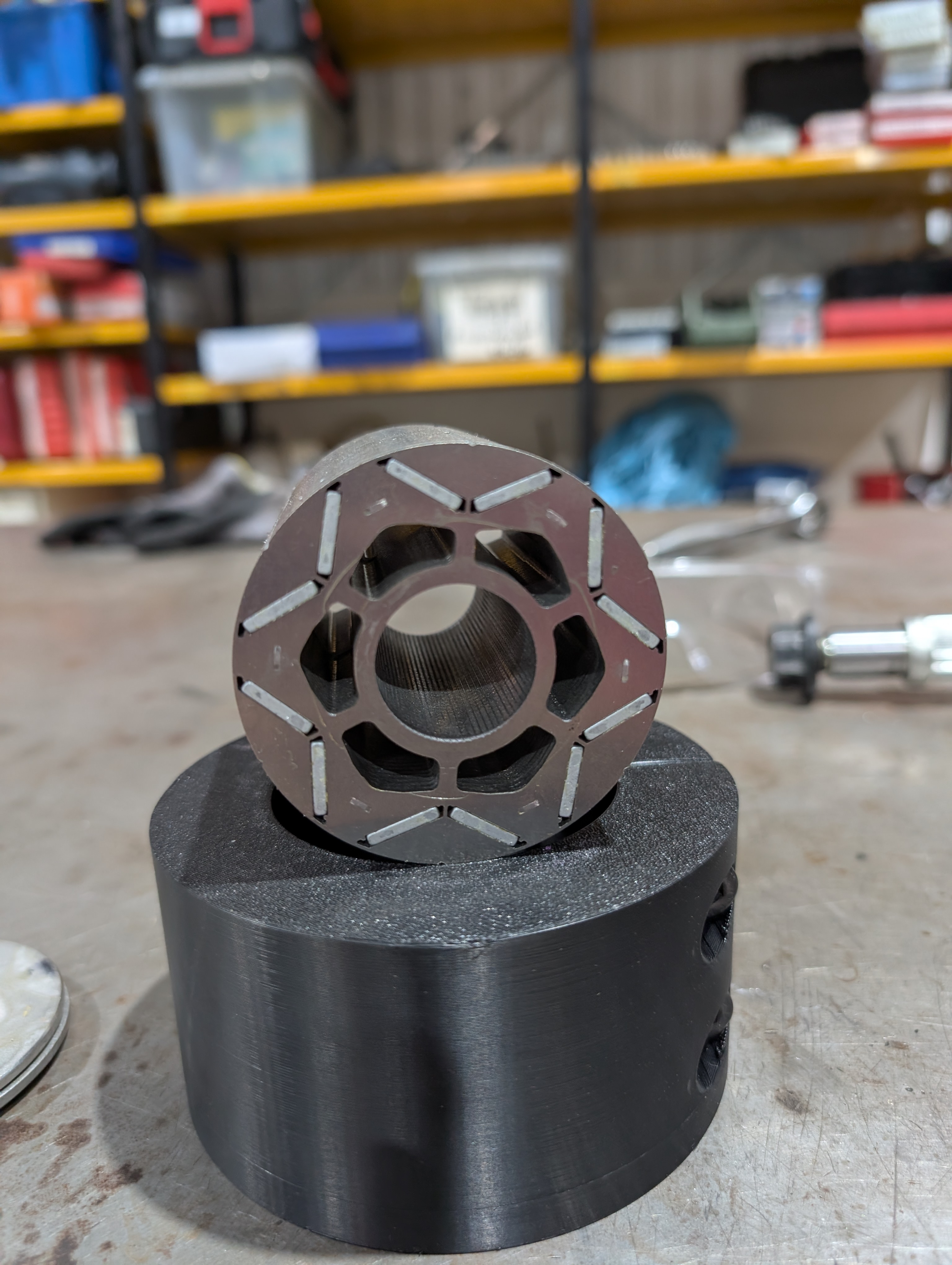

Rotor without its shaft.
