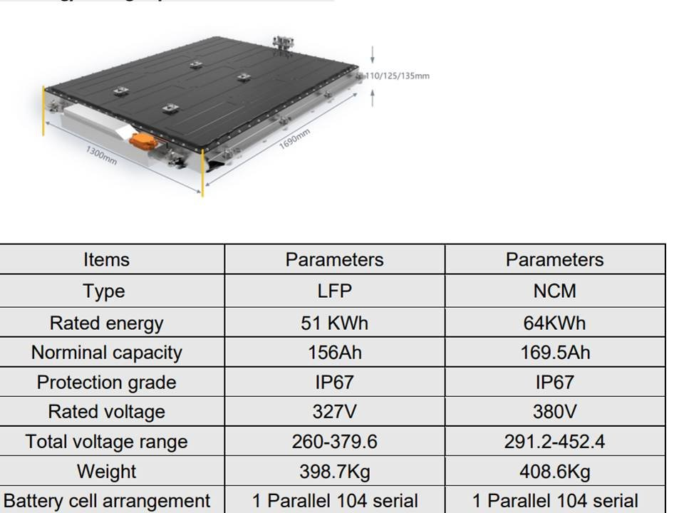

Put a low ball offer in on a 51kwh pack that got accepted on one if these cell to pack Rubiks batteries.
Made by Saic I believe.
Does anyone have any information on them? Pinouts or anything similar?

There is a world of information and instructions on http://www.siteguru.co.uk/MG4/Manuals/
I found it on Forums AEVA https://forums.aeva.asn.au/viewtopic.php?t=8556
Some battery teaser as well
