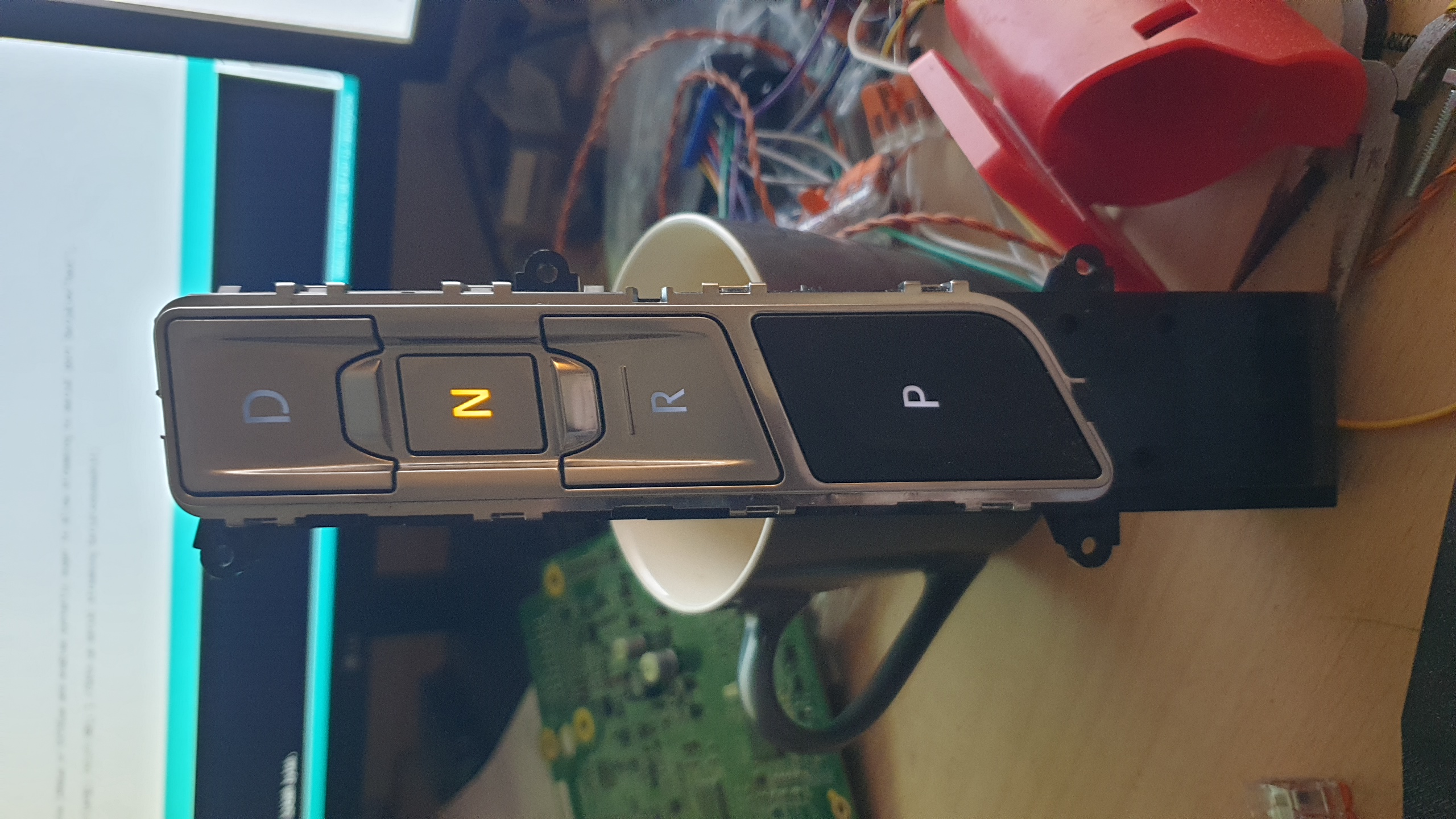

Jaguar iPace gear shift module (GSM) hacked and working on the bench. Simple arduino sketch attached to run it from a due. Will be implemented in Zombie soon. Happy gear shifting in your Jaaaaag.

Any chance of some rough dimensions of these? Cheers

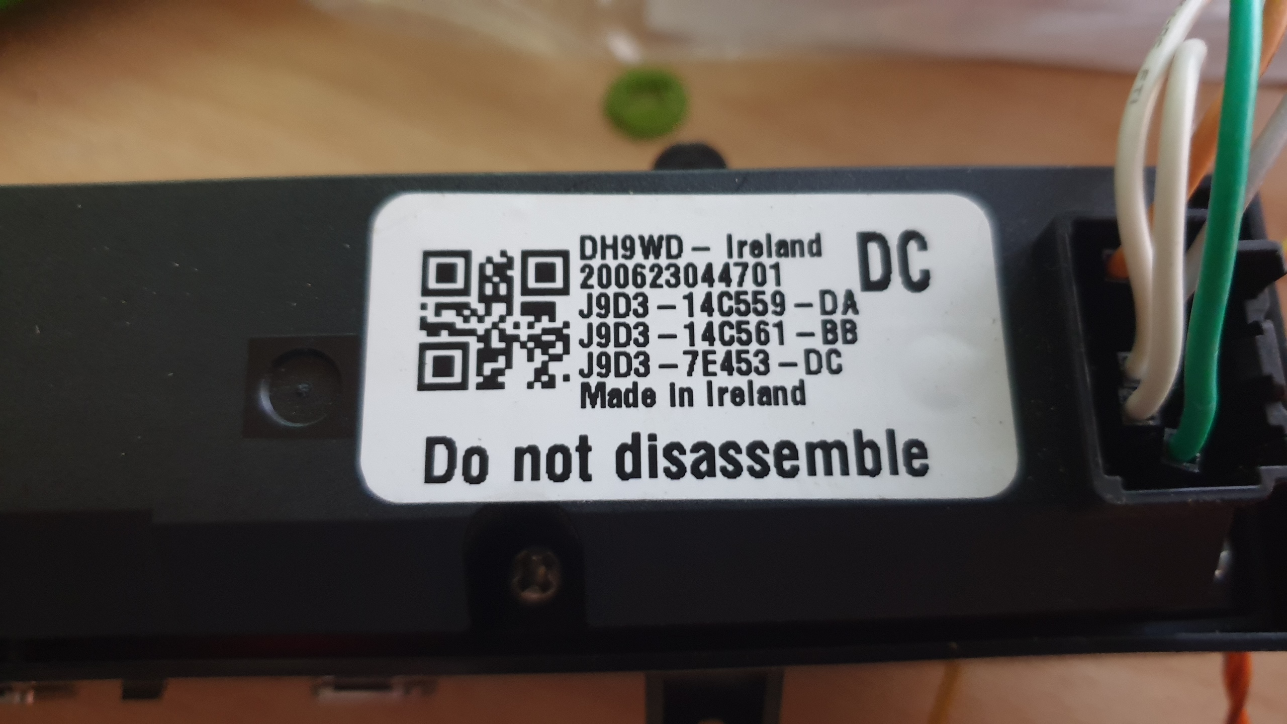

looks good, any info on plug used for it ?
