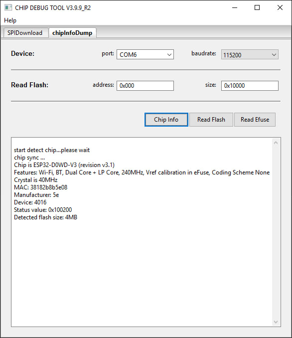

Now, open flash download tool (FDT in short), set prog-gnd jumper and connect your adapter to SDU board.
Give power to SDU and make sure that you can read chip info from FDT.
If everything is wired good - you will get data. Now open SPIDownload tab, select esp32-web-interface.ino.merged.bin, set write offset to 0x0 and hit START. Wait till process is done.
Remove prog-gnd jumper and restart SDU power. Connect to adapter with arduino IDE/
If everything is good - you will se error E (167) SPIFFS: mount failed, -10025
It means that firmware works, but has no SPIFFS. I you connect to wifi and open 192.168.4.1 - you will get file not found error.

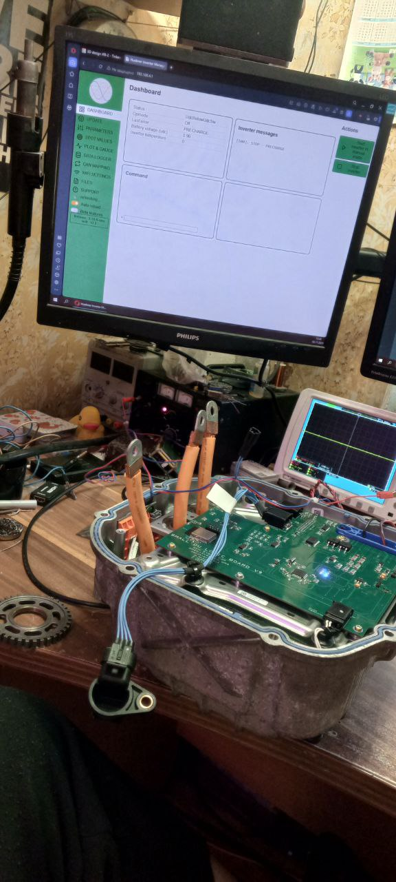

Ok, finally got to testing of SDU. Doing Damien's V9 board so carelessly was a mistake. Nothing died in process of testing the actual device, but I had to replace 90% of the resistors because V9's schematic had almost all values set to 1k, and I was too sleepy and too hot-headed at the same time to actually check the logic behind them. V8 schematic also shared the same mistake, but V8's BOM has correct values, and difference between V9 and V8 is very small. I also compared values to V6 just to be sure. Not a problem for now because it seems that Damien deleted revisions V7 to V9 and started KiCad redesign project. So you can't simply download schematics with wrong resistors now.
After replacing all wrong resistors I was able to start inverter without any errors and got correct voltage, current and temperature measurements.
Phases control signals also look good here, and encoder input levels now look good. Tested on low voltage PSU at home:
FW is latest release 5.39 from git.
Stupid error of mine, but now I know more.
Still need to test it with motor itself - got no spin because all sensors provided wrong readings and filters were not working the right way. But will try to do it tomorrow with fixed board.

Ok, back to testing.
Now, all readings are good. But i only have weak and somewhat stuttering spin with high jumping current.
Phases are good - checked phase-to-rail and phase-to-ground short circuits.
Voltage readings are good - use 50V supply for initial tests. Board currents are also good. Board can properly see encoders (speed graph reacts to manual spinning). Switching A/B makes it worser, but reverts back to original state when i swap phases 1 and 3, also rotation direction changes.
So, initial wiring must be good.
Spinning speed has no corelation with pot turn angle - i use electrobike handle for tests, all pot limits are set the correct way.
Strange thing is that controller starts seding PWM to phases even when I don't touch the handle, or even without handle. All i need to do is start it with hardware run wire - and it somehow tries to start spinning.
I don't know what is going on. HW is all good, but it just lives its own life.
Please help anyone.
Quick vid to get better idea.
Re: A little help with SDU V9 anyone?
Posted: Mon Dec 22, 2025 9:14 pm
by SuppaTenko
Ah, nevermind. I set pinswap to phases 1 and 3 - runs good.
