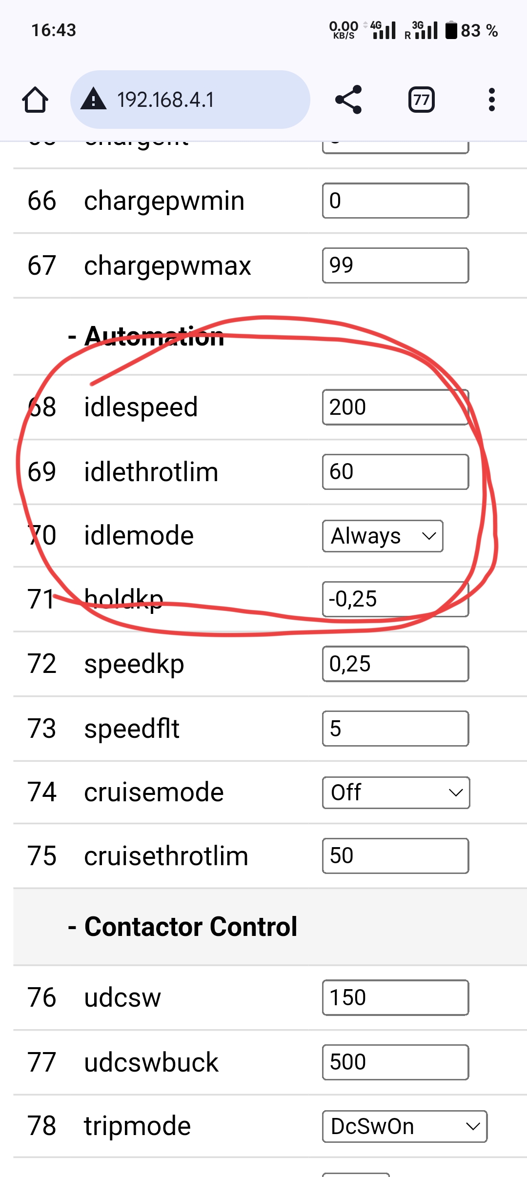

Hello everyone.
I remember very clearly that I used this mode on one of the previous firmware versions, and it always kept the engine running at idle for automatic transmission.
However, today I was unable to start it. I tried pressing the "start inverter" button while holding down the brake pedal, and I also tested the 5.35 FOC, 5.32 FOC, and even the 5.27 FOC firmware. However, I was unable to make this mode work (Nissan Leaf AZE0 Gen2 engine and inverter).
What did I miss for this mode of operation?

Alright, couldn't help it... It works on the latest 5.38 firmware with the inverter in run mode (not manual run!)

I didn't notice any significant differences in our settings, but this mode doesn't work for me.
You have cruise support enabled, but I have it disabled. Could there be a problem in this area?

johu wrote: Sat Oct 25, 2025 9:37 am It works on the latest 5.38 firmware with the inverter in run mode (not manual run!)
I found out the reason why my idle mode wasn't working! I hope this information will be useful to someone in the future.
I had the values of pot2min and pot2max set to 0. Even though I had the offthrotregen setting set to 0, it still created a conflict in the program code, and the mode didn't work. As soon as I changed the pot2min = 100 and pot2max = 4000, the idle mode started working regardless of the offthrotregen setting.
evil neodymium :twisted:
Been thanked: 1918 times
Re: The idle mode is always. Does not work.
Oh, how strange! Thanks for figuring that out.
