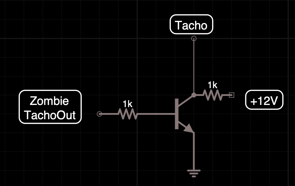

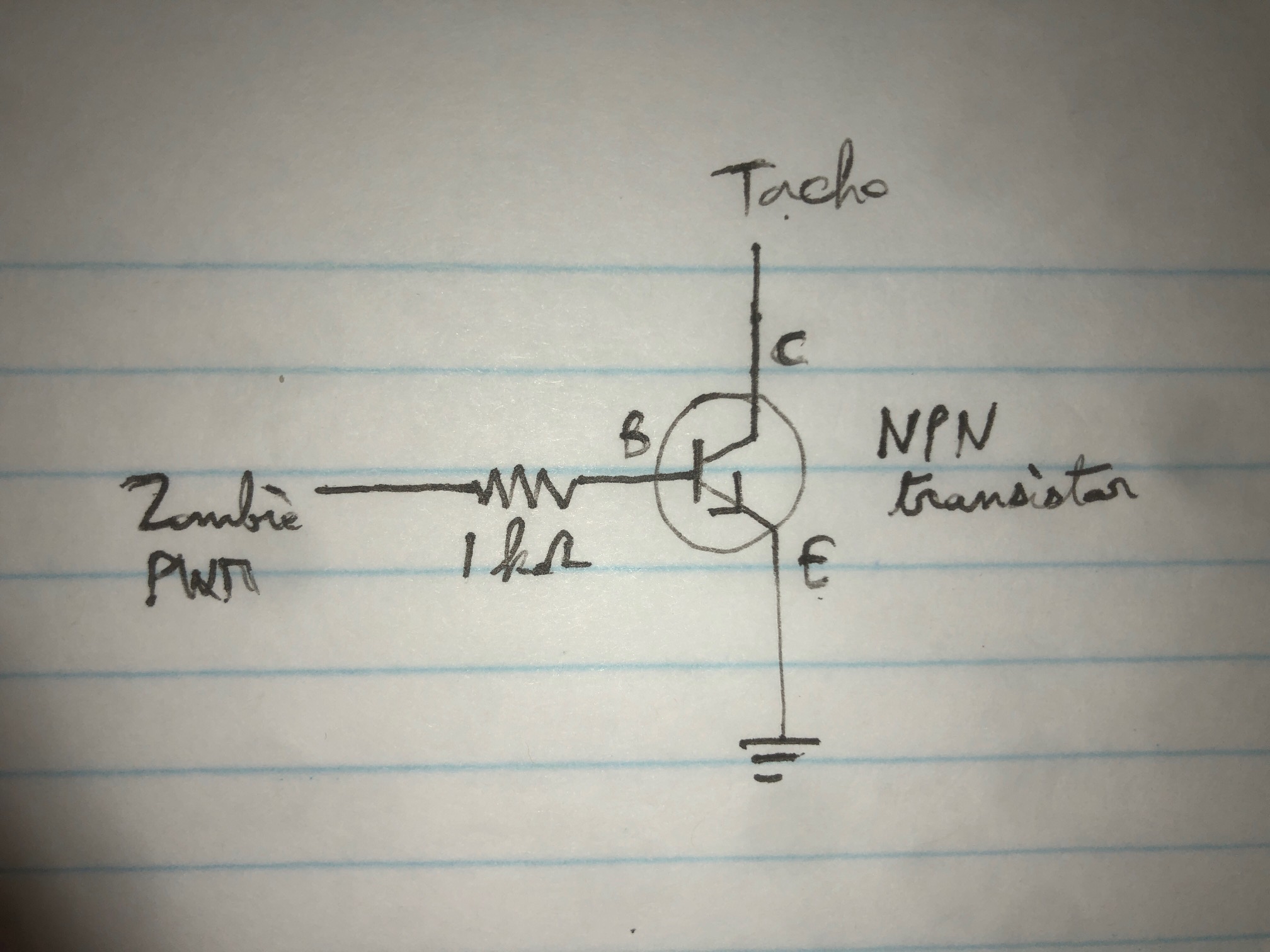

Re: Digital Tacho signal
Post by ChurchMcTruck »

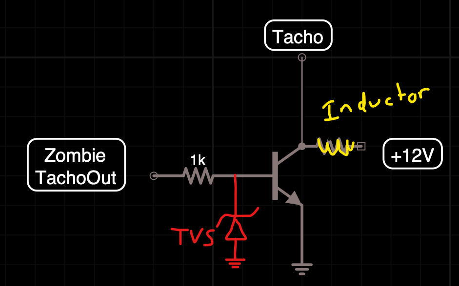

muehlpower wrote: Wed Sep 24, 2025 7:39 am Connect the collector to the input of the tachometer, the emitter to GND, and the base with 1k ohm to the output of the Zombi.
Something like that?
Post by muehlpower »
The pullup resistor to 12V is missing.
New try
muehlpower
Posts: 807
Has thanked: 18 times
Been thanked: 188 times
Yes

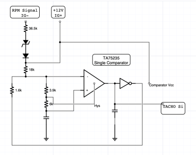

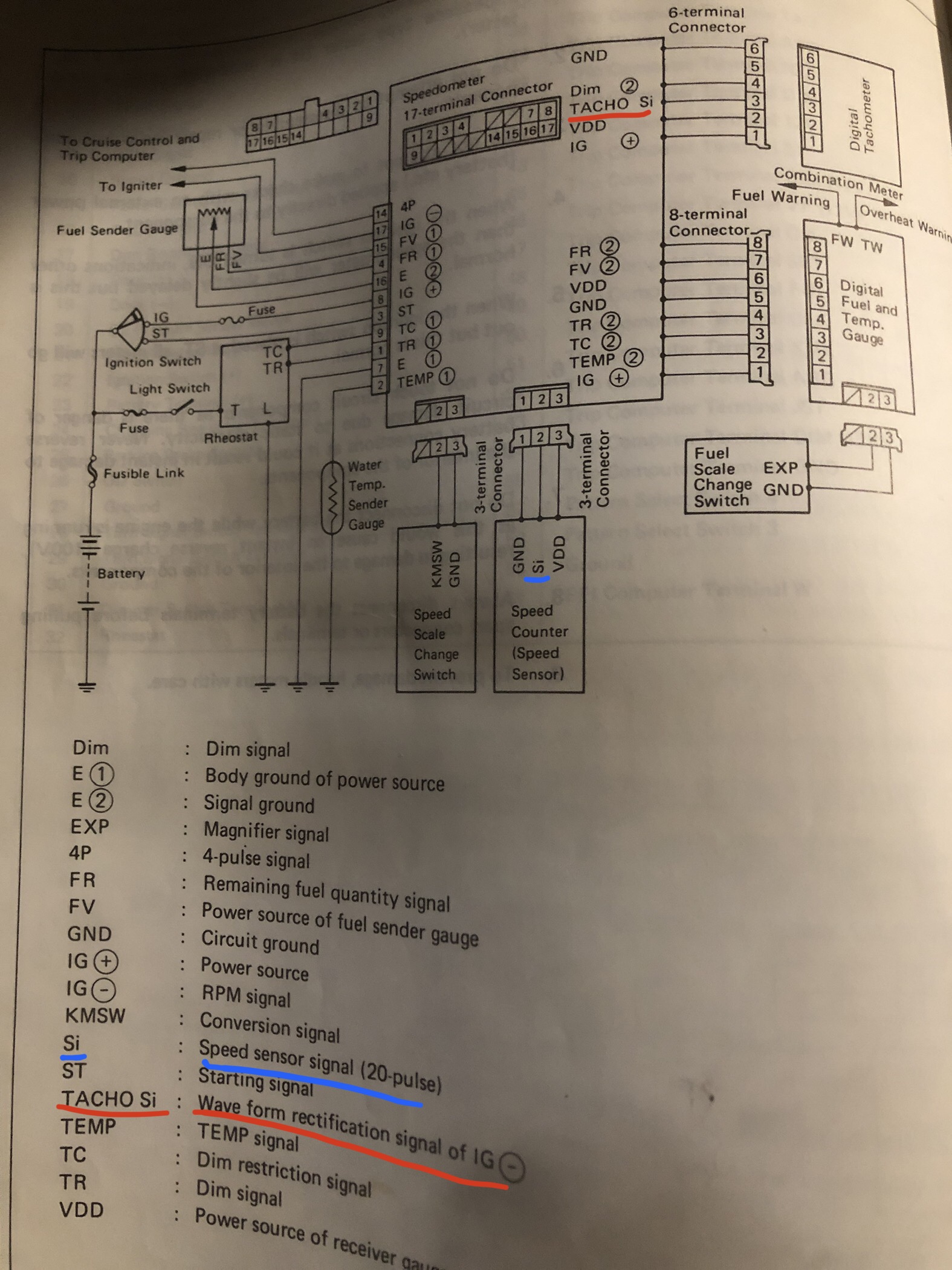

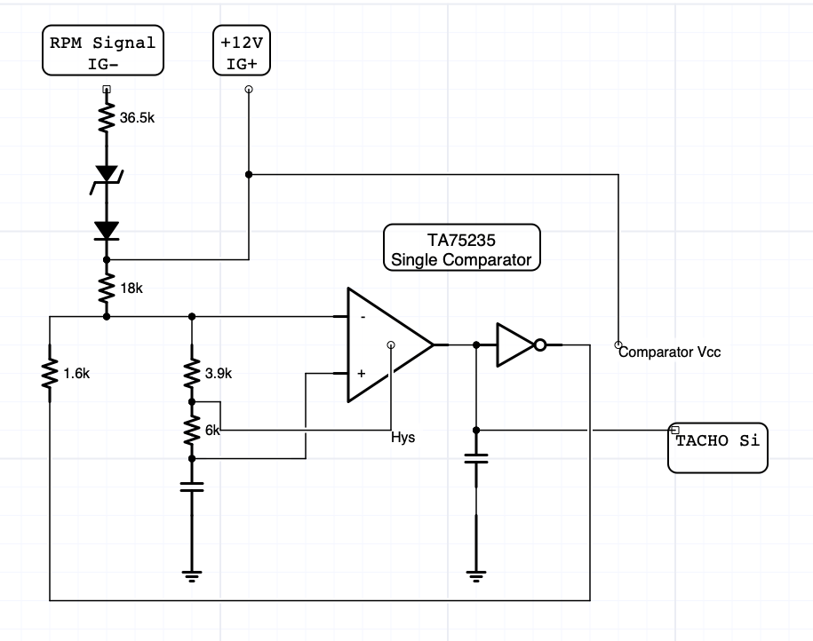

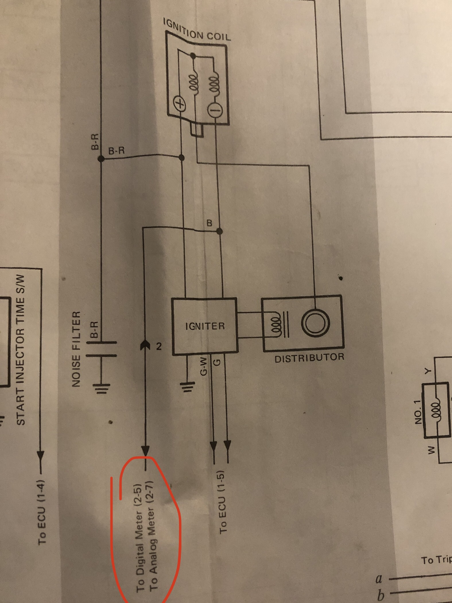

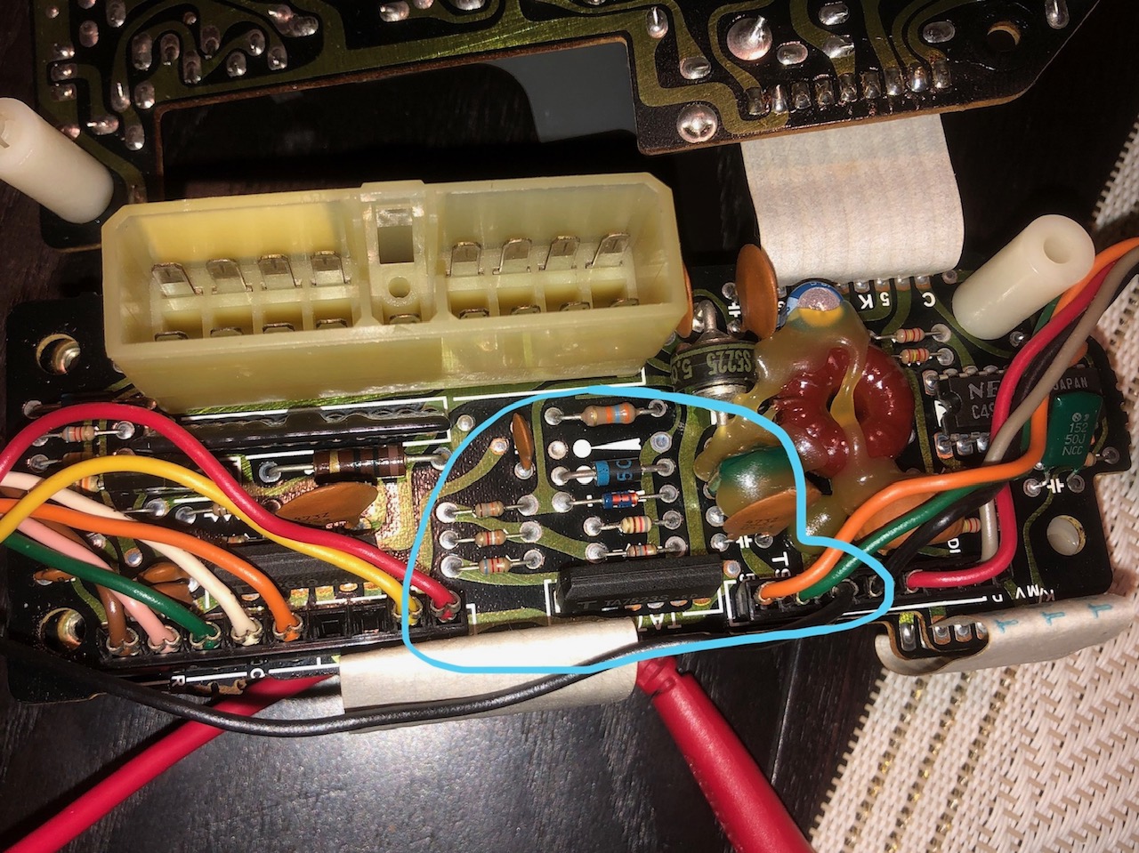

Doig5710 wrote: Sat Sep 27, 2025 9:40 pm find the tacho signal wire into the tacho, 95% of the time it will go through a 10-20k Ohm resistor first thing, I bypass that and also if needed add a 1-10k resistor pull up to 12v so the aftermarket ECU can drive it like I would like.
Please see the diagram of the igniter signal rectification circuit for my Digital Tachometer (drawn from observation maybe not 100% accurate).
If I can, Where should I plug the TachoOut PWM signal from Zombie?
Post by Doig5710 »
So looking at the pictures, the signal comes from the ignition coil -ve, into pin 17 on the main plug, though the 36.5k resistor into the tacho driver circuit? If I was wiring up a after market ECU id be bypassing the 36.5k resistor and seeing what happens then, maybe add a 10k pull-up after that if it doesn't work.
Doig5710 wrote: Tue Sep 30, 2025 6:12 am If I was wiring up a after market ECU id be bypassing the 36.5k resistor and seeing what happens then
It's working ! Thank you.

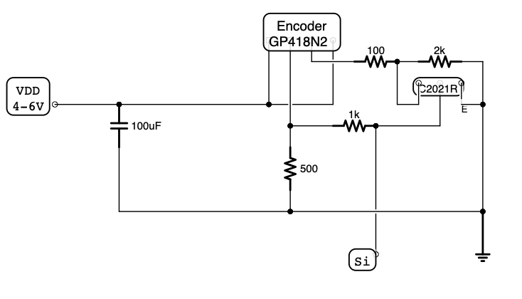

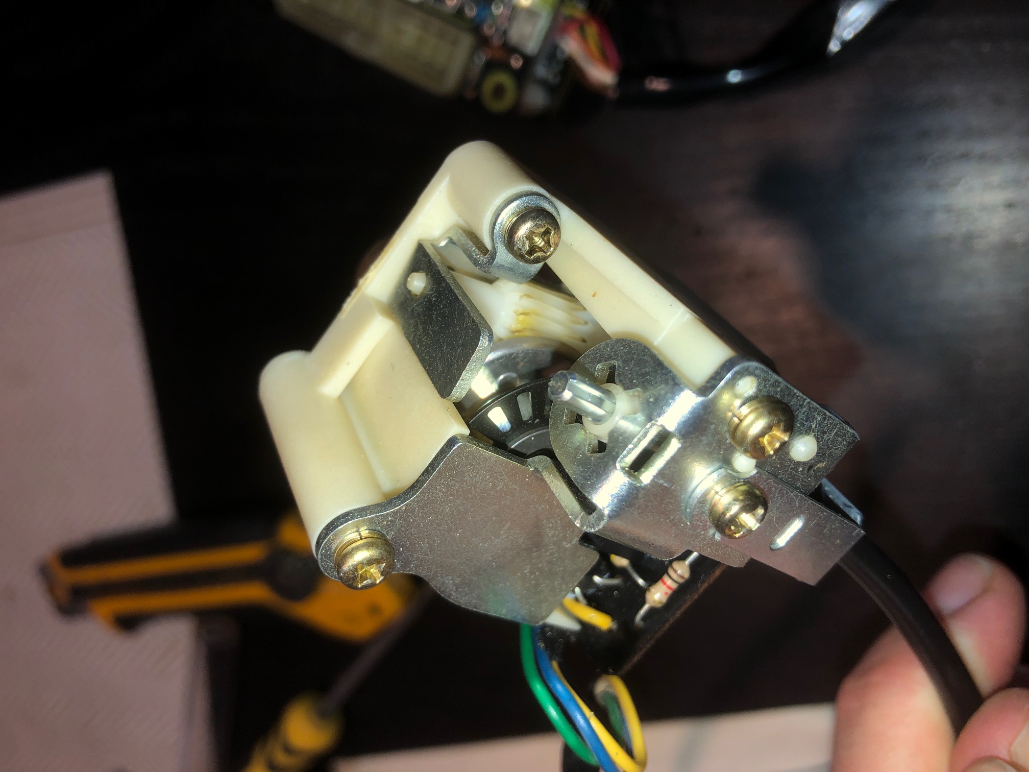

Now, what kind of circuitry would it take to convert the same TachoOut PWM signal into a signal (Si) suitable for the Speedometer?
Originally, the signal for the speedo comes from a cable making a 20 slits wheel turn in front of an encoder (one rev = 20 pulses).
The Speed Counter with its wheel and circuit:

What sort of sensor did the speed signal originally come from? 3 wire hall effect or 2 wire inductive type?
Not the same signal, rather use what is there...
See here how i did it for my Mazda
https://mazdamx3ev.wordpress.com/2015/0 ... er-senzor/
And the hall sensor on my Pug axle
https://leafdriveblog.wordpress.com/202 ... l-trouble/
But since you need 20 signals for one revolution you can use optical sensor and wheel with 20 slits on one of the driveshafts. In effect hybriding both of my solutions...
Or if you have single gear you can use a VCU to read CAN traffic for RPM info and calculate the speed from that ratio. Test with GPS...
