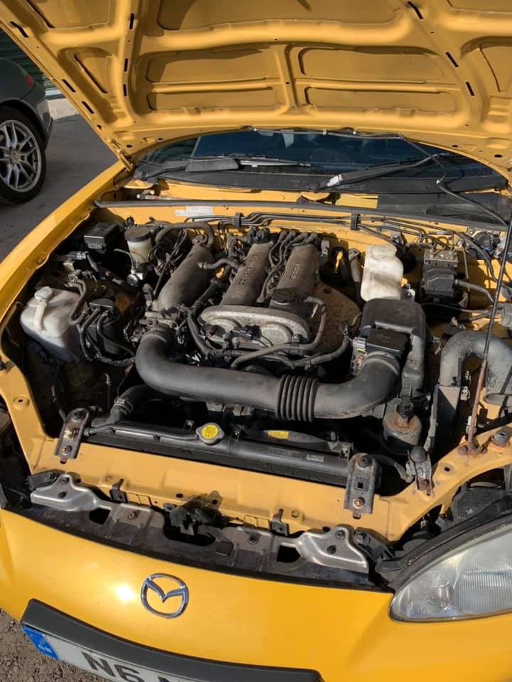

The idea is to show you a way of doing a conversion where the engine and gearbox are removed and a full electric drive train slips into place
MX5 Engine Bay
MX5 Engine Bay

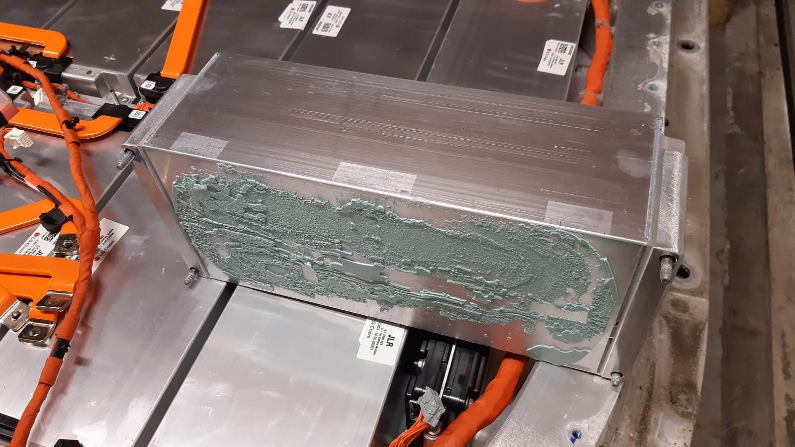

Zeroev wrote: Sat Apr 04, 2020 4:09 pm -26kwh LG battery pack consisting of 10 x 2.6kwh modules mounted onto liquid coolant plate
Are these the 'Pacifica' batteries? How much cooling is necessary?
EDIT Or the I-Pace? https://zero-ev.co.uk/product/i-pace-ba ... le-2-6kwh/
Posts: 2962
Has thanked: 328 times
Been thanked: 847 times
Re: Zero-EV Project MX5 Gen 2
The second packs, not the Pacifica hybrid packs.
As running 10 bricks give you a 30S pack at 26 kWh which is a good amount for a small car.

Interesting. These ipace modules seem to be the perfect fit for my vw van conversion. Even better than tesla modules. Also somehow the full aluminium enclosure gives me a better feeling from a safety perspective as well.
Do you know if the holes on the side can be used for mounting as well? Are these holes on both sides? And if instead of the bottom of the module the side of the modules can be used as a cooling interface? Probably not most efficient, but in the end its aluminium all around, so heat will be transferred, I guess.
Posts: 2962
tmotion wrote: Tue Apr 14, 2020 2:38 pm Interesting. These ipace modules seem to be the perfect fit for my vw van conversion. Even better than tesla modules. Also somehow the full aluminium enclosure gives me a better feeling from a safety perspective as well.
You can only use the 4 large bolt holes to bolt it down.
The main section is an extrusion, so you can cool any side or more sides.
