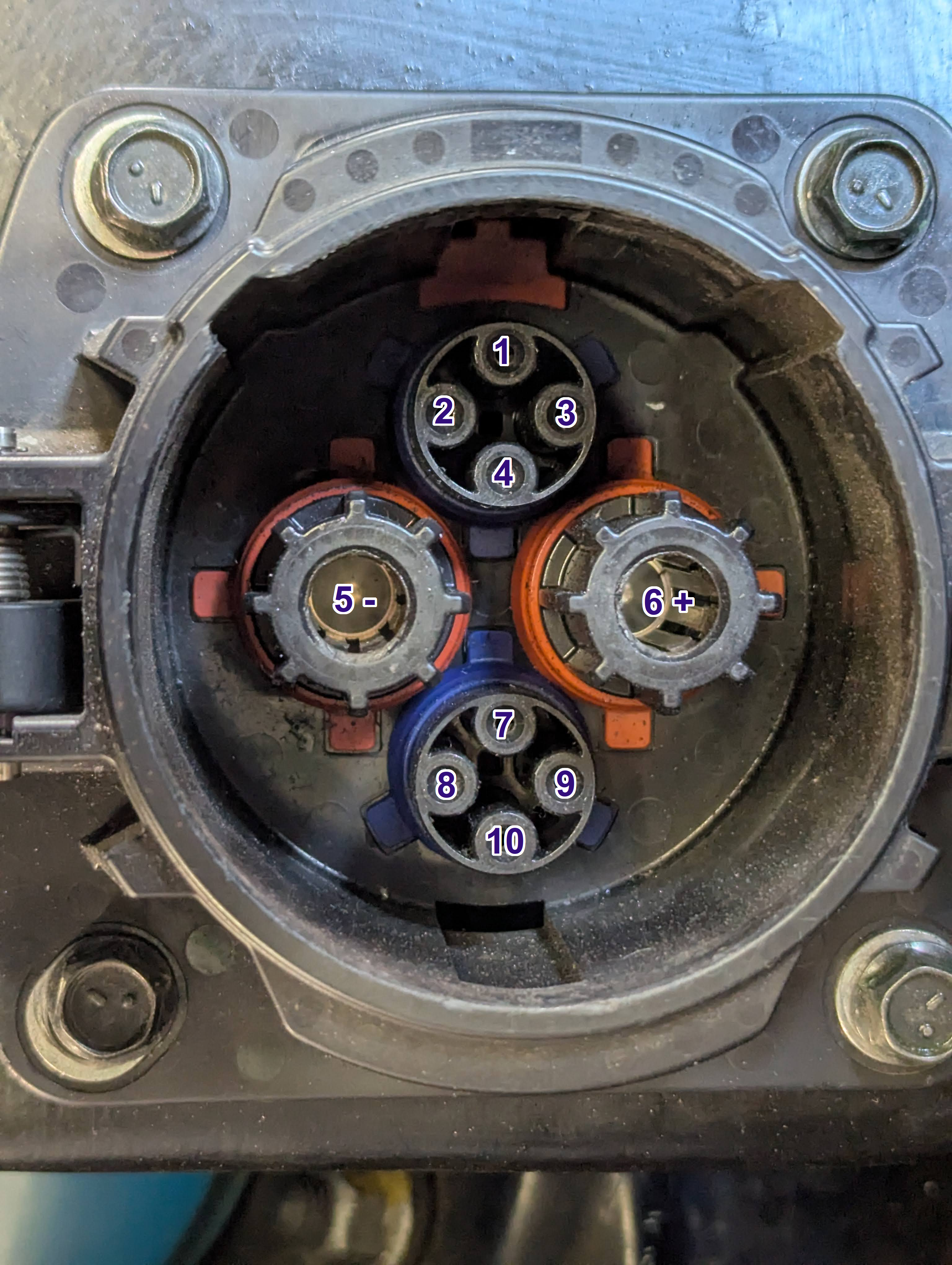

I've been working on this for a few hours and this is what I've found.
I applied 12V to pin 2 and Gnd to pin 10 (chademo socket), and the contactors activated but I got no voltage at the VCU GP12V Input.
After a few minutes head scratching I realised there was no common ground so I linked pin 10 to chassis ground.
Will this be different with a Chademo plug pushed? I'm assuming it will so won't leave the link wire to pin 10.

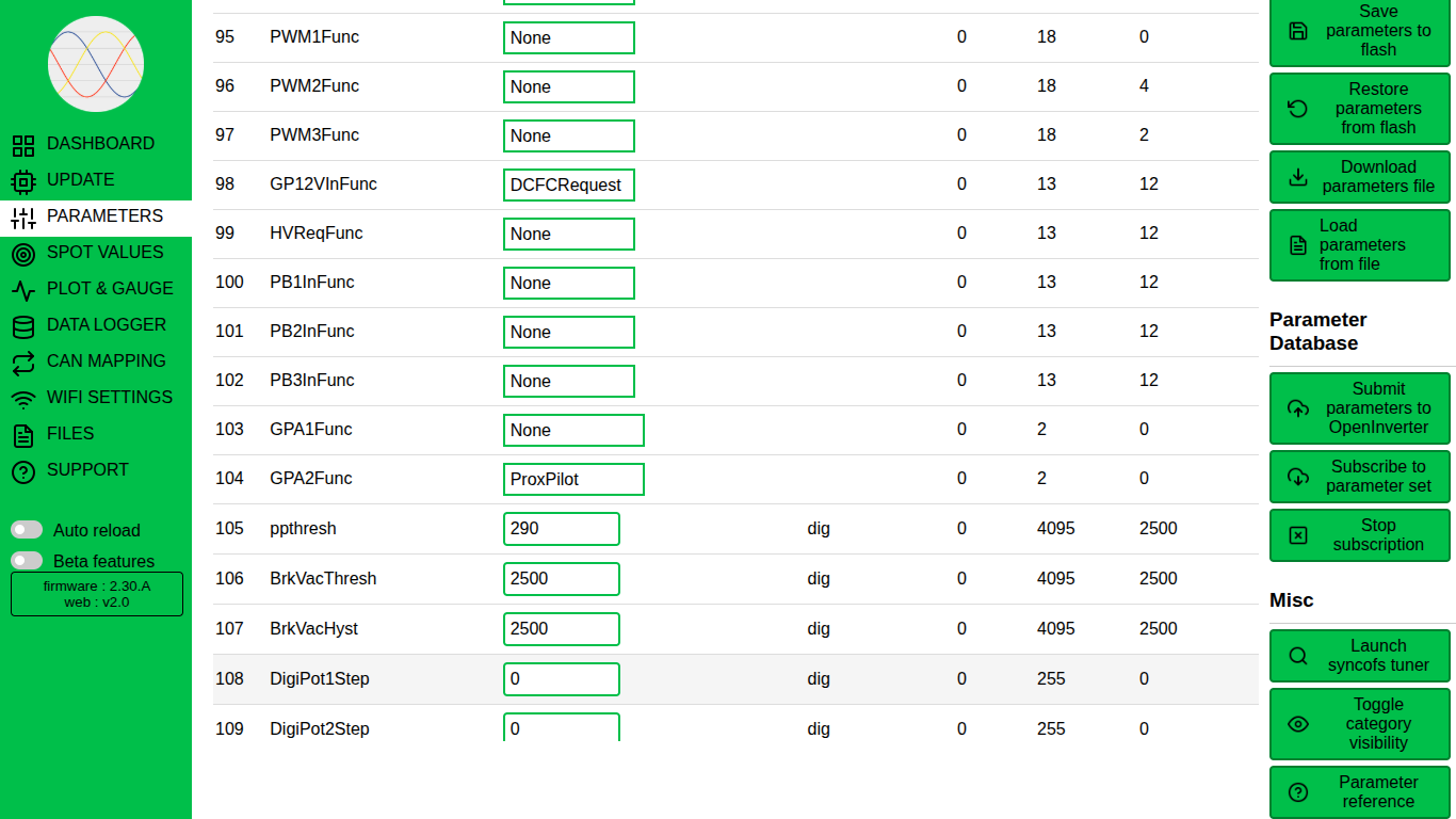

Anyway with pin 10 grounded I now have 12V at 'GP12V Input' and spot value "din_12Vgp" changes to "on" but the VCU didn't go into charge mode.
After another hour or more of head scratching it dawned on me I still had GPA2Func set to 'Proximity Pilot'. I changed this to 'None' and immediately the VCU went into charge mode.

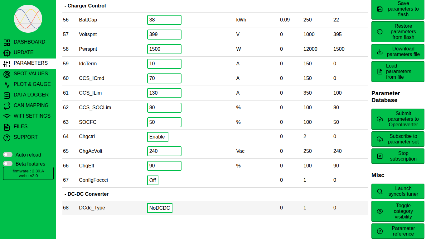

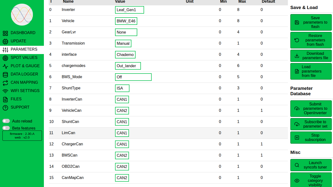

These are the parameters I've set for Chademo charging.
04. Interface - Chademo
05. Charge Modes - EXT DIGI
55. CAN3 speed - k500
60. CCS_ICmd - 7 (I couldn't see what Damien was setting it to in the video but he said it needs to be more than 0)
64. Chgctrl - Enable
92. Out3func - ChaDeMoAlw
98. GP12VInFunc - DCFCRequest
So it looks like to change from ac to Chademo charging I need to change 'GPA2Func' and 'Chargemodes' in parameters.
I plan to try Chademo charging again this afternoon and will report back.

Charge Modes is not what needs changing. Leave it set to what you had it to and it should allow Chademo.

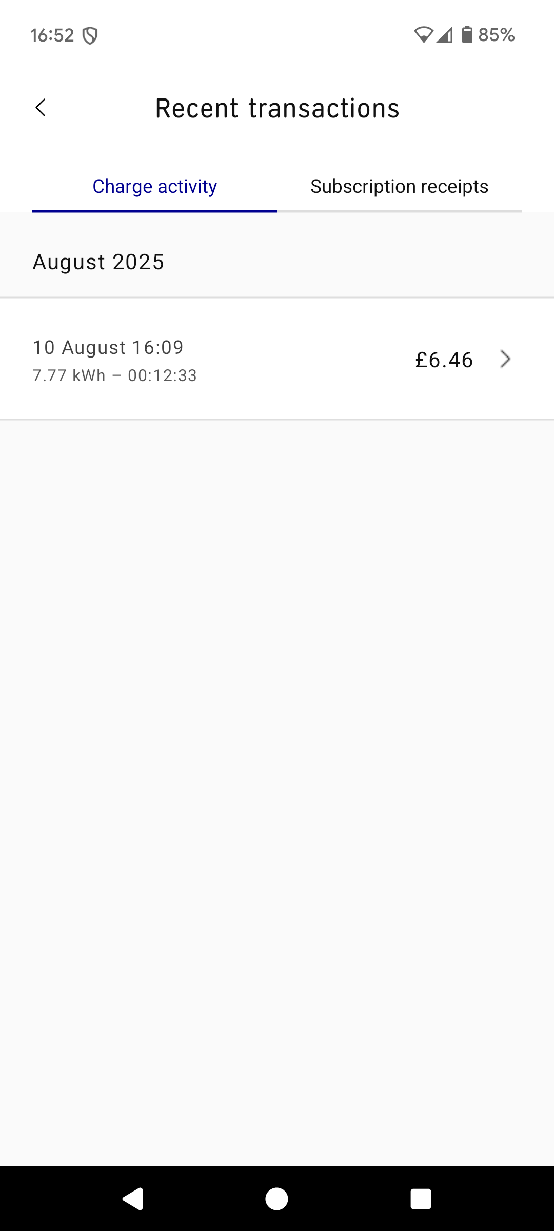

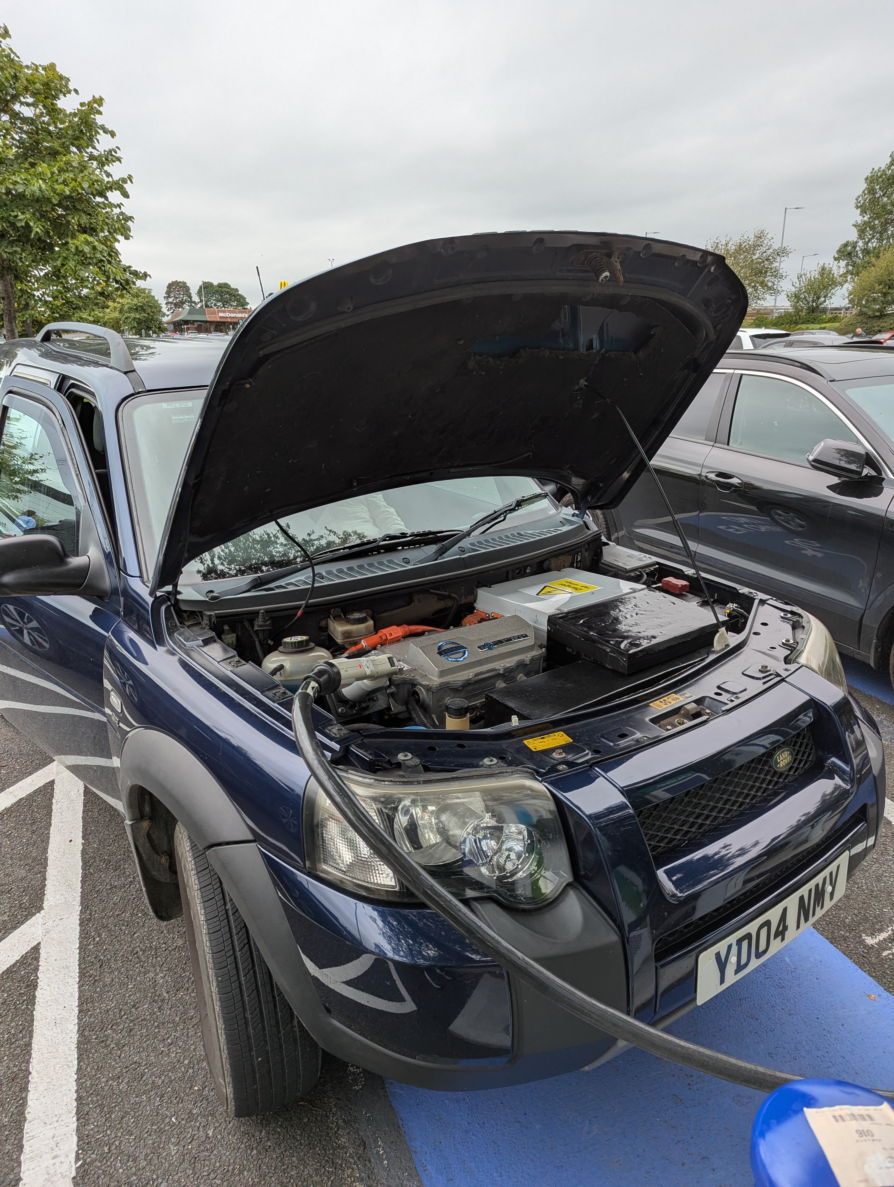

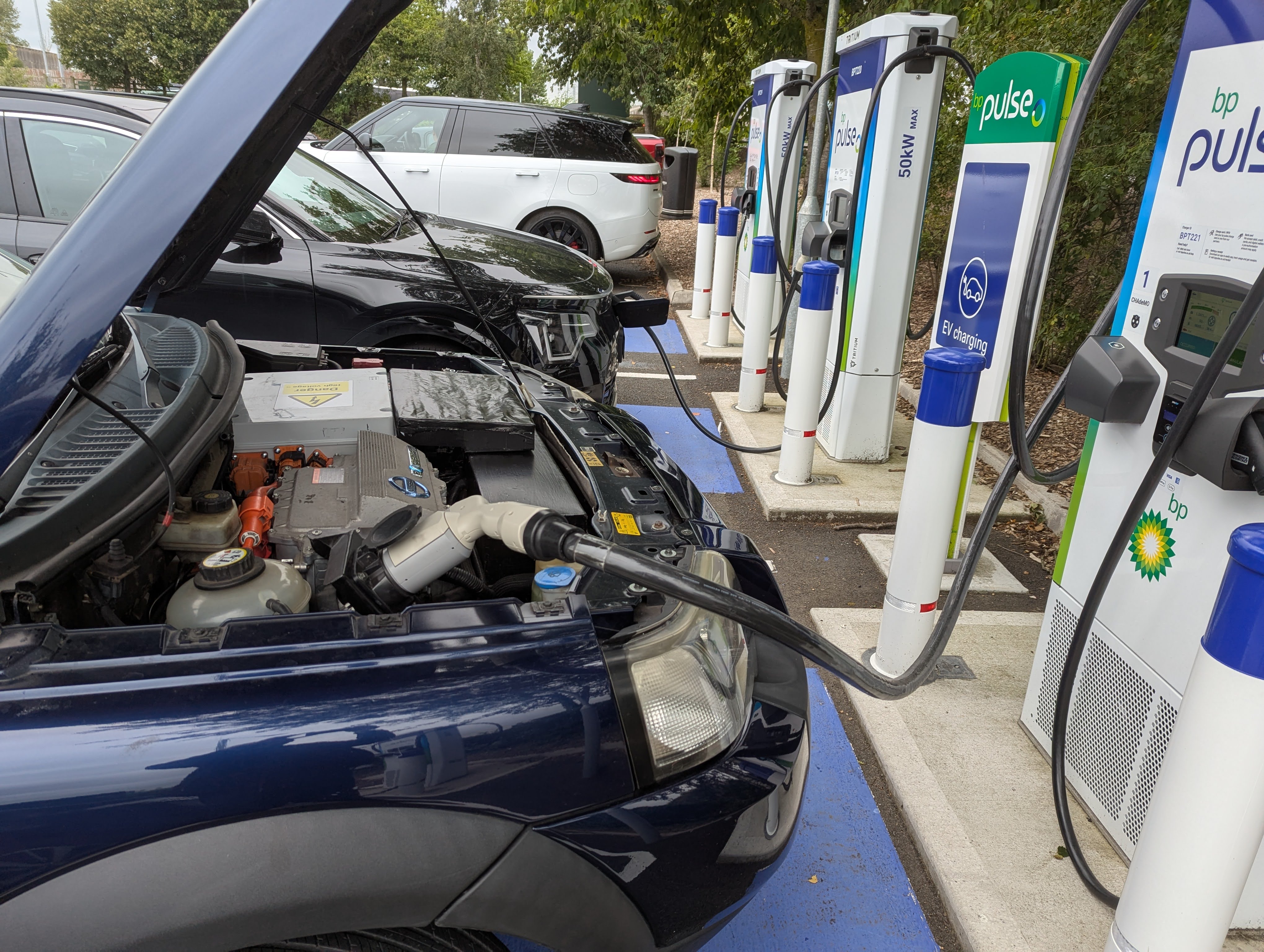

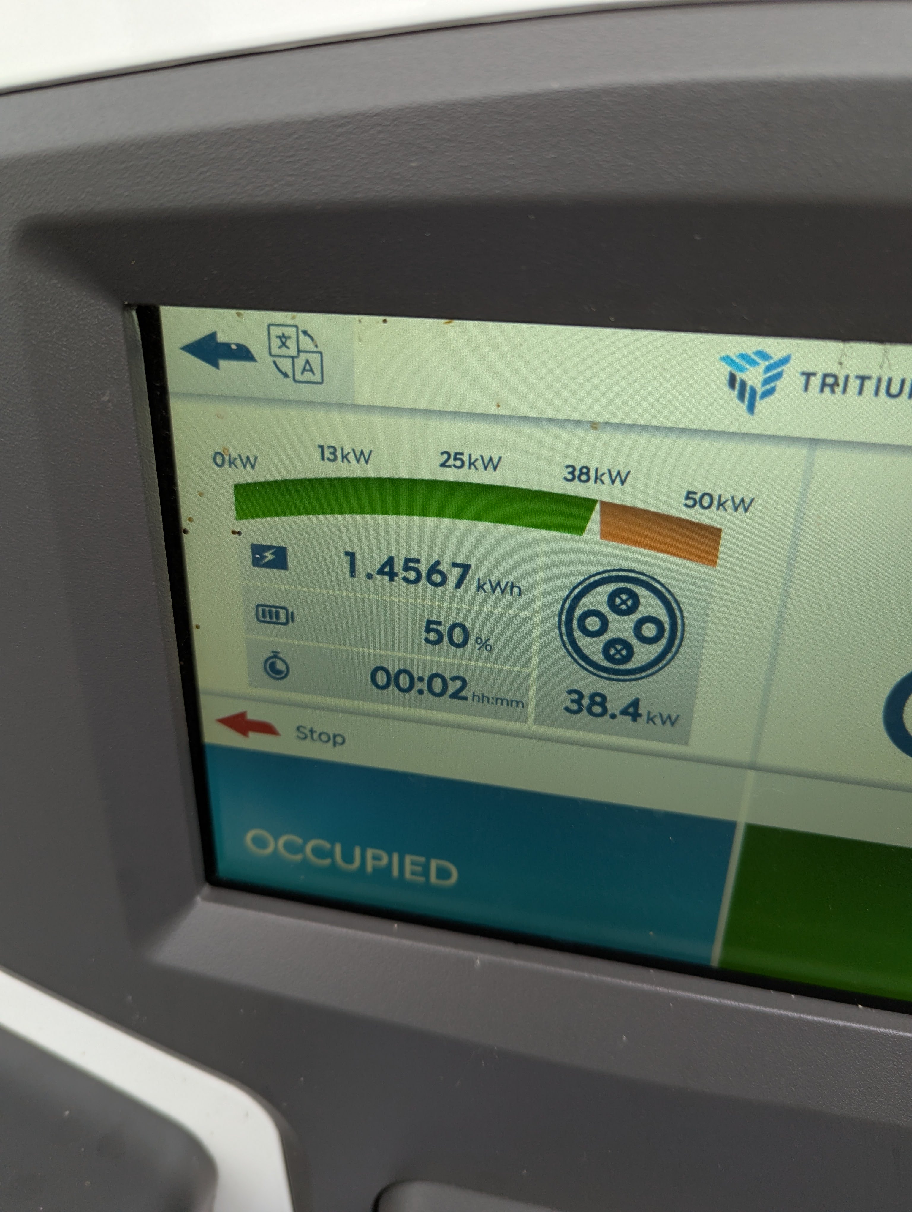

It's just as well none of you guys were near me today or you'd have got a great big slobbery kiss!
IT WORKED!!!
I didn't have time to make any changes or tweaks but it worked so I was thrilled to see a positive result for so much work.
I'm running version 2.22 and will need to do more testing to see what works and what doesn't so I'll report back.
Just in case anyone else is following this same path here is a photo of the Chademo charger socket looking at the front. If you are trying to meter out the connections it's much easier with this view as most images on the internet are from behind or are just plain labelled wrong.
IT WORKED!!!

OK so the car is charging on the Outlander OBC. Here are the parameters That I think are relevant but I uploaded the json as well.
To enable Chademo I change Chargemode to ext digi and GPA2 to none
Note I haven't tried Chademo since upgrading to 2.30 and will not be able to do much more until tomorrow so I'll test more then and get back.
- params.json
- (2.13 KiB) Downloaded 40 times

Re: Chademo charging with a Zombie VCU
Sorry I had to rush off and only able to get back today.
So with Chargemodes set to Outlander as it is here, if I connect 12V to GP12VInput I see din_12Vgp change to on, but the Zombie does not go into charge mode. I need to change Chargemodes to EXT_DIGI for that to happen.
If I set Chargemodes to EXT_DIGI (with or without 12V on GP12VInput) the Zombie will go into charge mode immediately. I need to change GPA2Func to 'none' to stop it.
So to switch from outlander obc to chademo I have to change both Chargemodes and GP12VInput.

You could be manually connecting a resistor to your GPA2Fun input and it would work.
I think that may be the clue here as I said I have my bench setup pulled out of the box
I have the PP threshold set to 250 now as with a lower 12v battery it was approaching 290 with the plug 3/4 in but the button still opened.
With no plug in I see PP at around 400
With it in 3/4 it's around 300
With it fully in and the button on the handle closed it's around 150
I already have a voltage divider circuit that powers a relay when it sees the type one connector fully plugged in.
I just haven't figured out a way to use it.
