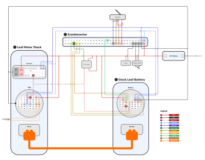

Hey Folks,
While waiting for my Zombiverter to arrive I have been working on a wiring diagram for my bench test.
It's pretty much the same as this one although I'm using an intact stock Leaf battery pack for the bench test and wanted to get the pins correct.
Would be grateful for you all to tear it apart and let me know what I have got wrong :lol:

Nice drawing, your missing t15 “on” switch, pdm working looks right.

Thanks! makes sense, i remember the switch in one of the videos now.

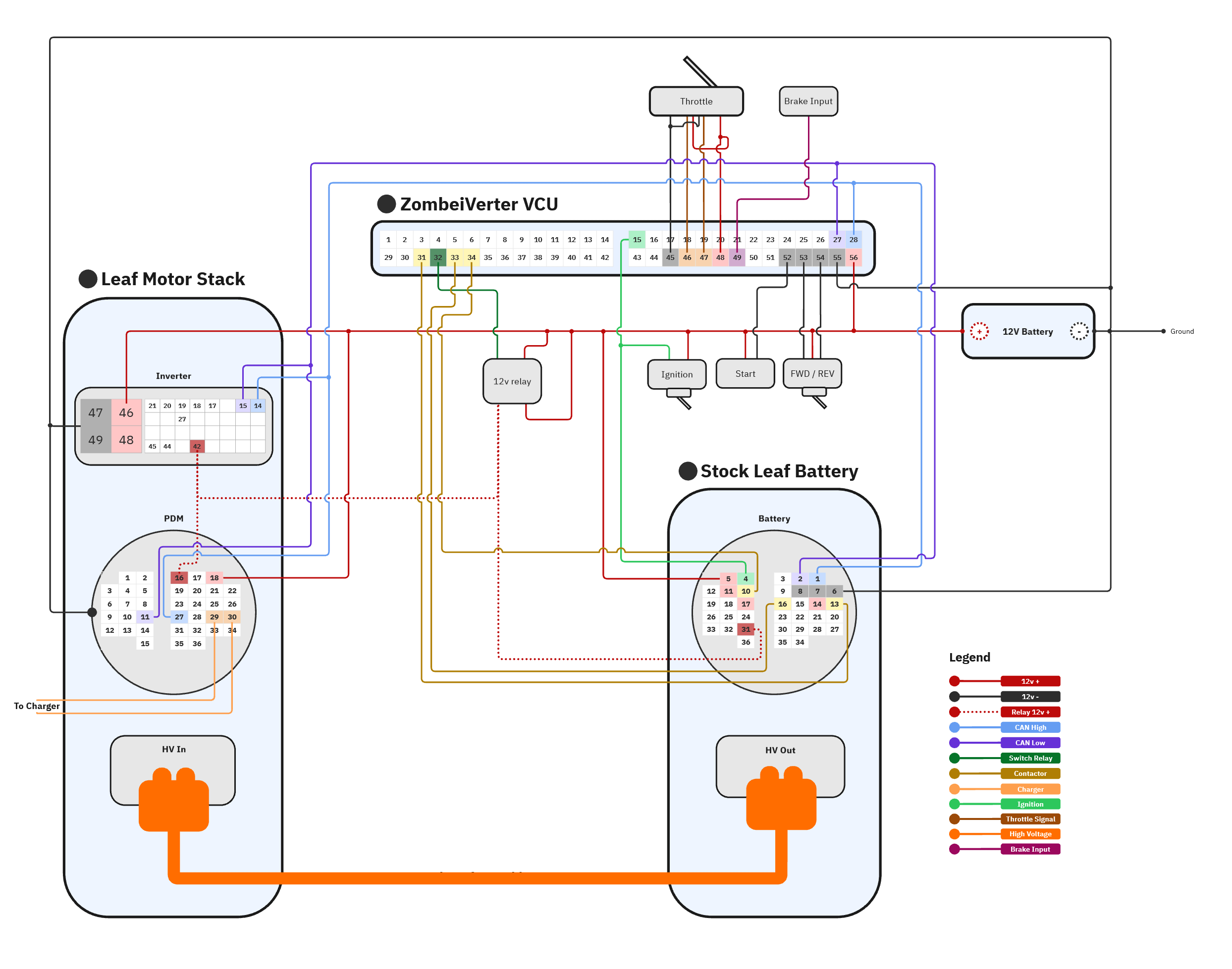

I've just spotted both diagrams are missing the brake input to terminal 49 of the ZV.

I used a free Miro account to make mine. Not sure I would have if I had of found yours first GregFordyce :lol: But it is a good process to go through to fully understand the wiring.
Can contribute it to the wiki when it's correct. Thanks for pointing out the lack of brake input GregFordyce.

Updated diagram with Ignition switch and Brake input.
I have submitted it as a community Miro Template, but will need to wait for review and approval.
If others would like access to a collaborative Miro, PM me your email and I'll add you to my Miro board.
Should I add this to the Wiki page?

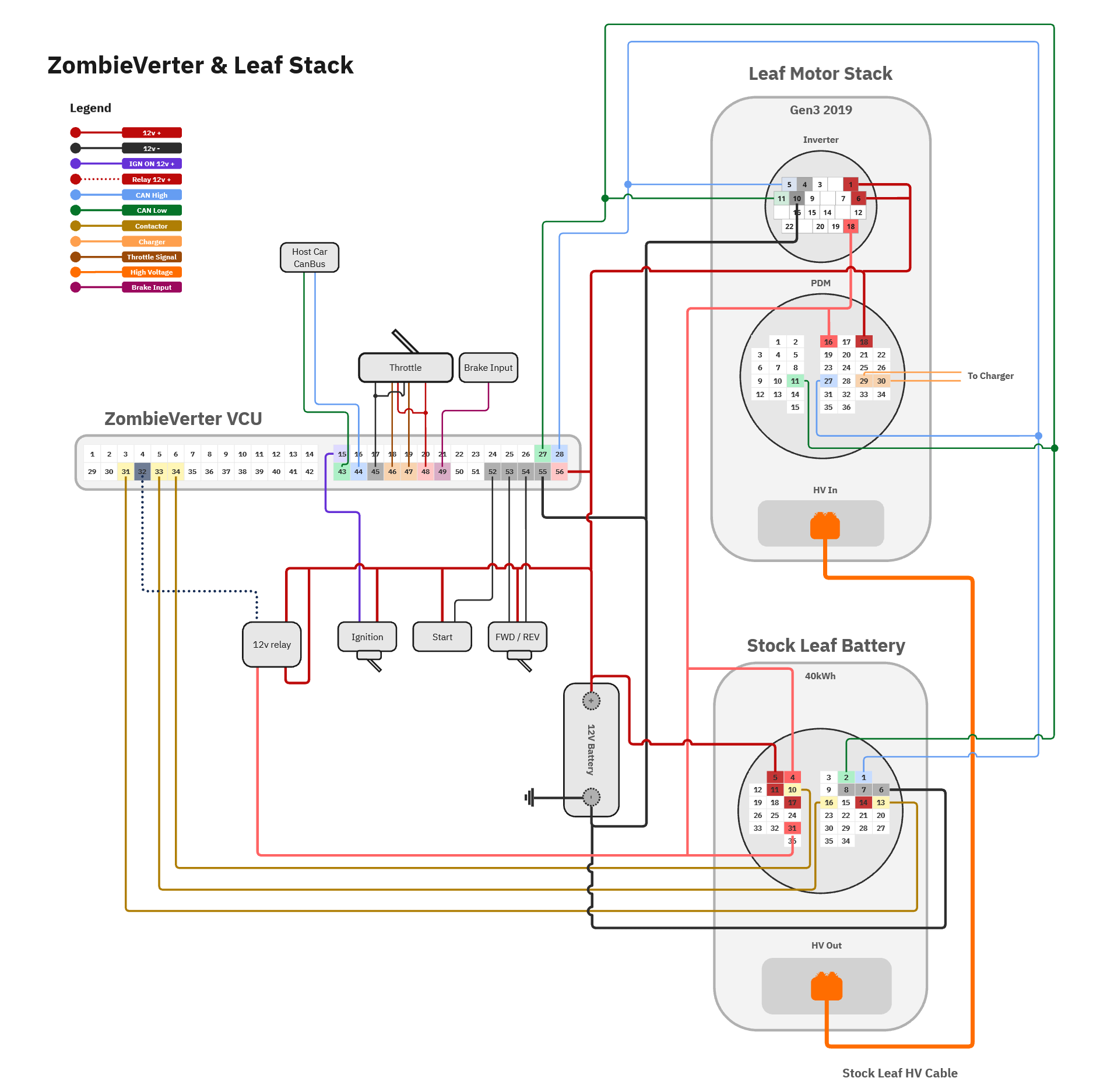

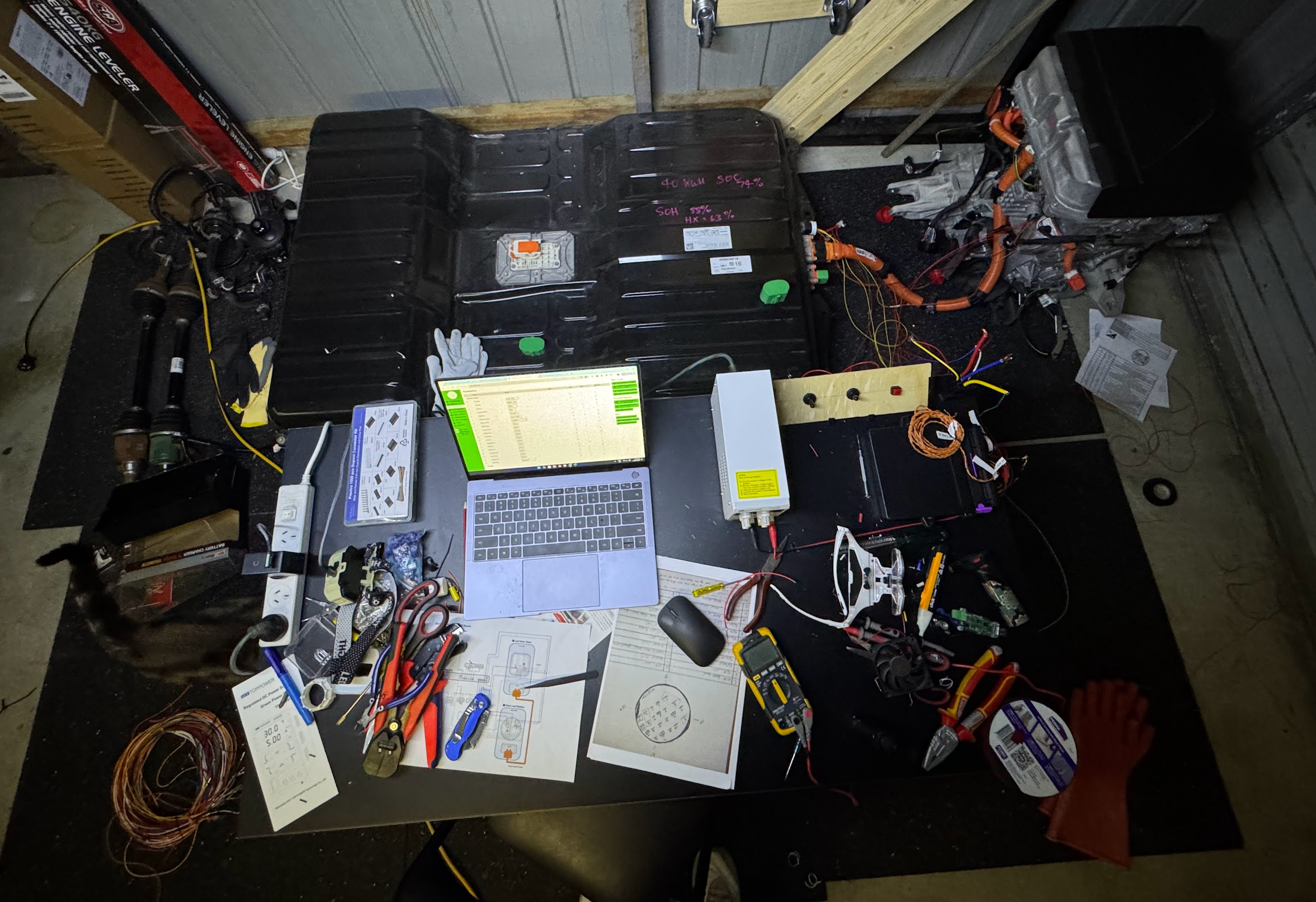

Well I'm getting there. I have my bench setup, throttle, switches, relay and I'm talking to the battery and the Inverter, and I think the PDM.
I got the leaf parts from a wreckers so it was unclear what year things were, so I have been down some dead ends with my wiring diagram, but I believe now I have the correct wiring setup.
The problem I am currently having is that although everything starts up, the battery, inverter and I get into RUN mode, the throttle is not doing anything when pressed. I have of course followed Damian video and calibrated the throttle, I see it going up in the spot values.
I have attached my params file and the spot values in a state where everything is turned on including HV.
params.json
(2.13 KiB) Downloaded 53 times
Zombie-spot-values.xlsx
(14.66 KiB) Downloaded 41 times
It would be amazing if someone could have a look over the wiring, params and spot values and give me a steer in the right direction.
Thanks!

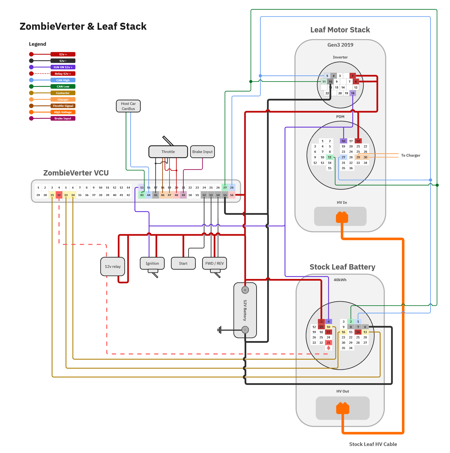

Please plot Left potnom and right pot and pot 2
Then plot left potnom and right torque
Also your 12V relay and igniton wiring to leaf components is wrong. Here is how to wire it. https://openinverter.org/wiki/Leaf_stac ... ombiverter

Thanks tom91, I think I have addressed the wiring diagram. I'll come back with the plots over the next few days. Thanks again for the help.
