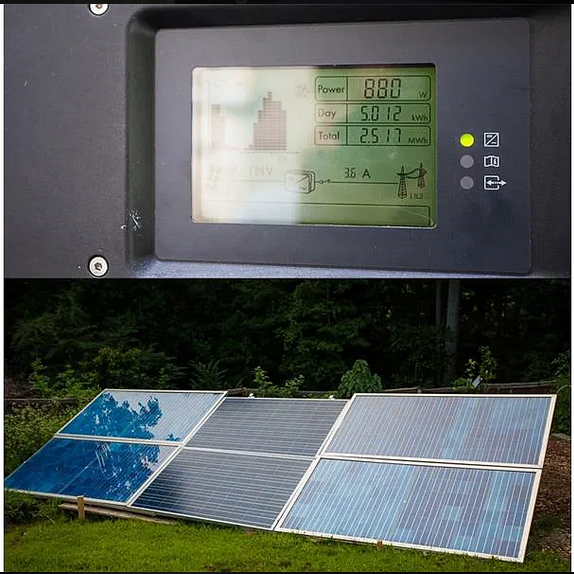

I started my first system with junk like this about 14 years ago
I then moved to SMA 4000TL-US 4KW grid Tie inverter. Very efficient but not hybrid. SMA like Nokia did not want to change with times and was left behind.

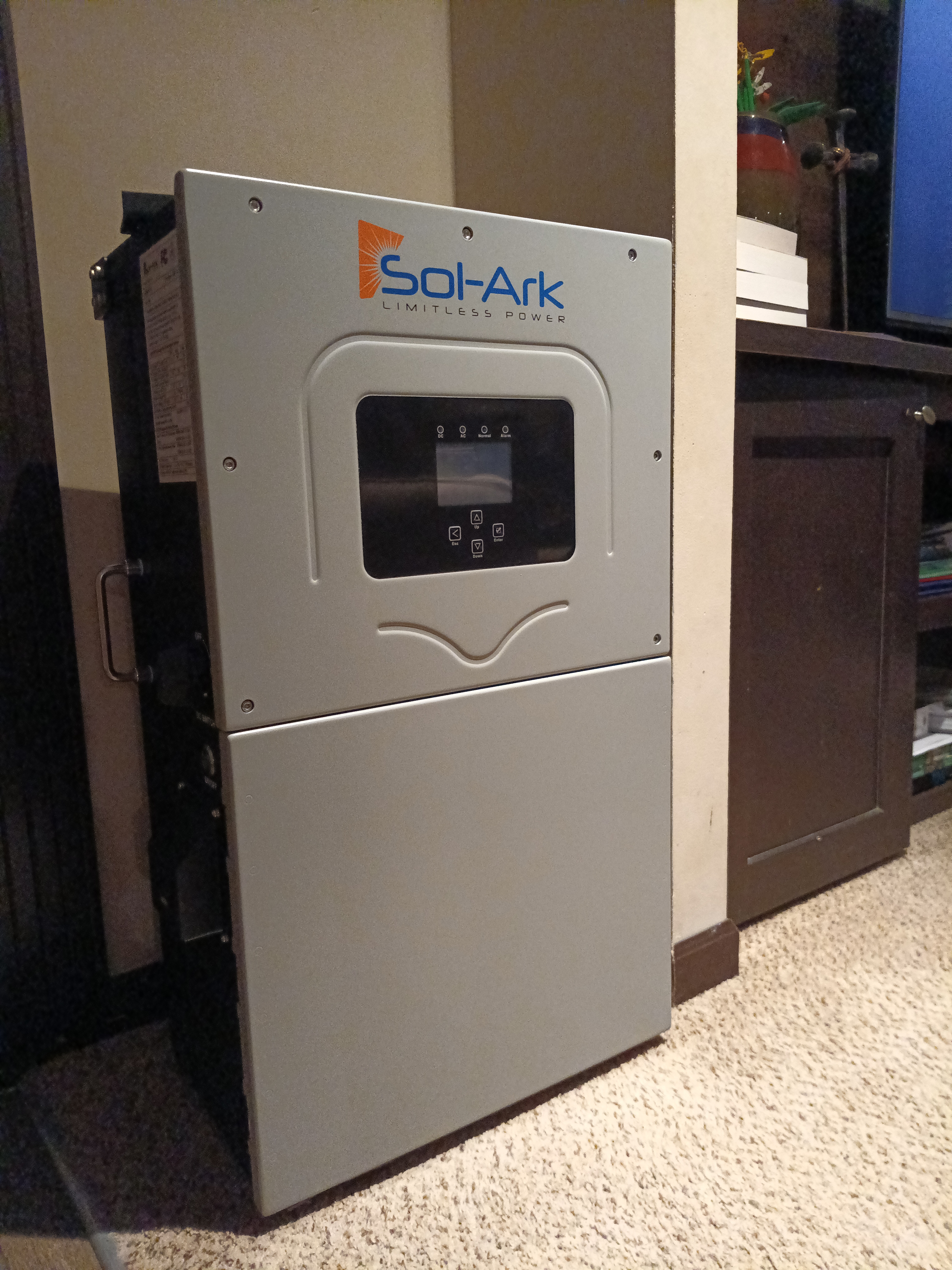

I think Almost 7 years ago, I moved to Solark 8K inverter and this was a game changer. It runs my whole house. ** If I manage the loads.
My Battery = 93KW.
Solar = 8.4kW
For my hot water heater I removed the 4500W element and changed it with a 1500W element.
Stove uses 2400W, AC uses 2500W, Owen uses 2400W.
So I can use the Stove, Oven and AC at the same time.
2400W + 2400W + 2500W = 7300W.
I can use up to 12kW because I still have a GRID connection but I manage the loads to use my own power because I have too much power.

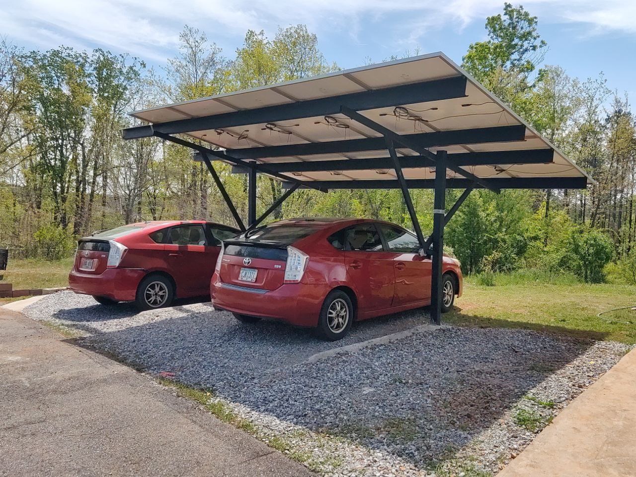

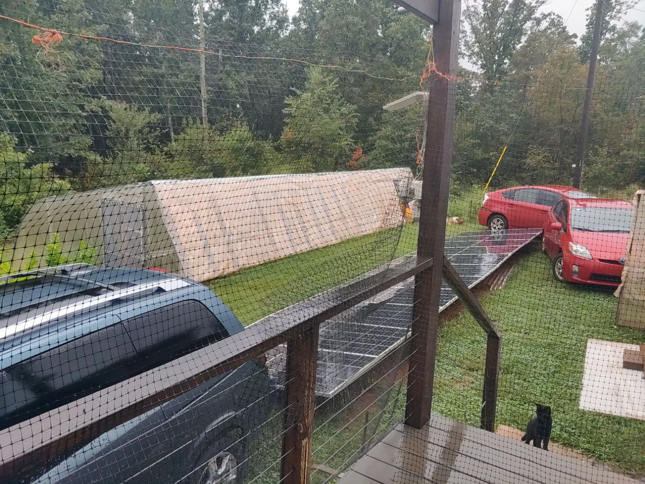

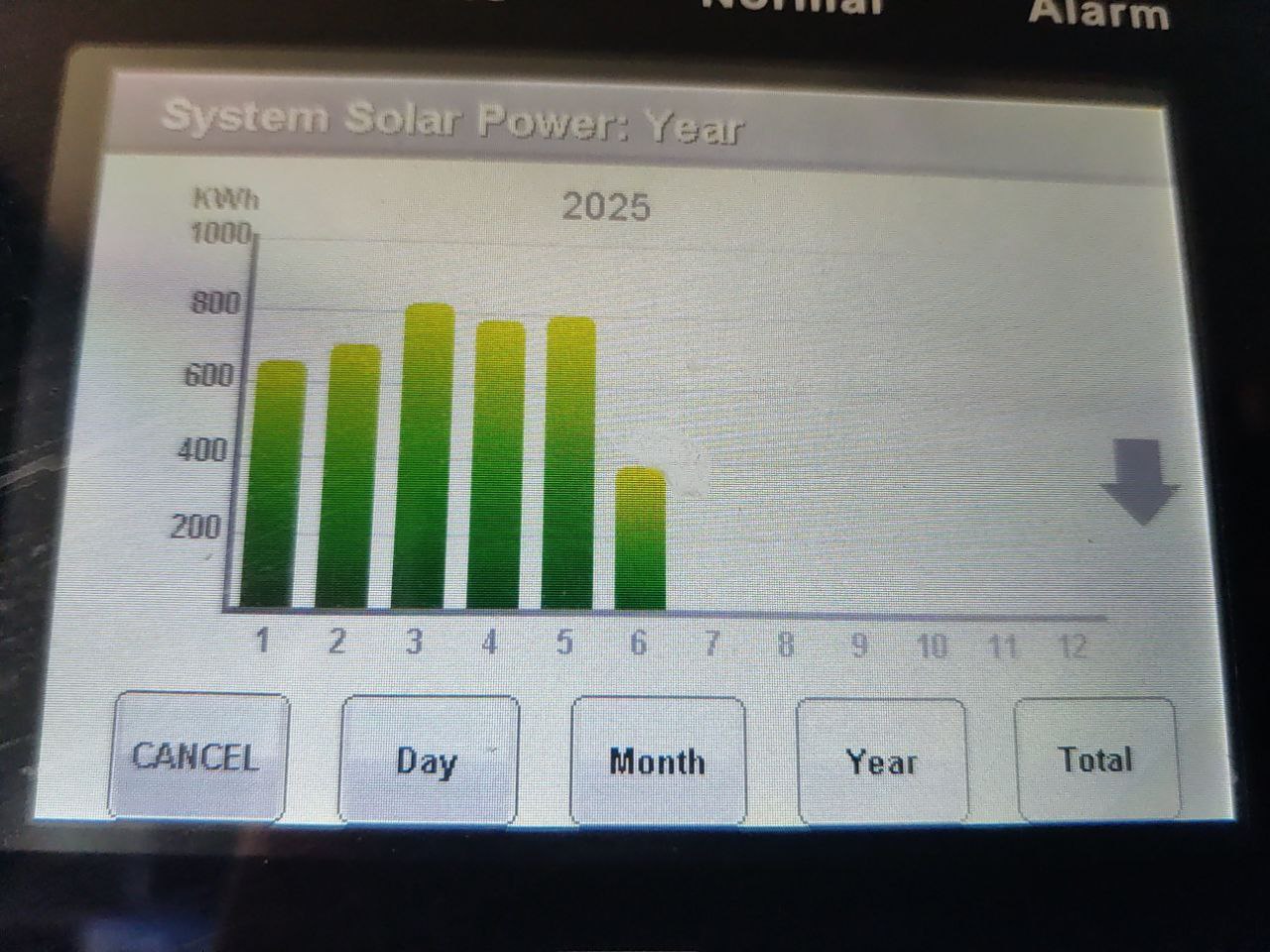

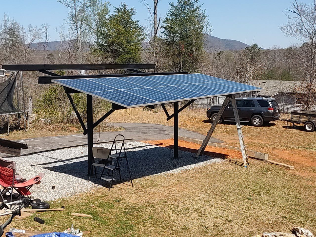

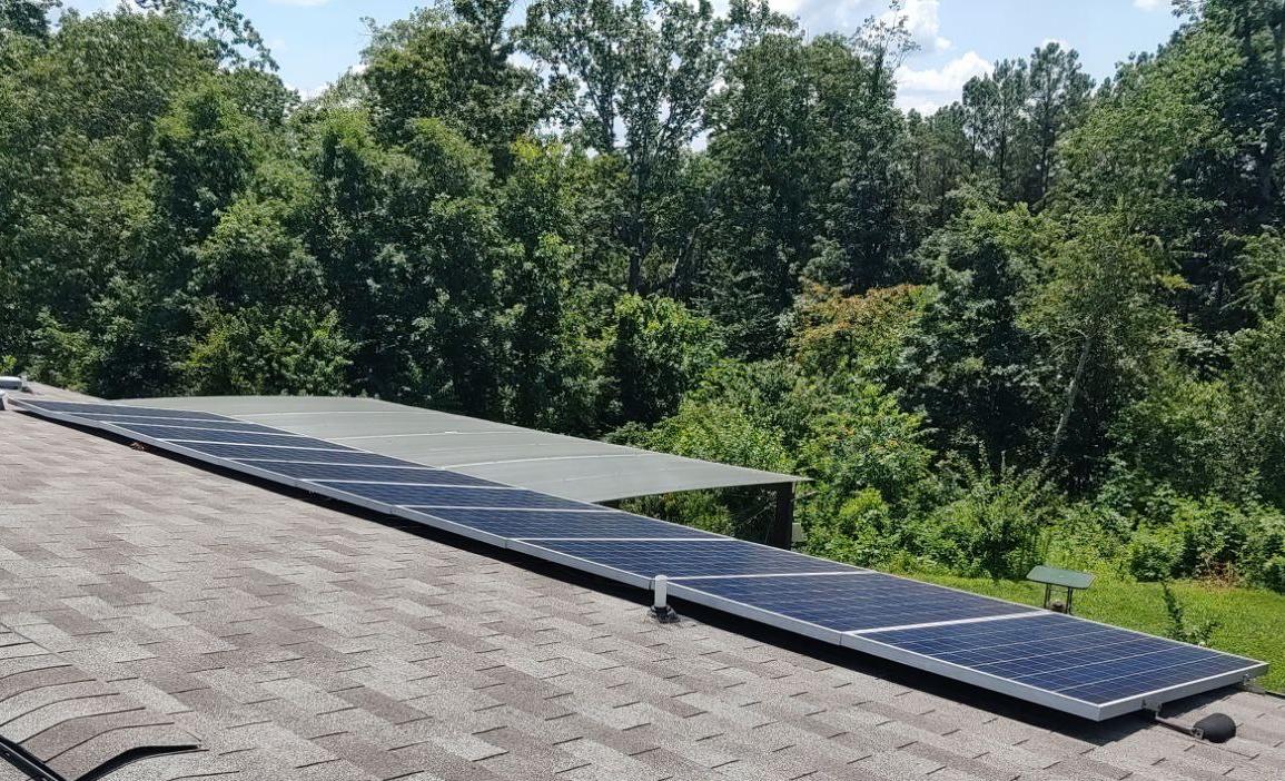

Here in Georgia, in the summer AC runs all day long From June to September. I had 11 panels Down on the ground and afternoon some shade from a power pole was cutting down my production. Also chickens were pooping on the solar panels and I was washing them 2 times a day. This year I got tired and moved them up. Now there is no pore dirt on the panels and no more shade afternoon. So production went way UP.

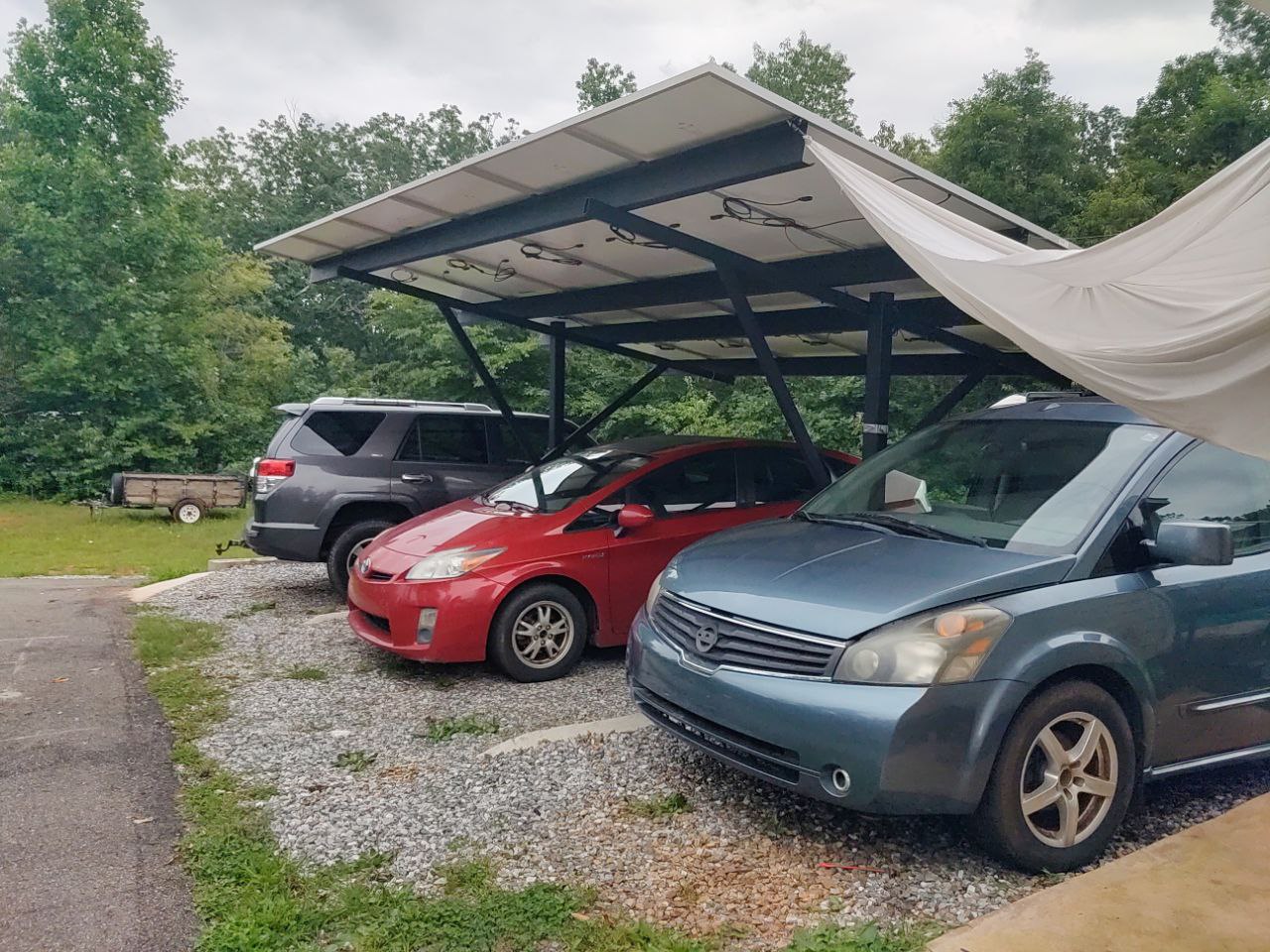

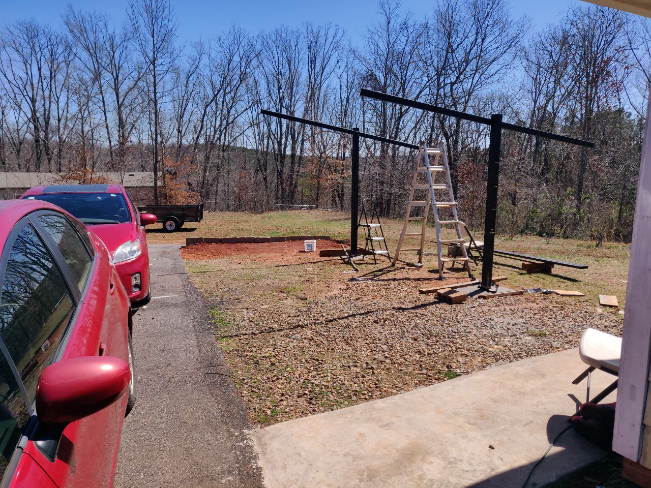

I built this solar carport for $1080 and was a lot of work. The metal poles are 4ft in the ground in concrete.

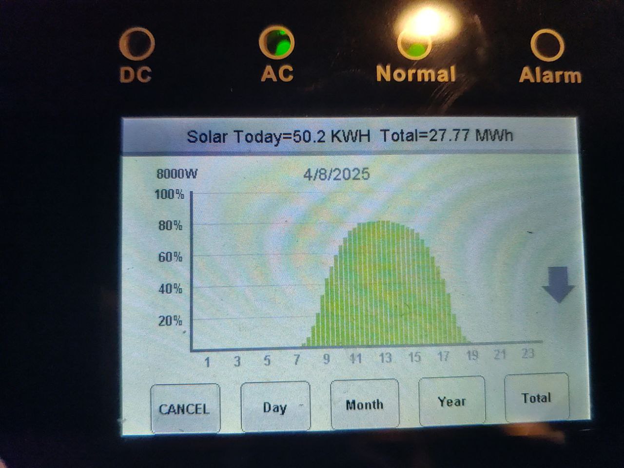

In the spring I was able to produce 50kw /Day. But that was only after few cloudy days when the battery went down to 50%.
Right now I can produce more but I do not know exactly how much because my batteries are full by noon and the inverter stops producing power. I need to have the battery down to maybe 60% and then I need a full sunny day to see how much I can produce in the summer.

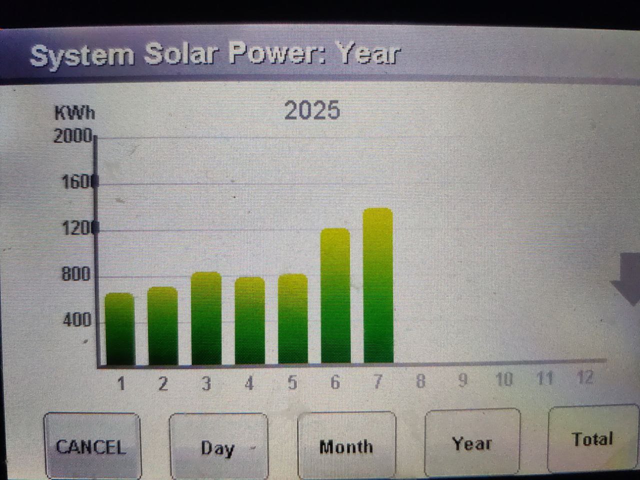

This image show the how much my house used this year. Not what the system can produce, because I can produce a lot more.
July is the hottest Month and will probably know if my panels produce enough power.
When I will start charging the battery for the car I will know exactly how much I can produce.
Here I was guarding my solat panel on the ground. we had high winds that were picking up the solar panels and I had to move the cars around.
Here is the new solar carport.

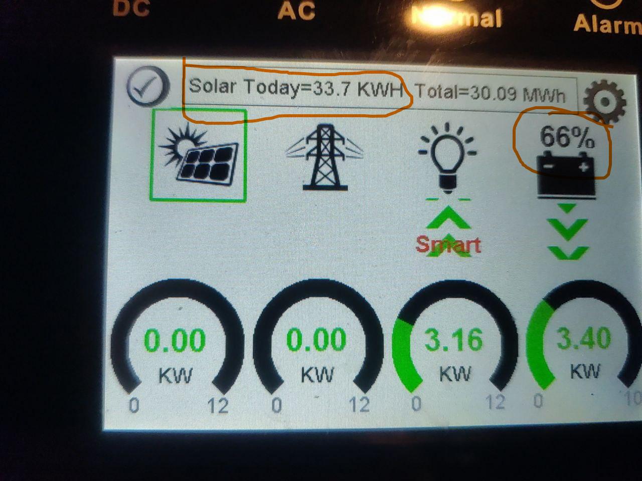

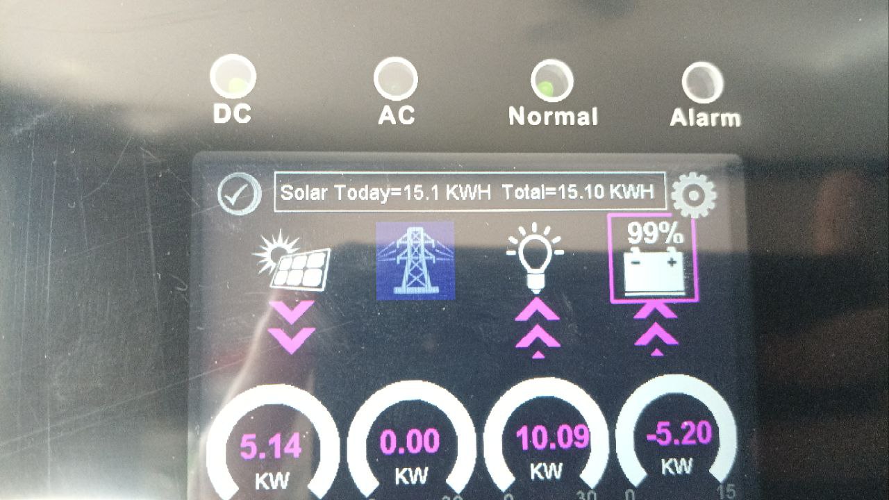

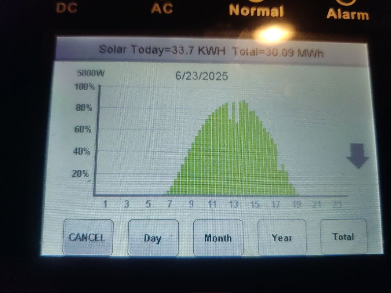

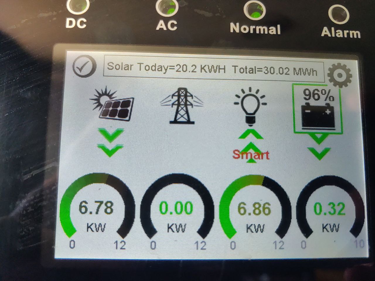

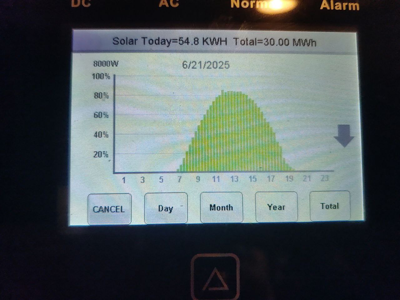

after I tested the Solar production in march and I got 50Kw, and because today is the longest day of the year I wanted to test again the solar production.
TO drain the battery for today yesterday afternoon I turned of the switch from the solar panels to help discharge the battery and last night I did 5 loads of washing and drying and managed to drain the battery to about 68%.
surprise is that the production was only 54.8kW, only 4.8kw more compared to the spring test. I was expecting over 60kW. I guess that heat indeed has a big effect on the solar panels. today we had 34C and indeed was very hot. AC ran nonstop from 11 AM to 7-8 PM
I forgot to check if the 10 panels on the roof of the house are clean, but I can check that tomorrow.
Also the battery showed 100% around 4 PM but according to the production curve I do not think I lost any production.

Proton wrote: Sun Jun 22, 2025 3:15 am I guess that heat indeed has a big effect on the solar panels
Yeah it does. It was 30°C here yesterday and my system peaked at 1070W. On sunny cold days 1250W

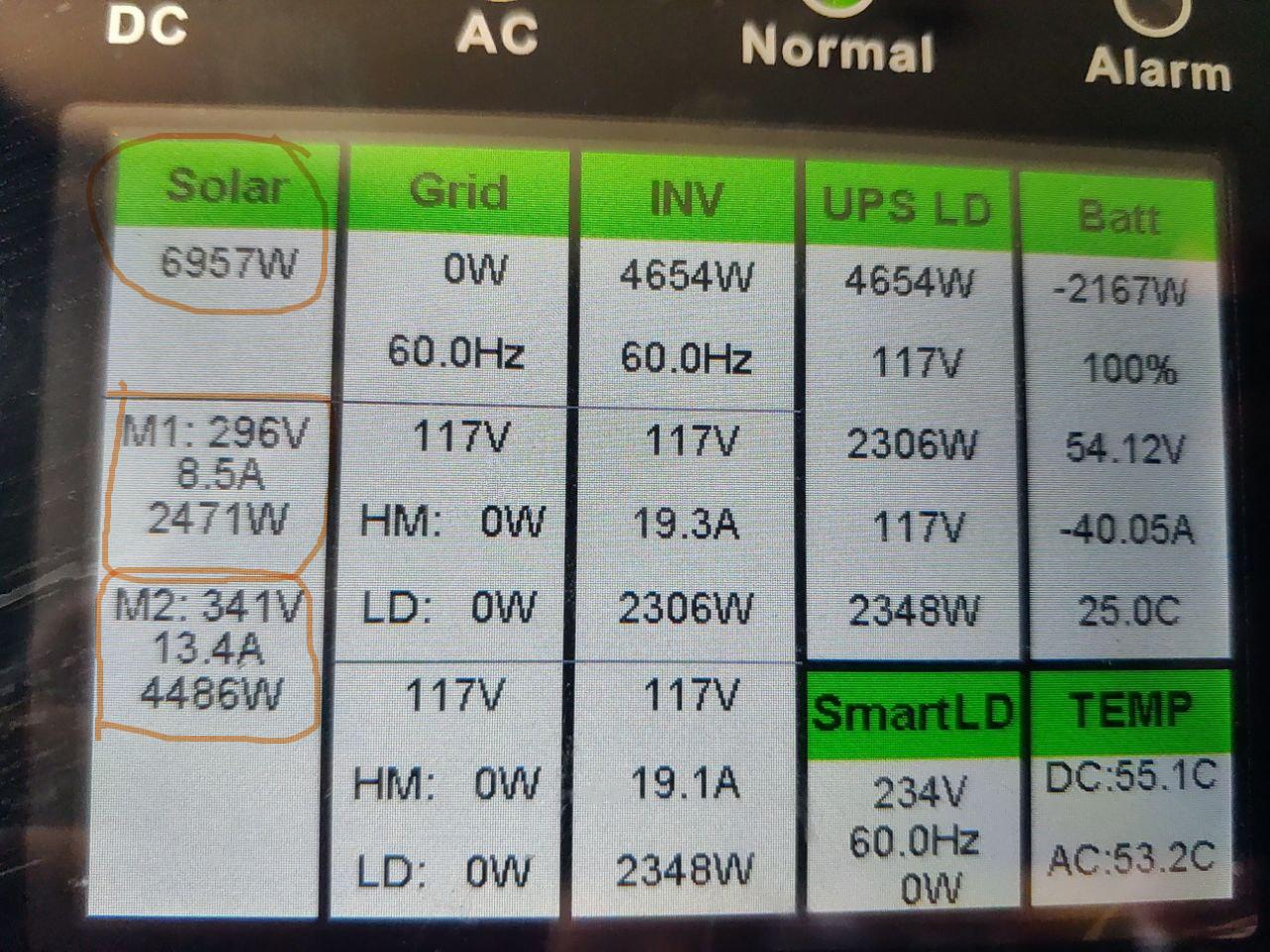

So, it looks like the solar panels on the roof are less efficient that the solar panels on the Carport which have a lot more airflow.
M1 Roof are 79% efficient, probably because of the hot roof.
M2 Carport are 84% efficient probably because there is more air flow underneath.
But both lose efficiency in this heat.
Probably next for the sake of science I will disconnect the solar panels on the roof too see if the carport is enough to keep the batteries full in this east coast weather where you have to run the AC 24/7 in the summer.
For a well insulated house like a passive house the 3.1kW panel on the roof should be enough even in the summer.

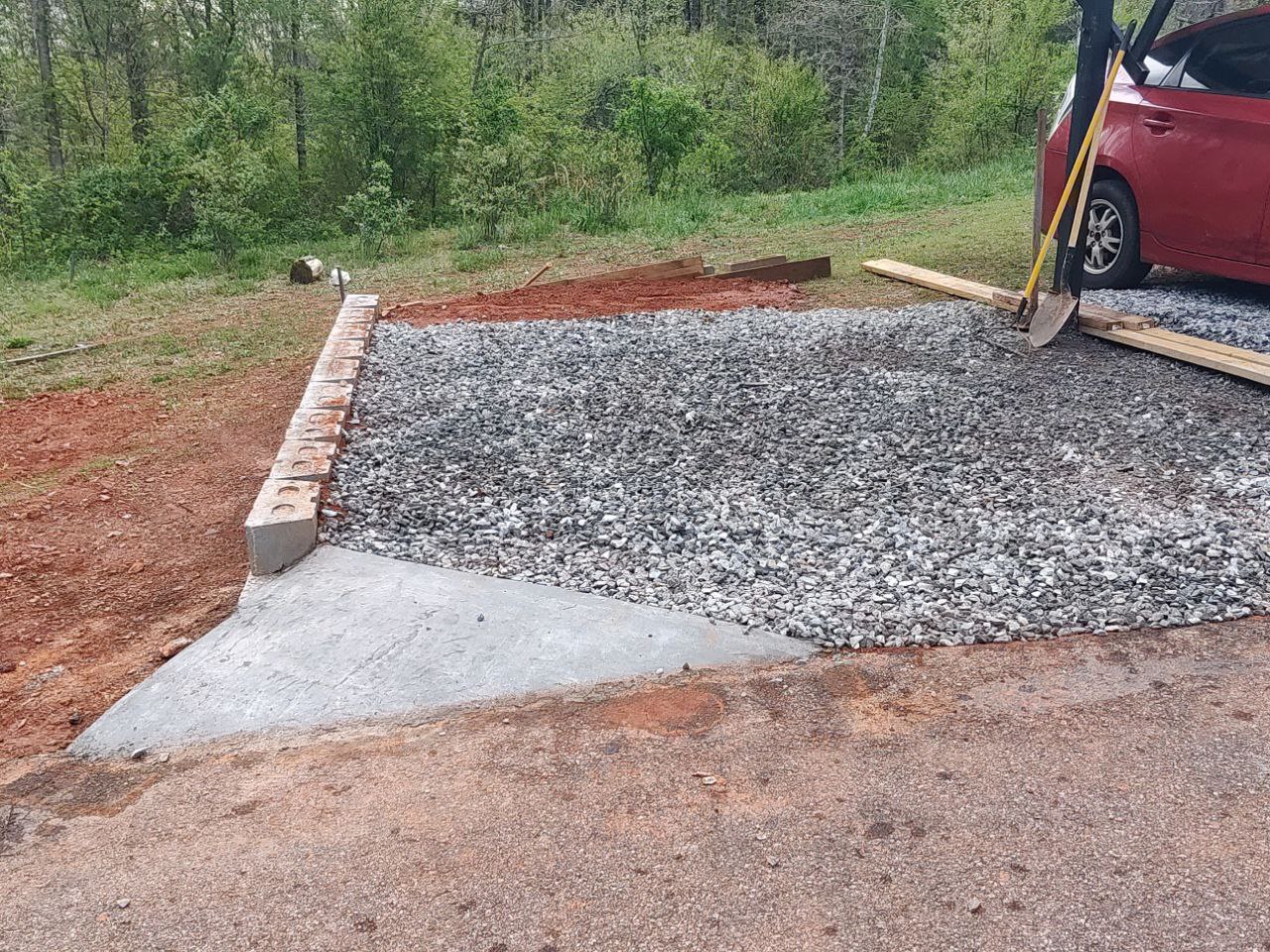

I just want to mention that in may area there are no rules. I do not have to pay money, get approvals and anything like that.
I other parts of USA is different. Usually Democrat states have more rules and more fees, and more taxes. Republican states have less rules. When I bought this land it was all trees and I went to the county to ask them what kind of rules we have here. they asked me for my address and said "NO rules".
They said that I do not even have to pave the driveway if I do not want to. just gravel is fine.

So the carport cannot produce enough even on a mostly sunny day. did not wash clothes or cook much today and still not even enough for the AC and the rest of the house.
So for anybody planning for solar this is almost the max a 5.3kW solar system can produce in a sunny day.
ON the carport I have 12 x 485W panels but only 11 are connected in series. with all 12 panels in series I would have too much voltage in the winter when is cold. I could make 2 series of 6 but I need to run another cable.
So for tomorrow I need to reconnect the panels on the house to bring the battery back up. another 3.1kW.

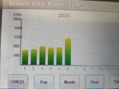

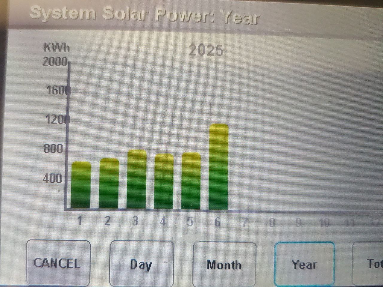

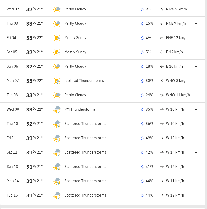

So I made it through June with my personal production. 1200kw use for the whole month.
we had a very hot week at the end.

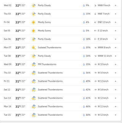

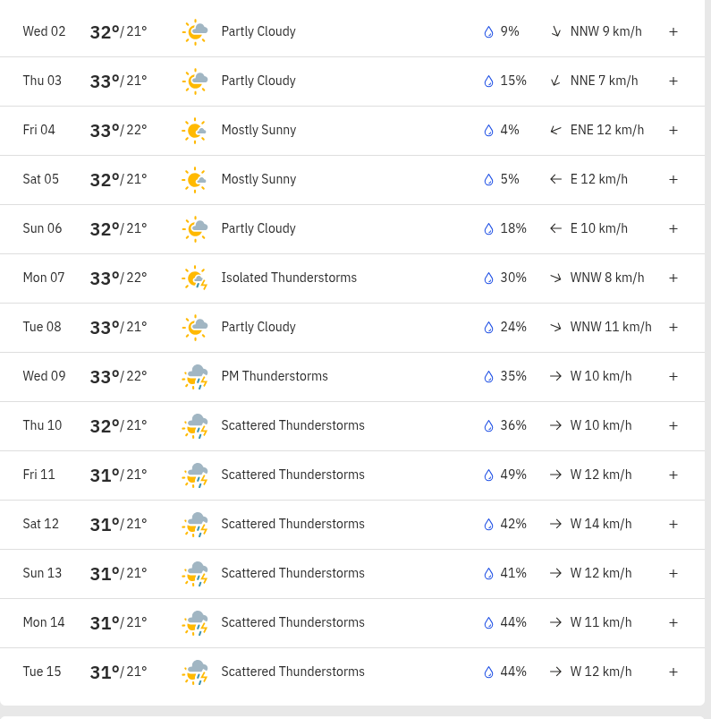

Now in July it looks like all days ave over 31C and in the morning at 7 am the lowest is going to be 21C. that is the reason here on the East coast you cannot live without AC in the summer.
will see if the panels keep UP with July. I also have water batch collector outside that preheats my hot water before it comes in the house. water comes in around 40C in the water heater inside.

Finally end of July and usage was almost 1400kW. this means that only the AC used about 600kW, based on the average of winter and spring months.
About 800kW average. that is no heat at all since I use wood to heat my house.
I can get higher usage only after I start charging the electric car. but for that I need more solar panels. My battery is at 74% right now and the whole month of July was never able to get the battery at 100%. the temperatures are going down a little bit so I will be able to fully charge the batteries next week.

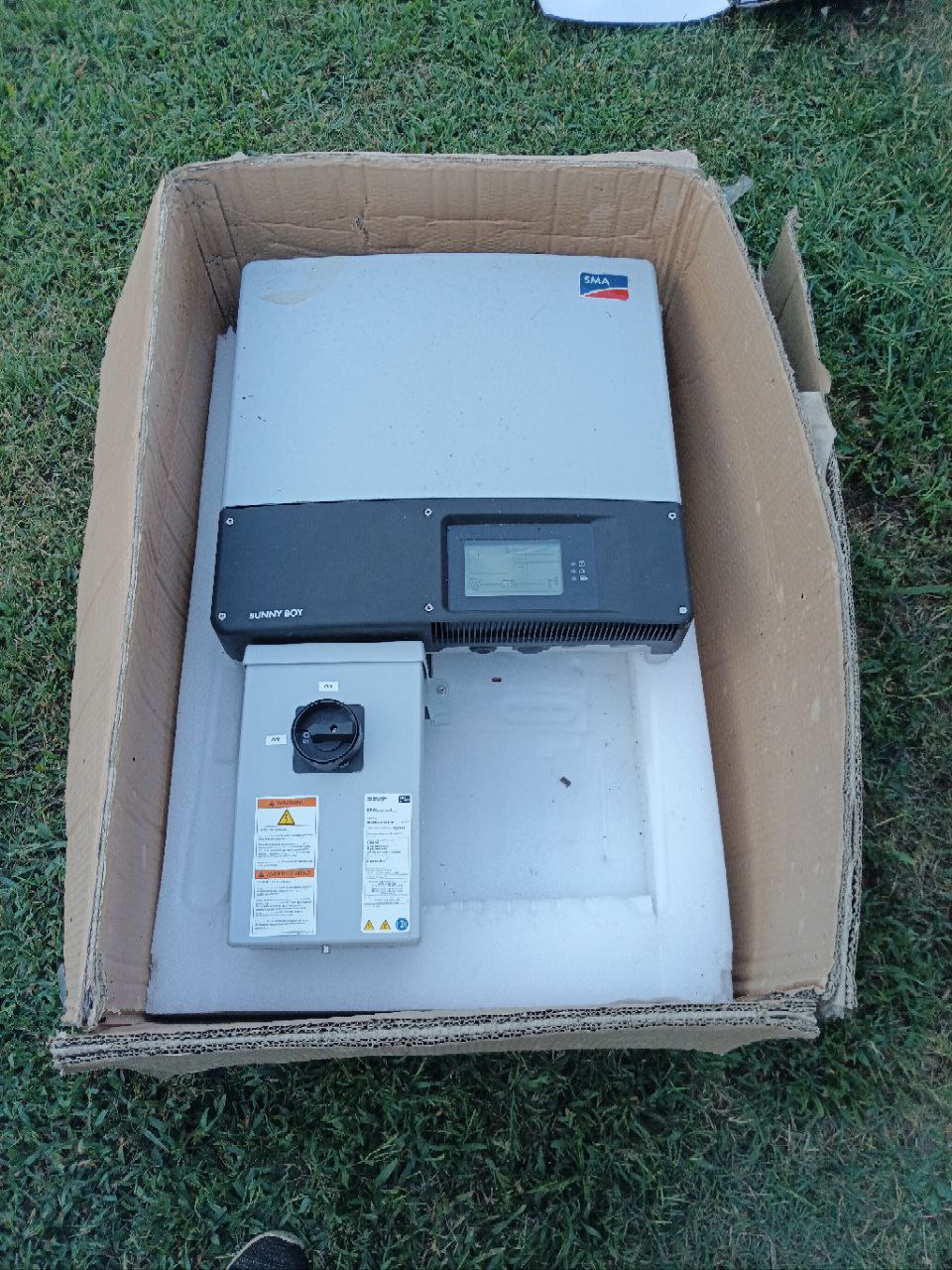

I was cleaning my shed and found the old Grid Tie inverter. If anybody wants to pick it up for free let me know. I am in north Georgia.
4kw and 98% efficient. I only used it I think a little over a year.
SMA 4000 TL-US

Any chance you'd would be willing to ship the inverter if I covered the costs? I'm in central Alabama and could definitely use it for my solar system

I will PM you. I will be in Birmingham, Alabama Sunday. I will PM you the address.

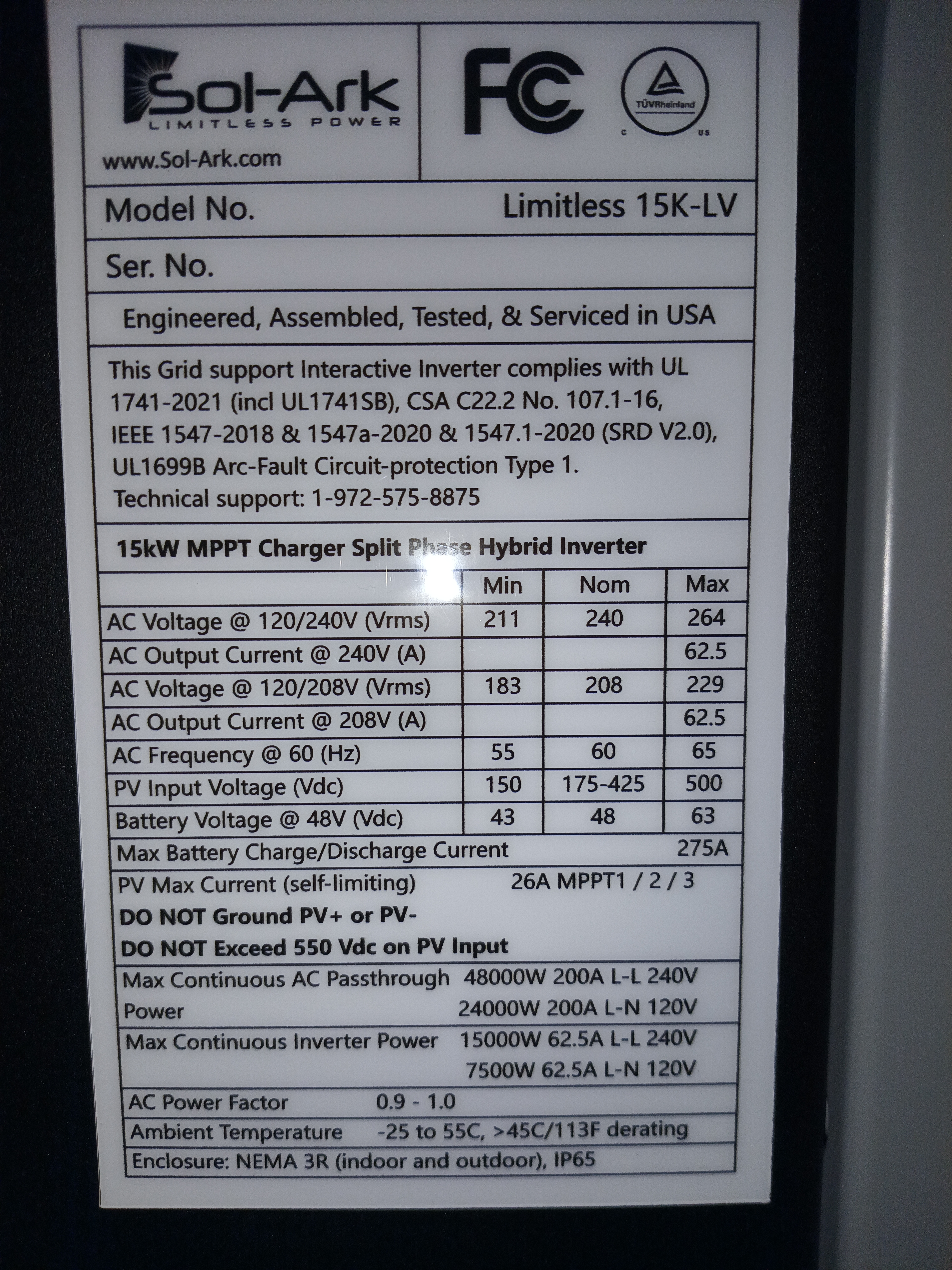

Since this is the last year in USA when I can get the 30% tax rebate I bought the Solar 15k. Found it in sale.
It can take 26amps on each of the 3 MPPTs.

Post by Proton »
I finally had time to install the 15K. Did not connect the Grid back; just the batteries and the solar.
Using 10k right now. Dryer 6 kWh, stove 2.4 kWh, water heater 1.5 kWh, and the rest are small loads.
