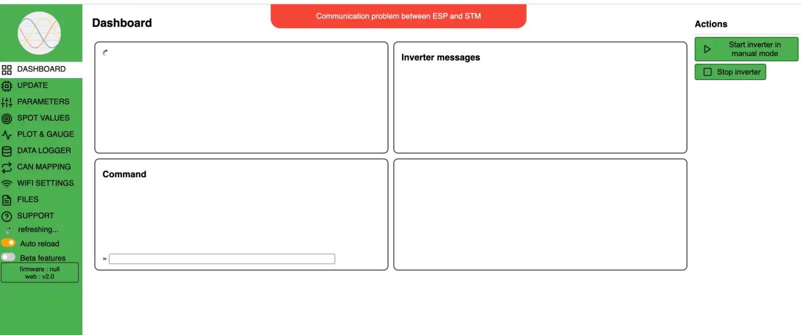

Okay. So I was able to update my wifi card. For anyone curious, use the Arduino IDE 1.xx, not the latest 2.xx version.
Unfortunately, it didn't allow me to configure the charger. This is what the charger website shows now:
I noticed the firmware is "null". Is that the board firmware or the wifi firmware? Is this why there is a Connection problem between ESP and STM?

by Bratitude
spiff wrote: Tue Jun 10, 2025 1:14 am Okay. So I was able to update my wifi card. For anyone curious, use the Arduino IDE 1.xx, not the latest 2.xx version.
What firmware did you load onto the board?
Johu took over software dev, and his version is the one that works with the web interface

So Johu was kind enough to confirm the STM32 code was https://github.com/jsphuebner/stm32-teslacharger.
I downloaded and compiled the code and tried to upload using the wifi interface but unfortunately no luck.
Looks like I'm now facing the "Communication problem. between ESP and STM" issue. The wifi board is directly connected to the STM board.
Anyone have any other troubleshooting tips?

Posted: Sat Jun 21, 2025 12:49 pm
by Bratitude
did you upload the bootloader first? Then the charger firmware?

Looks like your esp is sorted.
when programming an stm with any of the oi firmware, you need to upload the bootloader first. Then the firmware.
You know it’s successful when the acty led is blinking

It’s called a bootloader… it’s just used to for starting up the stm to run what ever firmware is loaded. In this case, the Tesla charger firmware.
Loading other firmware, such as stm32sine, which is designed for different hardware, will do nothing.
Load the generic bootloader, then the Tesla charger firmware
OTA (over the air upgrade)
The firmware is linked to leave the 4 kb of flash unused. Those 4 kb are reserved for the bootloader that you can find here: https://github.com/jsphuebner/tumanako- ... bootloader When flashing your device for the first time you must first flash that bootloader. After that you can use the ESP8266 module and its web interface to upload your actual application firmware. The web interface is here: https://github.com/jsphuebner/esp8266-web-interface
Bootloader .bin/.hex You need to use .hex with ST-link
https://github.com/jsphuebner/tumanako- ... s/tag/v5.2
