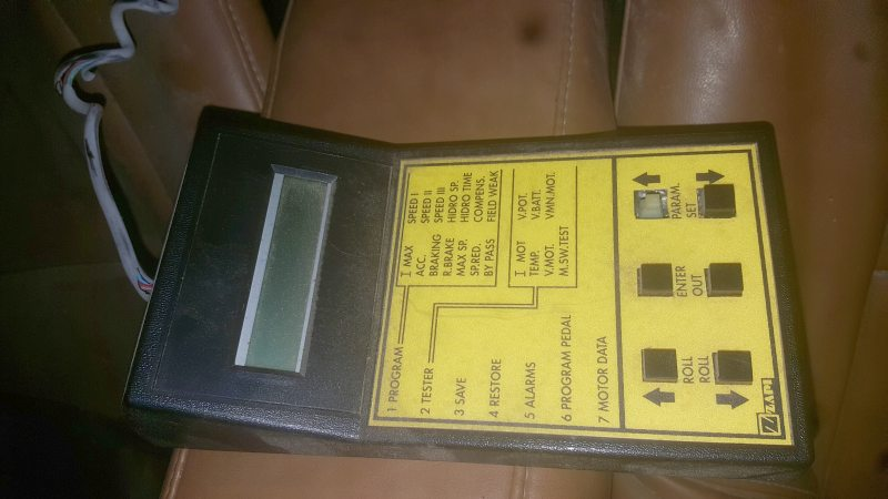

- Got the trunk/engine compartment open. Inside is an Italian ZAPI speed controller. Apparently, the kit was sold with an EV1 controller, documented, then the documentation regularly refers to how it doesn't have this controller, it uses a different one more suited to passenger car operation. Not sure which this one had originally, but the second owner replaced it in 1995 with the ZAPI, which was I guess an 800 amp controller? More on that later, it blew up constantly, like, weekly, and to get service on it the previous owner hand-wrote and mailed letters to Italy to try to get it resolved. It's still what's in there.
- The ZAPI has a fantastic 1980s remote... programmer? Look at this time capsule. OpenInverter ESP8266 interface eat your heart out. It's permanently attached, the wires get pinched by the trunk seam, the hatch seam, and then a long coiled phone cord-like girls chewing gum loudly and drowning in hairspray would twirl around their fingers. Why does it have a 15 foot long cord? Are you supposed to operate this while driving?:
