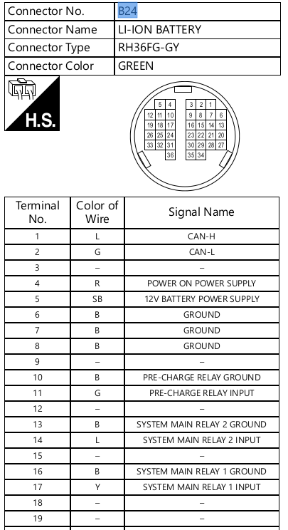

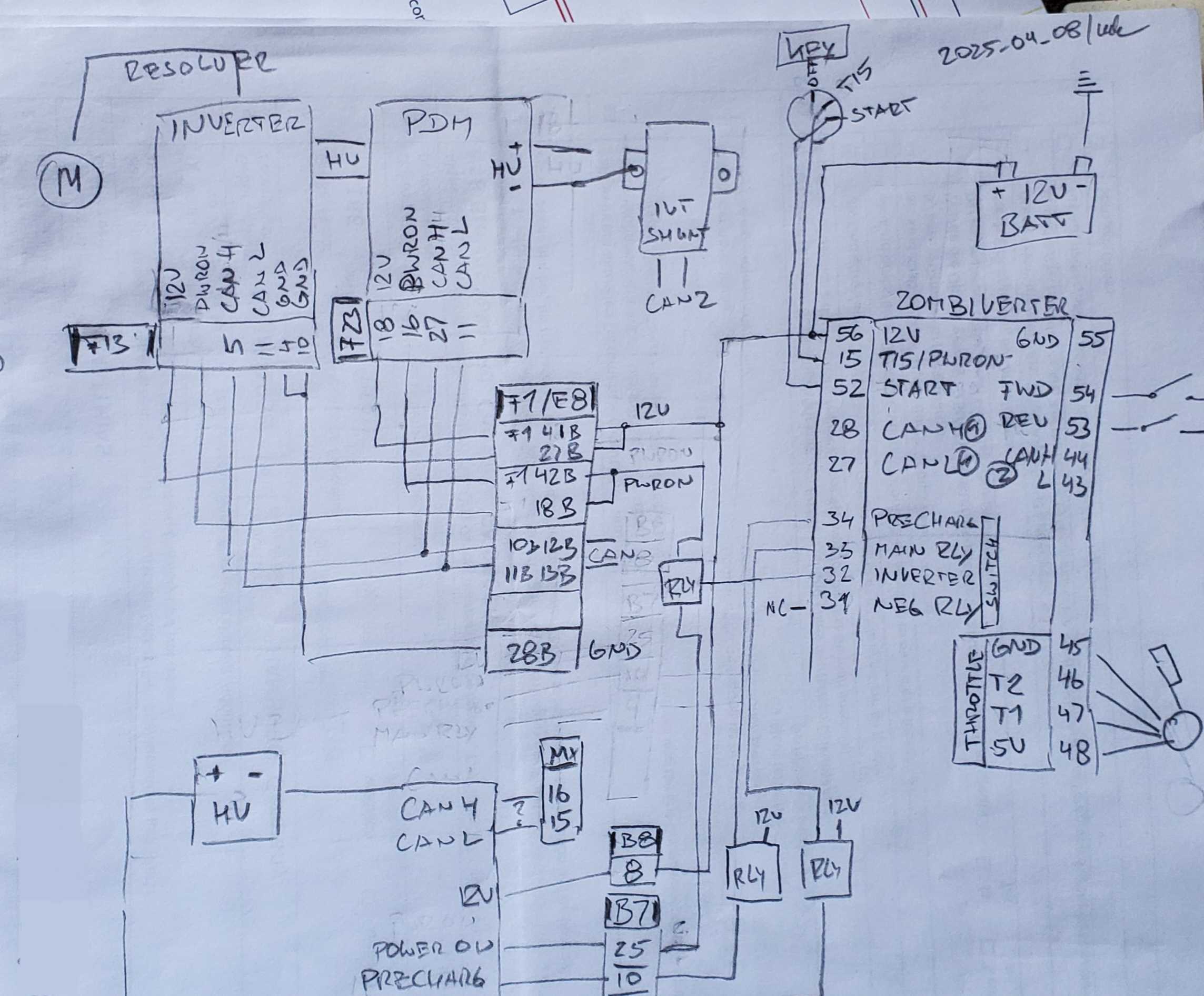

Re: leaf 2020 oem vcu to zombie conversion
Thanks tom91 for your response, I really appreciate it, and it is really helpful to me.
Sorry for not following the rules, I totally get your point. I am new on this block and promise to improve and follow up with what is needed to describe my setup. will try and do a PARAM dump tonight.
There is a big possibility that I mis-wired something. Especially since I do (as of now) not have direct access to the connectors (PDM, inverter, batterie). and have to splice into the existing car harness.
I try to do my due-diligence as much as possible, but it is a big learning curve.
- have VW/Audi throttle setup working.
- No brake signal setup yet, from looking at this diagram Leaf stack with zombiverter. I got the impression it might not be needed for the inital setup. though i can easily add brakes signal input
- I do not have a NEG contactor relay setup. I was wondering how that works. I could not identify any NEG relay input on the HV batterie connector.
it only provides signaling for PRE-charge, main RELAY and MAIN2 relay.
I was wondering how zombieVCU works that out with the HV batterie (CAN msg?). Did I make a mistake here? Is MAIN2 relay input the NEG contactor?
I was under the impression (looking at leaf 2021 schematics pdf), that the MAIN2 relay is for the heater on/off (connected to the HV batterie).
schematic of my current setup
the schematic does not show the main relay connection to HV batterie.
On my current setup I removed the ISA shunt and moved to a "NONE" shunt configuration.

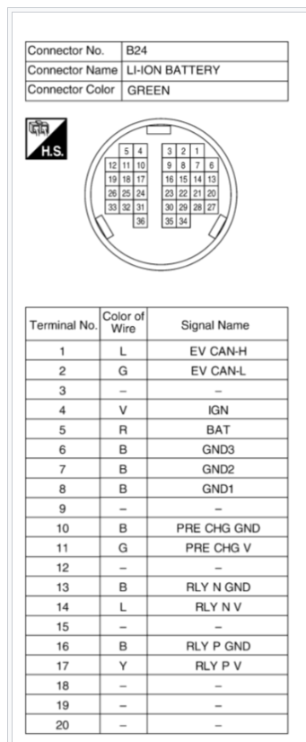

@tom91
thanks for raising that question about the negative Contactor.
I discovered that I made a mistake.
on the openinverter zombieverter leaf link i found a picture with updated description of the B24 LIIOn control connector
this states tha MAIN2 relay (pin13,14) is the NEGATIVE contactor. I wished the Nissan's Leaf schematic would have been more clear on that. I was drawing the wrong conclusion.
But thanks again for pointing me in the right direction
Rewired my setup and included the control for the negative contactor build into the Leaf HV battery. Removed the ISA shunt to measure the HV voltage and re-configured ZombieVerter to use the can message from the x1DA from the inverter. Thanks to Damien and CO for making the feature available. Really simplifies my setup.
Here a simple schematic illustrating how i wired everything up, by using the internal leaf wiring and connectors.
My current zombieverter configuration params.json
