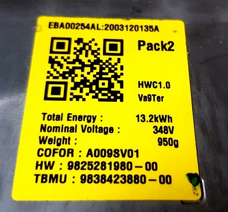

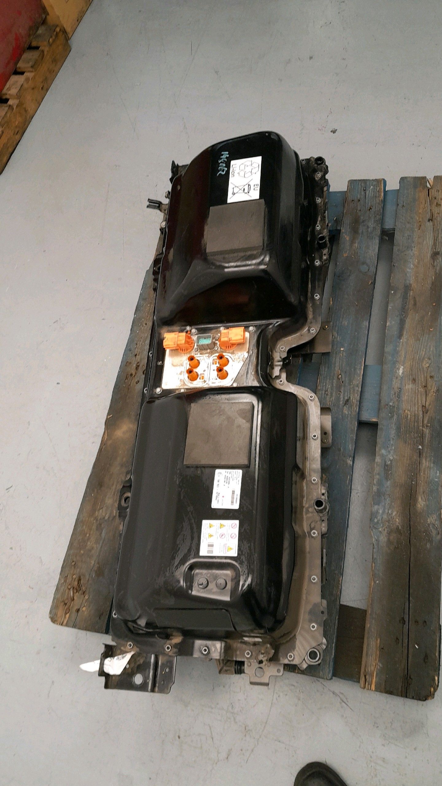

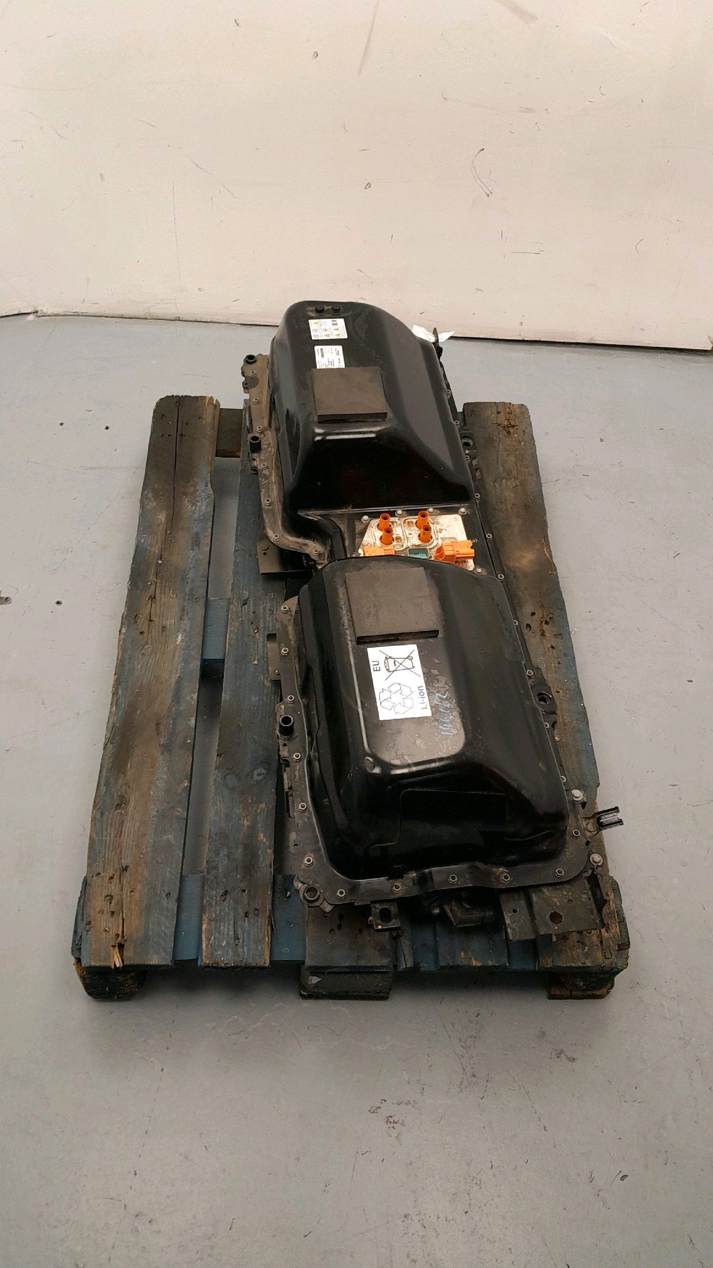

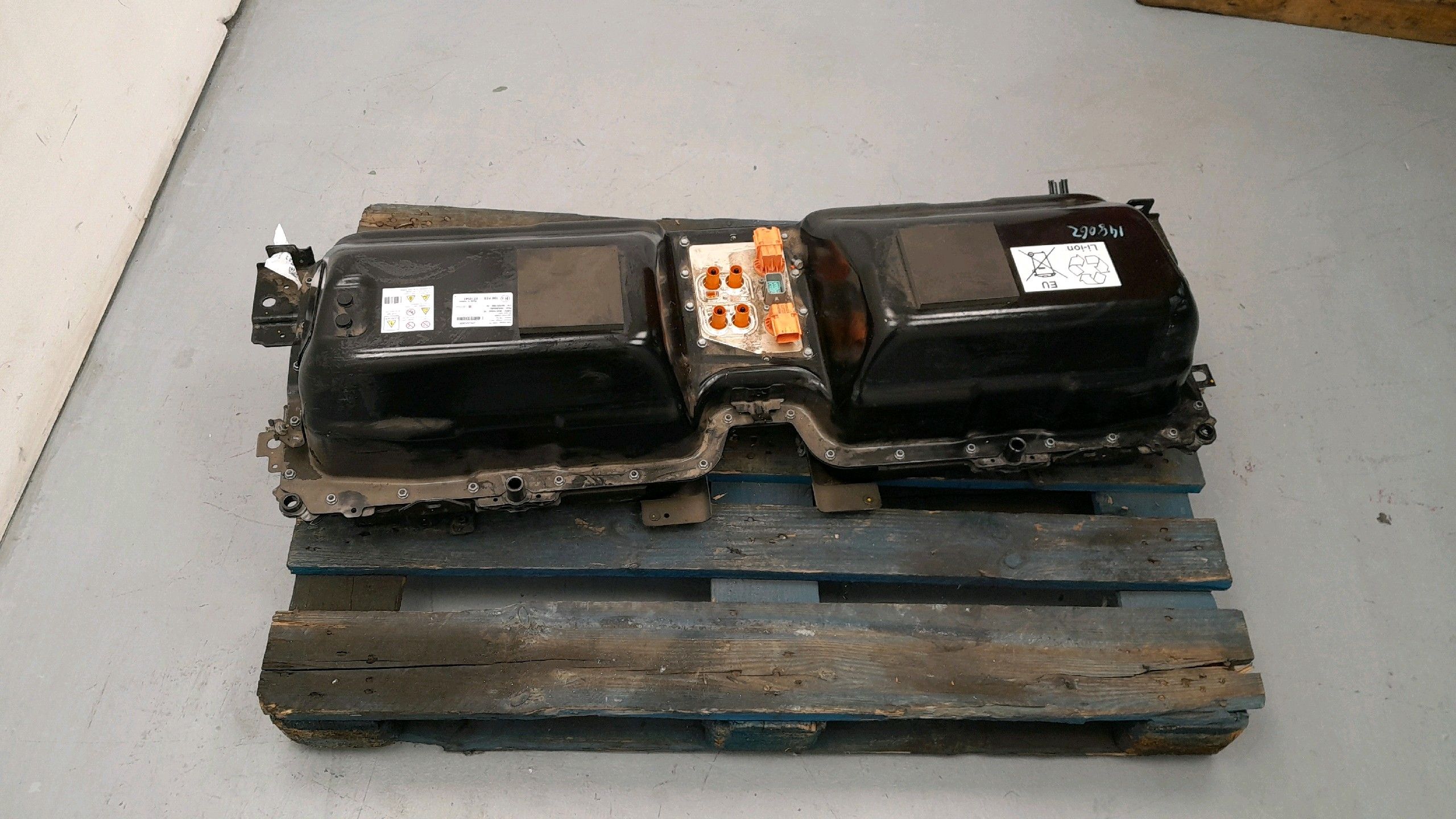

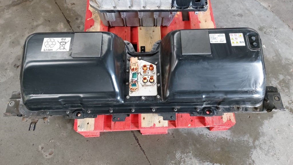

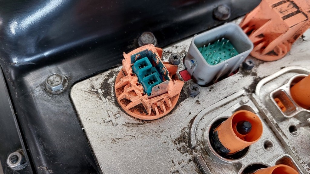

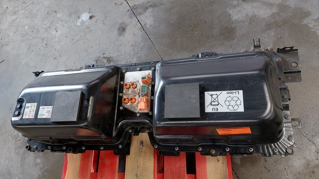

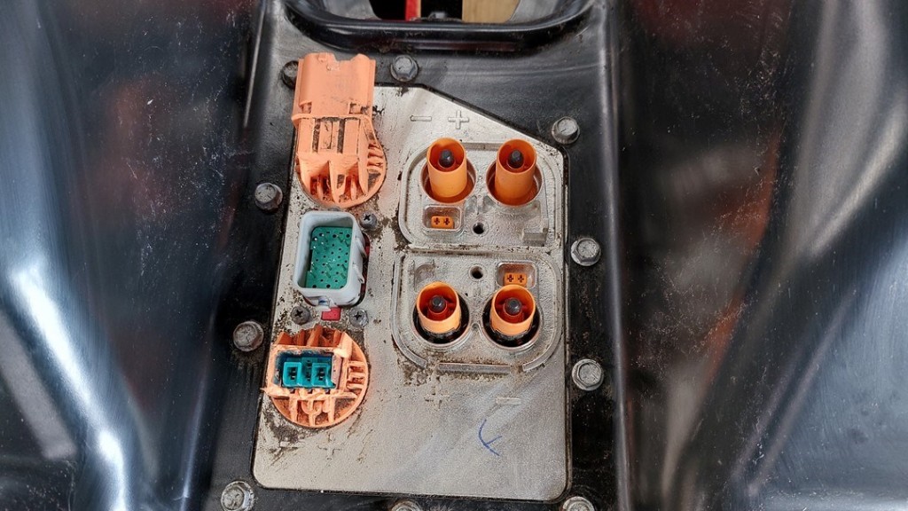

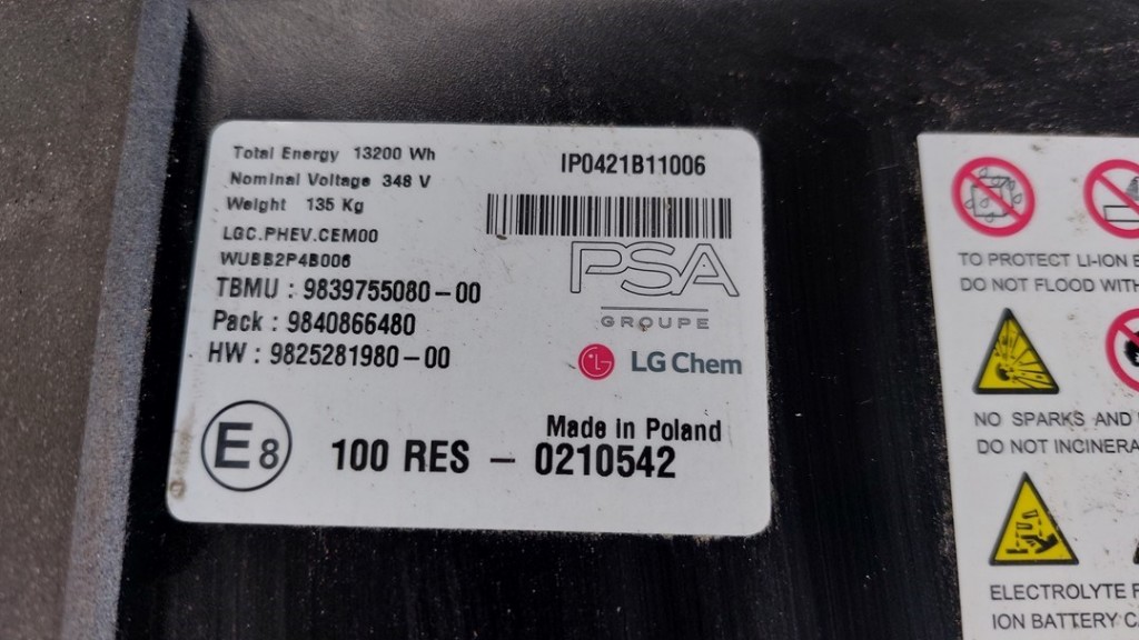

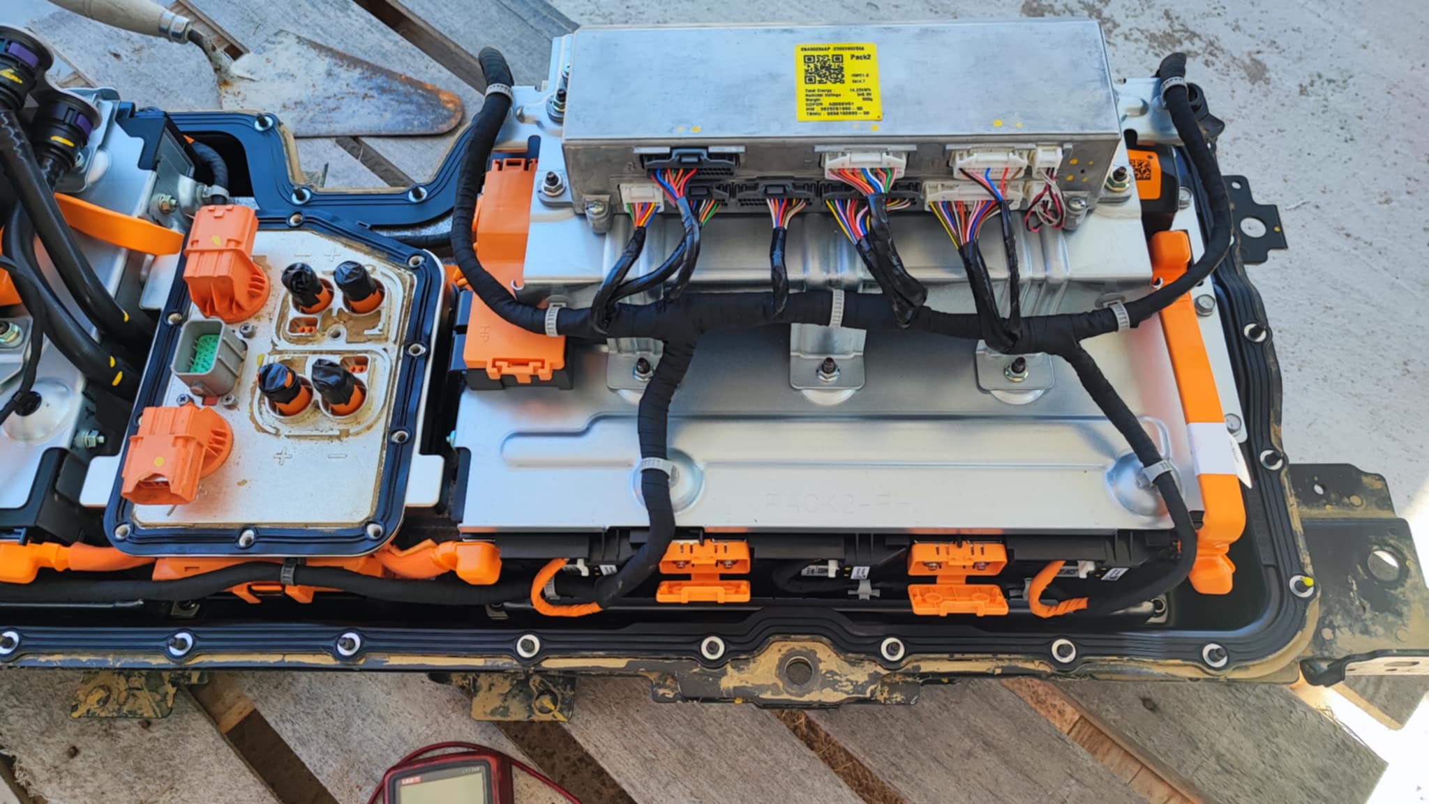

Has anyone opened one of those batteries?
Prices are starting to get interesting but i wonder how hard the cells are to reconfigure.
9840866480
9839755080
9825281980
9837281580
9838612580
9838423880
a009sv01
135kg
348v
https://public.servicebox-parts.com/AP/ ... ection.pdf
Similar to the ds9 from ev clinic
https://evclinic.eu/2024/01/03/ds9-plug ... nro-style/

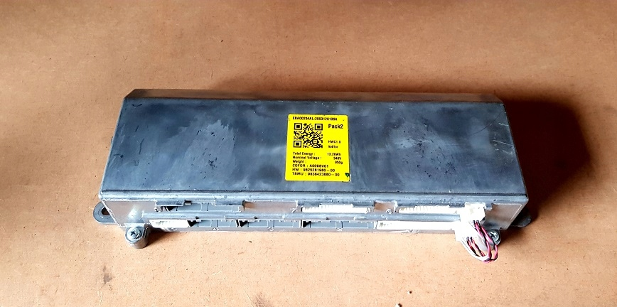

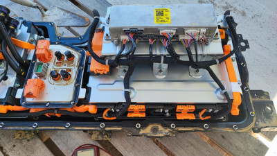

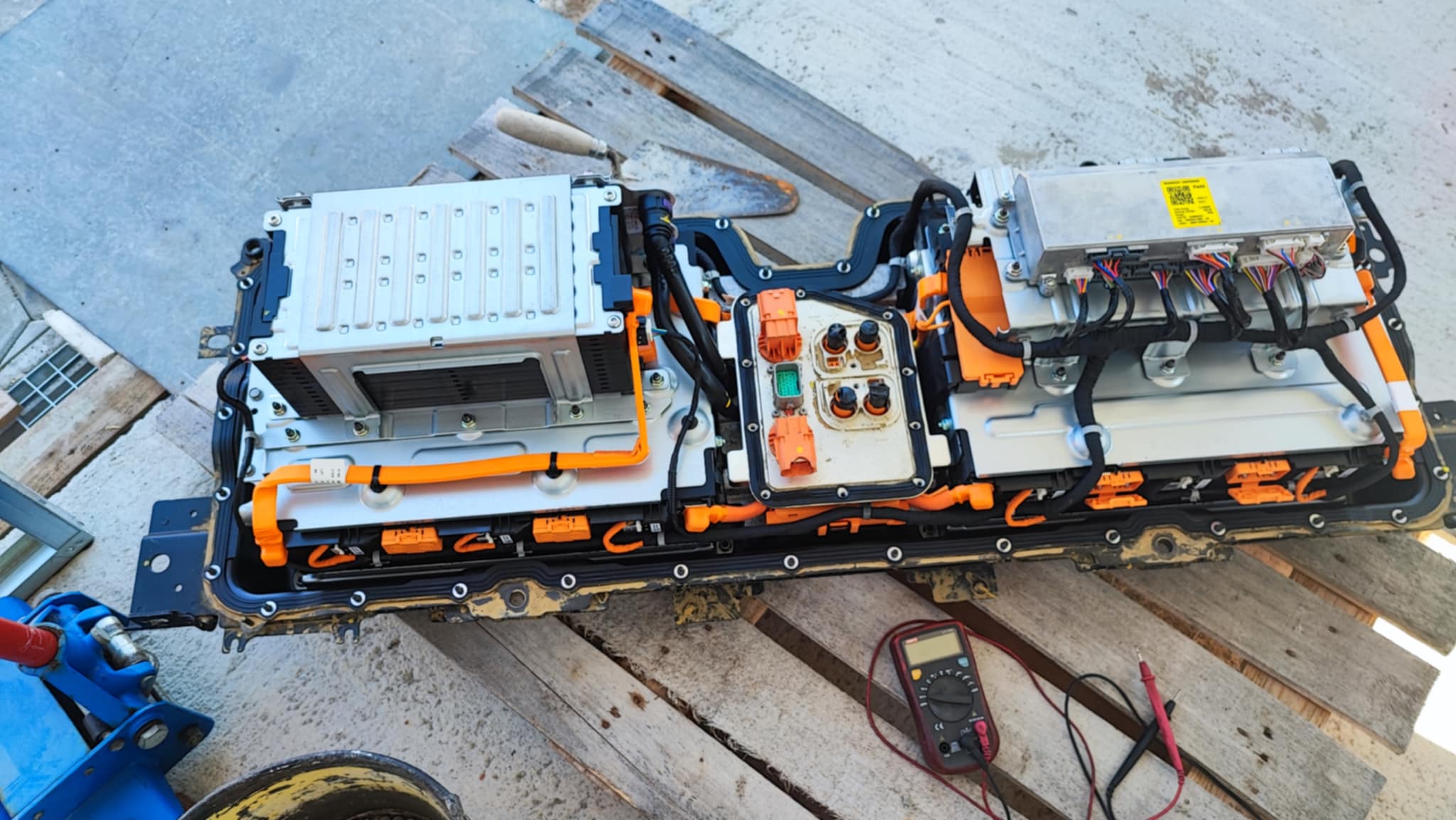

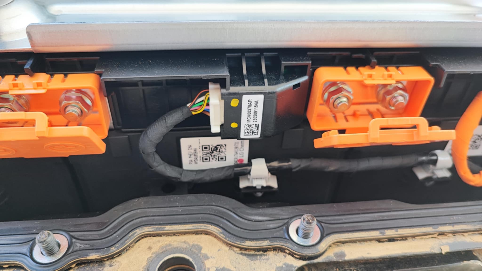

6 x 14S + 1 x 12S
Posts: 2963
Has thanked: 330 times
Been thanked: 848 times
Re: PHEV Peugeot 3008/Citroen C5/DS 7/Opel Grandland 13200Wh battery pack (2016-2023)
One large central BMS it seems too.
Does it also contain all HV fusing since it got so many different HV connectors?
