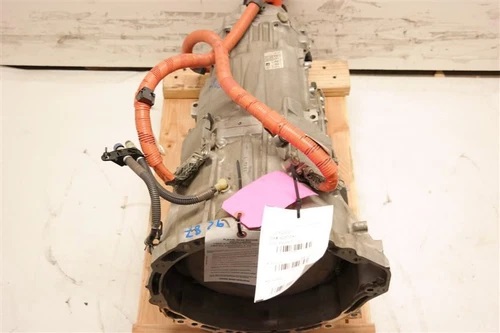

Re: I just bought a 4th Gen Lexus GS450h Powertrain. - Now What?
Posted: Wed Mar 12, 2025 2:23 pm
by Gregski
transmission listing as seen on eBay
Orange Cables - ✔
Electric Oil Pump - ✔

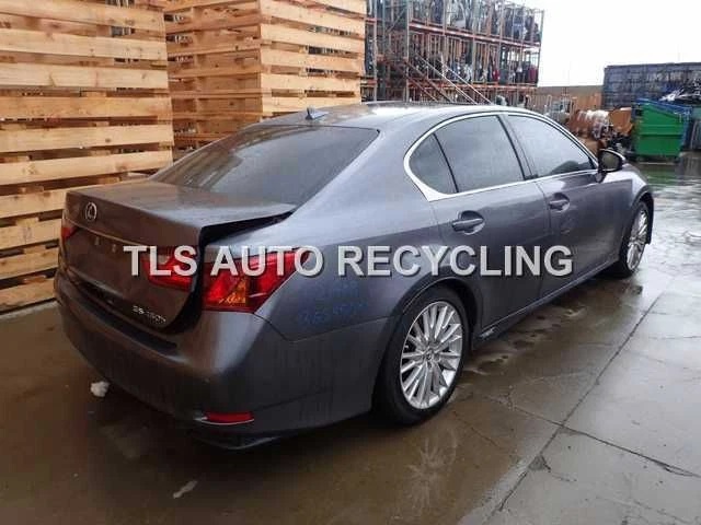

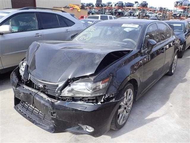

It's always nice to see the vehicle it came out of, and seeing it being immobilized because it was wrecked, otherwise it may have mechanical issues

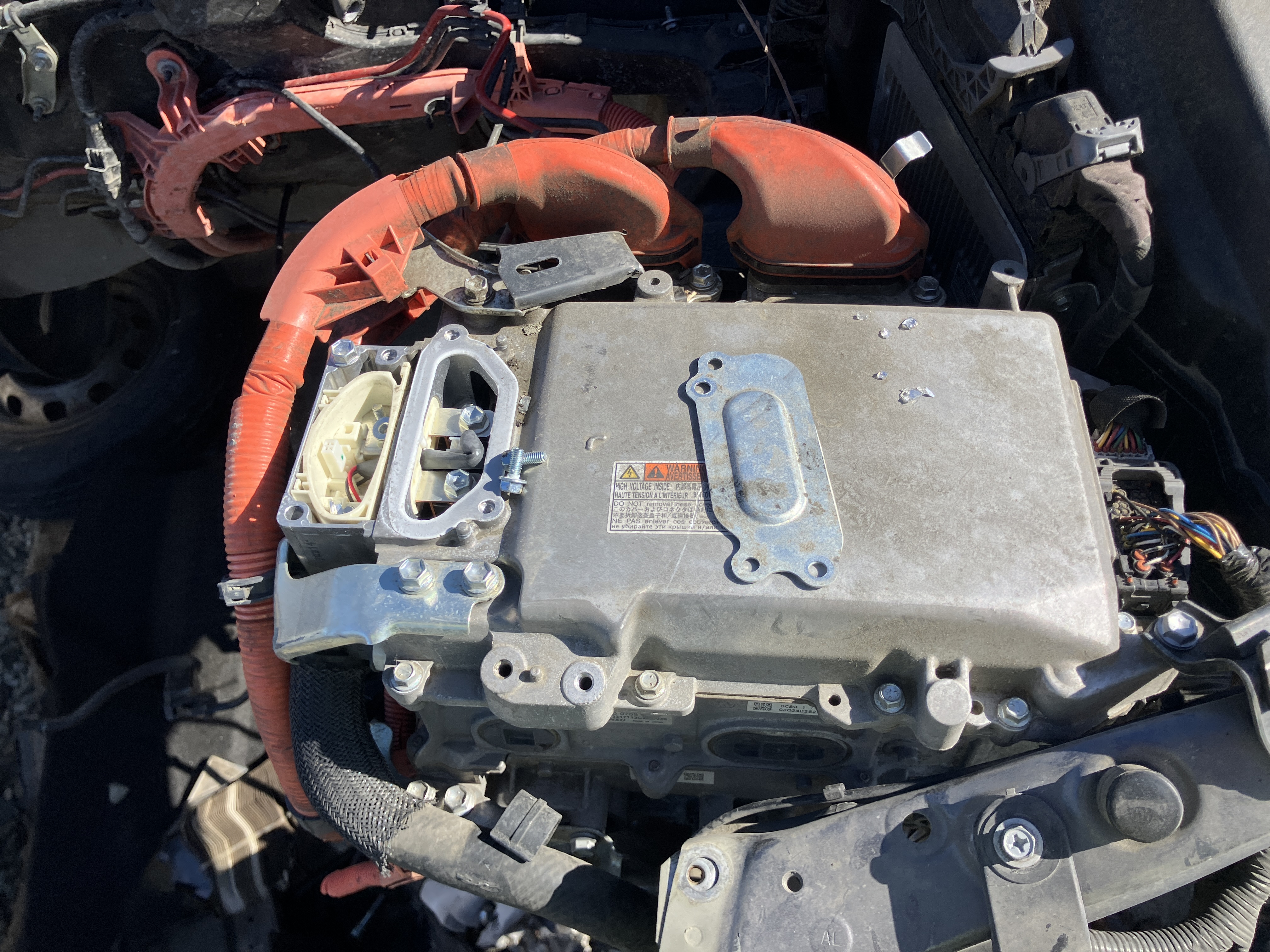

Posted: Wed Mar 12, 2025 3:58 pm
by Gregski

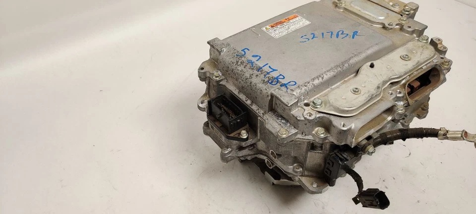

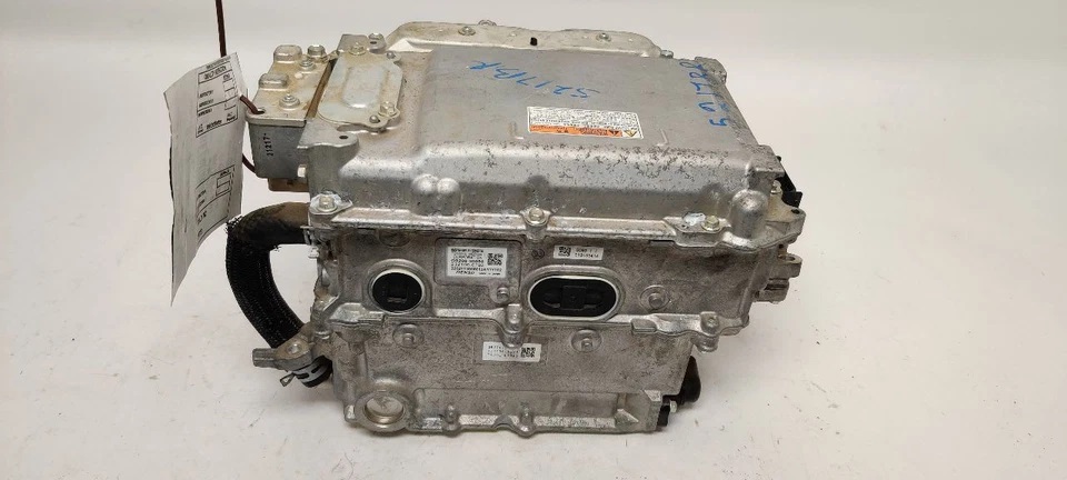

inverter listing as seen on eBay

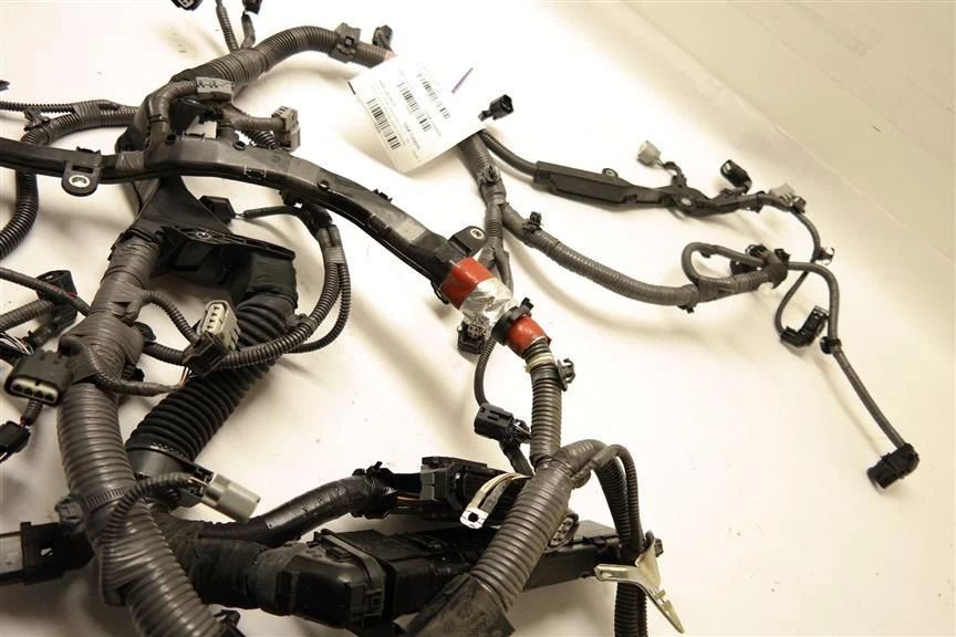

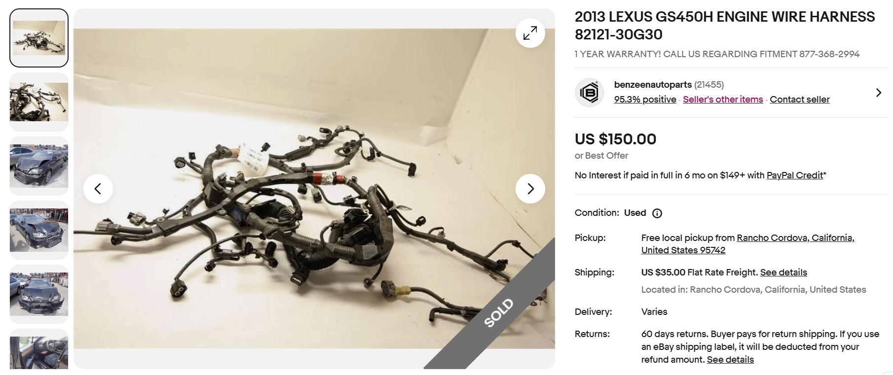

transmission wire harness as seen on eBay
4th Gen transmission wire harness Part # 82121-30G30 is for 2013-2016 this one has the resolver cables but not the inverter connector/plug

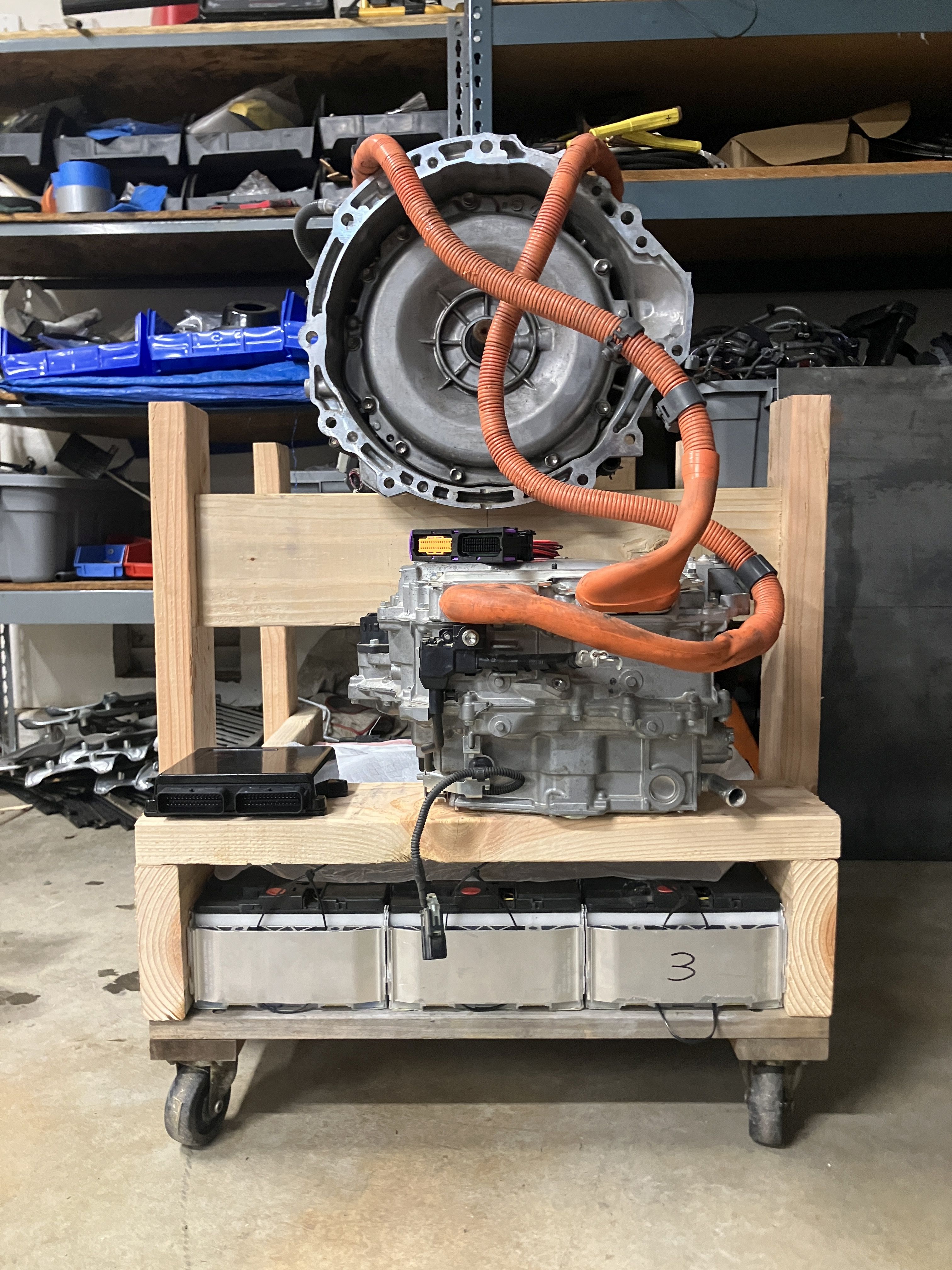

Posted: Sat Mar 15, 2025 1:07 am
by Gregski
and so it begins...

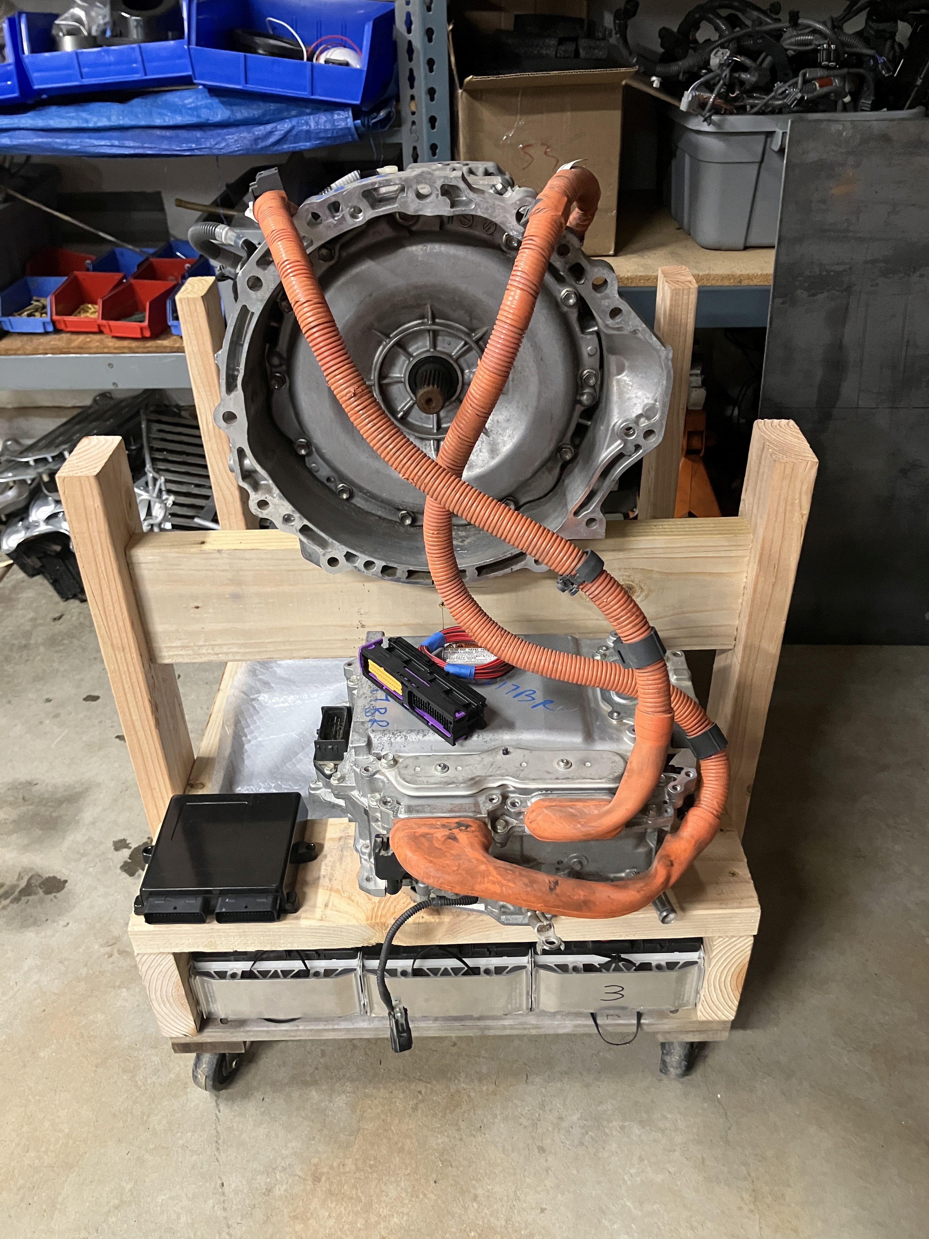

Posted: Sat Apr 05, 2025 3:44 am
by Gregski
stuffs about to get real ! Vroom, Vroom... [or somethin' like that]

by Gregski
scored an inverter and wire harness from the Fourth Generation 2013 Toyota Avalon Hybrid (model years: 2013-18) which looks awfully the sameish as the Lexus one, let's hope the inverter plug is interchangeable
looks like somebody already snagged the fuselator
here I am attempting to remove the already severed orange high voltage motor cables (but I end up giving up on removing them as it appears 6 bolts need to be undone and I have a strict 3 bolts or less per component policy, ha ha )
Posted: Fri May 23, 2025 3:13 pm
by Gregski
and here she is all extracted an hour and fifteen minutes later
snagged all the wire harnai
note the handsum carrying handle (hey it's the pants or the inverter, you decide)
I can take apart 92% of all imports with what's in that Pick N Pull tool bag!

and back in the lair
Lexus gearbox tethered to the Lexus inverter, and the Toyota inverter on the floor

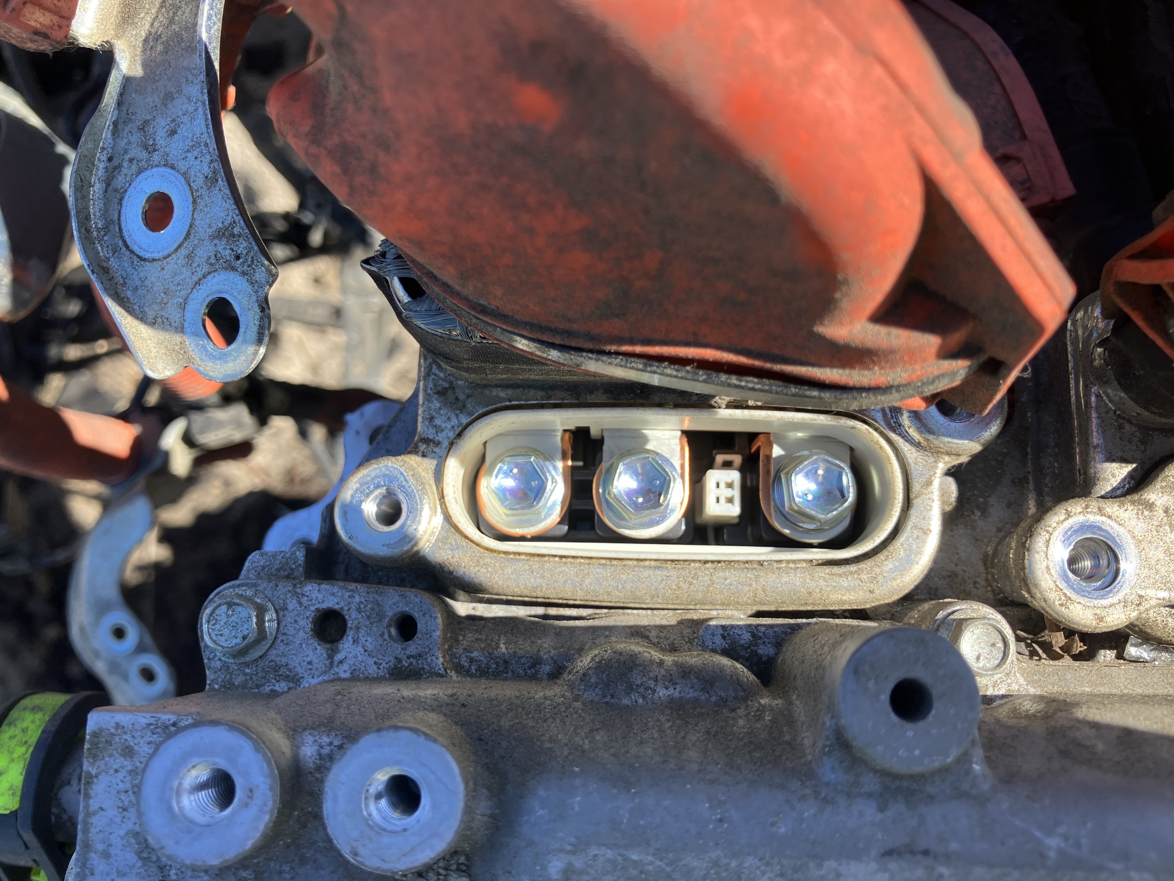

Posted: Mon Jun 16, 2025 5:46 pm
by Gregski

and immediately after allowing it to sit on my garage floor for 6 months I decided to swap it
so out with the circumcised one!
