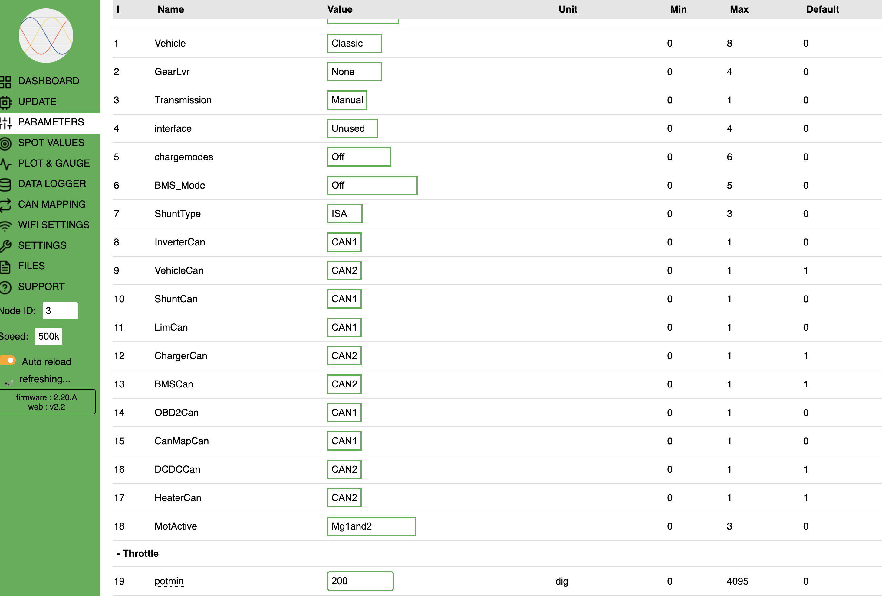

Hello,
Starting a new thread because my earlier questions were around the Olimex interface, which I have given up on.
I am posting to find out if there are any software configurations required to get the ESP32 web interface board communicating with the Zombieverter.
After my Zombieverter Olimex stopped broadcasting a WiFi SSID, I decided to get an ESP32 CAN Web Interface from the Openinverter store. It arrived this week and I soldered on the headers and connected GNB, 12V, CANH and CANL and powered up the Zombie and the ESP32 board.
I can join the SSID and navigate to the interface, but I am getting the dreaded "Communication problem between ESP and STM" banner on the top.
The Zombieverter power led is on and the activity led is flashing rapidly. Incidentally, the Olimex red led is on but the SSID is nowhere to be found.
When I turn on my ignition and press start, my precharge procedure initiates and completes. This suggests to me that the CAN network that the Zombieverter, ESP32 board and IVT-S shunt are on is working. I am assuming the ESP32 board does not have a terminating resistor enabled by default - the Zombie and IVT shunt have a resistor.
https://openinverter.org/shop/index.php ... duct_id=78
So, my question - is there anything I need to do, software-wise, to get the ESP32 showing me Zombieverter spot values and parameters?
I see a Node ID field - clicking up and down on that does nothing.
I assume 500kb speed is fine.
Do I need to do anything in the CAN mappings section?
Anything else I have not done?

The ESP32 module uses SDO communication. On ZombieVerter that is only available on CAN1. Node Id is 3
I'm assuming you've got recent firmware on Zombie. Like 2.20

I have managed to successfully connect the ESP32 to the ZombieVerter. In the end, I changed nothing from my last post. For clarity, here is the configuration that works for ZombieVerter V2.20. A lot of this is documented in many places, but I'm repeating it here anyway.
1. Connect the ESP32 to CAN1 of the ZombieVerter - that is the CAN lines closest to the 12v/GND pins on the ZombieVerter pinout.
2. Make sure you have the right resistor termination. That is, when powered down, the resistance between CANH and CANL must be approximately 60 ohm. If it's 120 ohm, you only have one terminating resistor, if it is under 60, then you have too many.
3. Power to the Zombie and the ESP32 are the same 12v lines.
4. The WIFI network will be something like ESP_xxxx, no password
5. The web interface is 192.168.4.1
6. The only things I needed to set were Node ID 3. Speed is 500k, which is the default. I select these values by pressing the up button a few times in the box and then hitting 'Enter' for good measure.
How did I connect?
Well, firstly, try different browsers. I had no luck with Safari - and even the inbuilt Zombie web interface is flaky on Safari. Chrome worked better. I did not test Firefox.
Secondly, I think perhaps there's a bit of a startup issue. I powered up and joined the wifi network and went to the web interface in Chrome, and initially had not connection. I waited a bit, toggled the auto reload a few times, refreshed a couple of times and voila! It worked. SO I think patience is sometimes a virtue.
Here is a screenshot of the CAN parameters that I have right now, in case you are wondering.

Was just going to reply to your questions :) Will anyway
Scrappyjoe wrote: Thu Mar 13, 2025 6:42 am Perhaps my CAN network topology is messed up - although the Zombie reads shunt values fine
Probably no
Scrappyjoe wrote: Thu Mar 13, 2025 6:42 am Perhaps CAN1 in the interface is not CAN1 as described by johu above?
Maybe.. just try the other
Scrappyjoe wrote: Thu Mar 13, 2025 6:42 am Perhaps I need to somehow enable SDO comms by setting a parameter on the Zombieverter?
No
Scrappyjoe wrote: Thu Mar 13, 2025 6:42 am Perhaps there is something I need to set up in the ESP over and above setting Node ID 3 and speed 500k?
No
